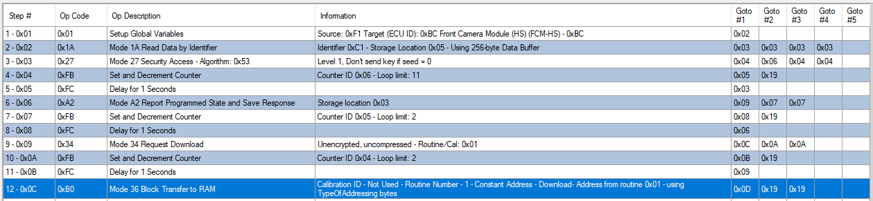

  • Soo i got it working after hours of searching and testing. The culprit was really the VXDiag with its buffer size or timing error. I change the max Buffer and Programmed.  ProgramLog Ca

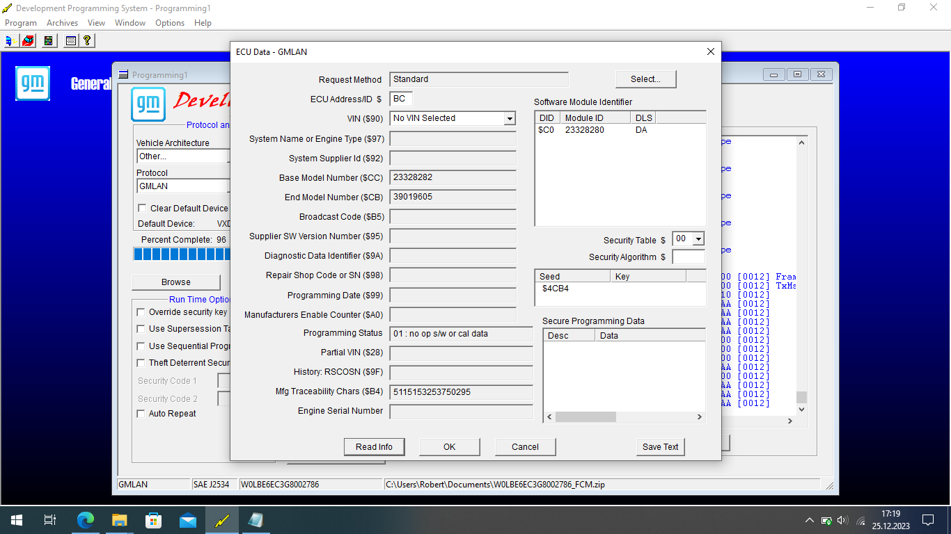

Does anyone know what went wrong?ProgramLog K109 fail.TxtK109.zip
Before:
After:
Maybe incorrect calibrations. There are modules that, if they do not accept the calibrations, remain in that state 01. You can load it again.
I think you have a problem with packaging.

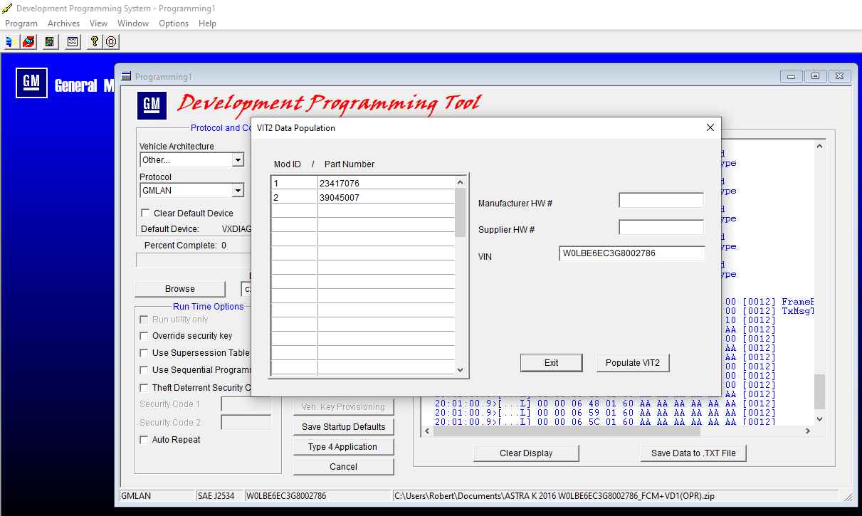

manually update VIT2
Do you mean that.
What do I have to enter in Man-HW / Sup-HW, or do you have to enter anything at all?

Do you mean that.
yes, u should fill all relative data. As well need all calibration to be in correct order.
@codebuilderdue not populated VIT2 wiht correct data, him module now is "empty". I do this mistake before, until get to learn how should be done. Few "bricked" modules and couple days/nights reading and testing.

I try the VIT2 and see if it works.

I tried but Still fails😢ProgramLog camrea fail vit 2.Txt
ProgramLog Camera Success.Txt

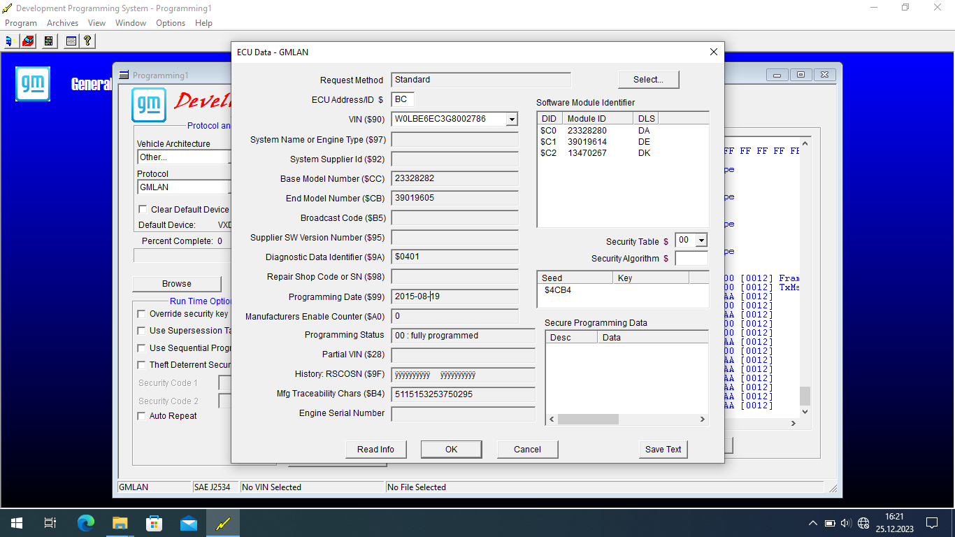

Still a small thing there is no Seed anymore. Just $0000. Is that a Problem?
GCI_Log Camera Success.Txt
The Seed was before $4CB4
