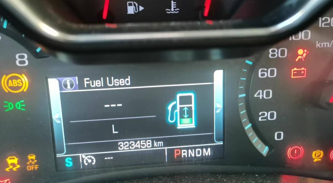

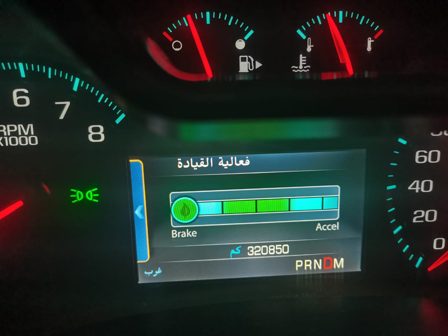

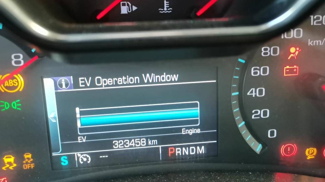

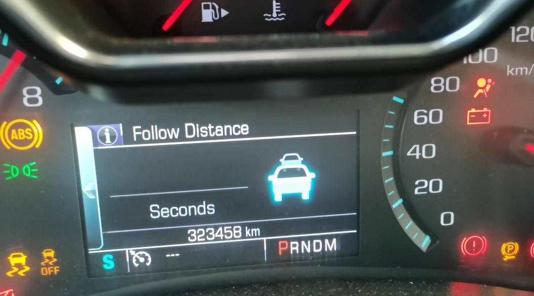

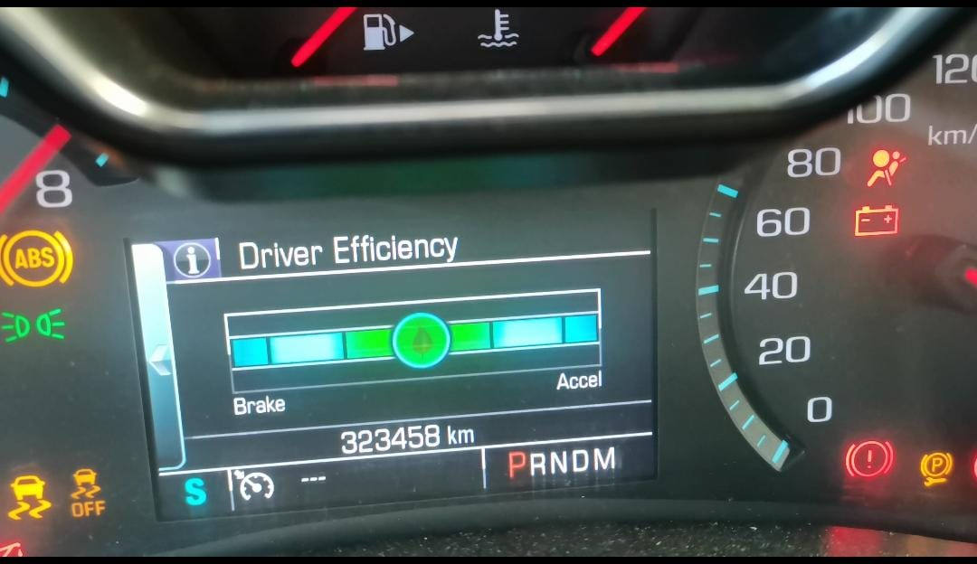

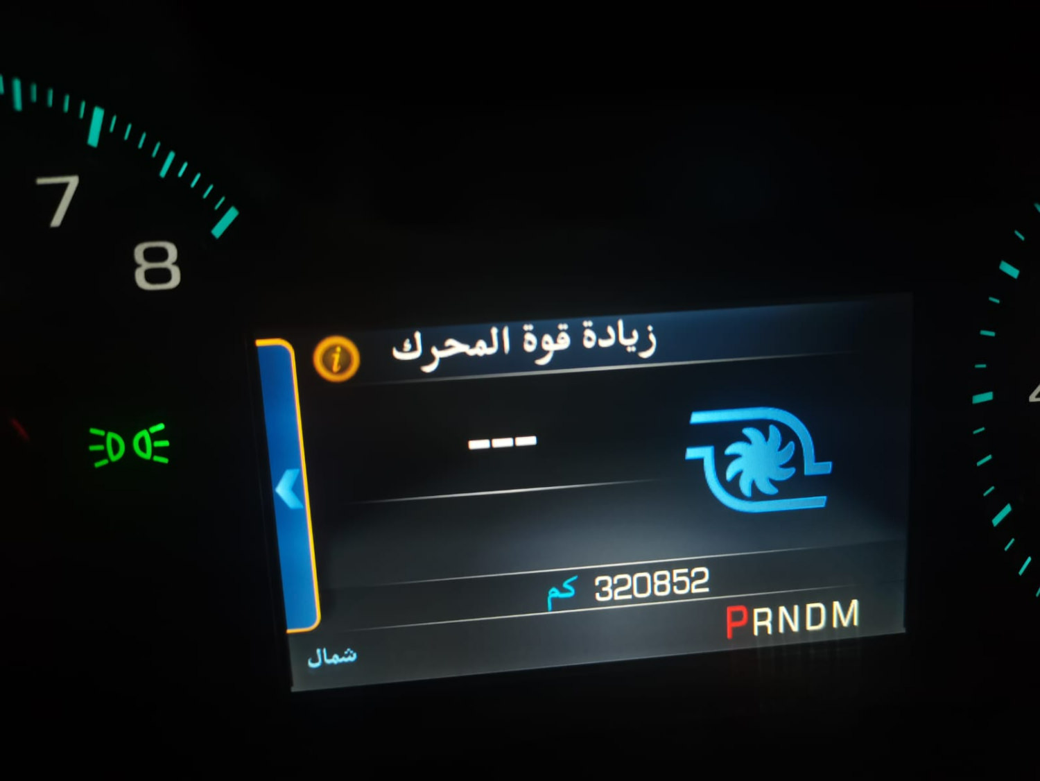

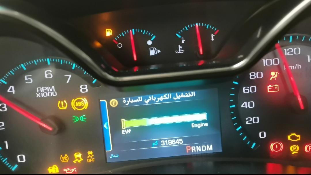

Weird new options in the IPC after SPS2 new calibration
I've seen some Impala owners add a "Transmission Temp" and "Road Speed Sign" option in the IPC through a shop that does "some programming" They say
I thought It was just a new calibration, So I used SPS2 to get the latest calibrations installed but I didn't get these options
but I realized there were new options showing for like 3 seconds after the car started when I scrolled between the options
but then disappear
if I selected any of them before it disappeared it doesn't change the value, like it's frozen, but if I changed the option it disappear again, not sure why it's there in the first place and why I got it in the calibration
some of them don't make any sense in my car, like "EV Charging"
*Sorry the images were in Arabic at the time*
