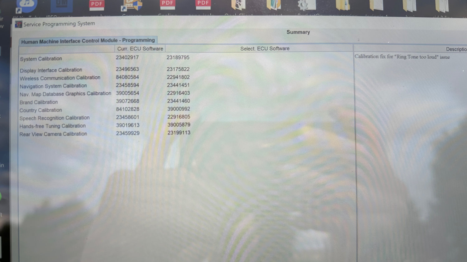

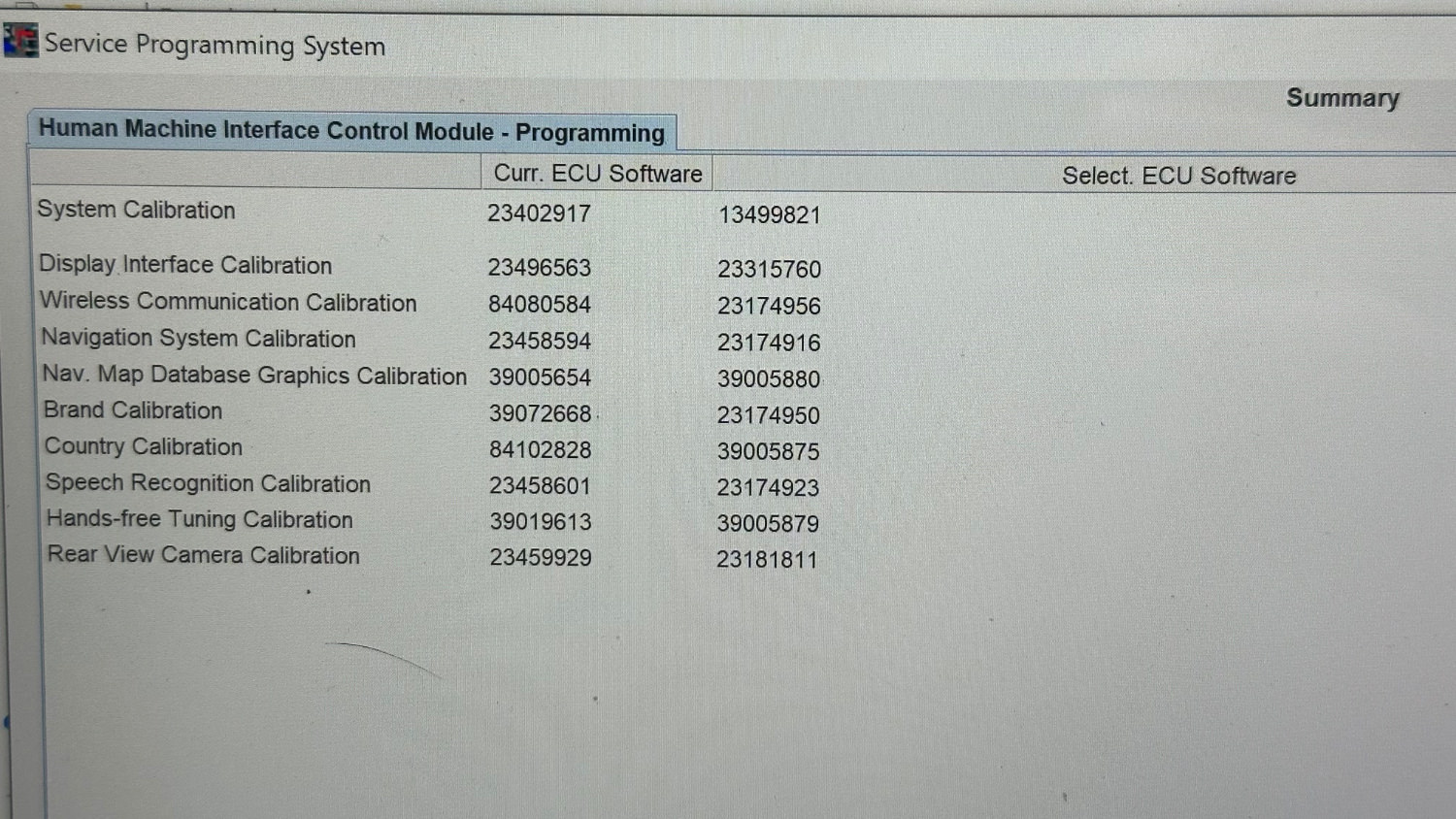

Is 23181811 for LHD RVC on HMI 2.0. I can’t find 23199113
Should be RHD
As per W0LGM6EM5E1124041

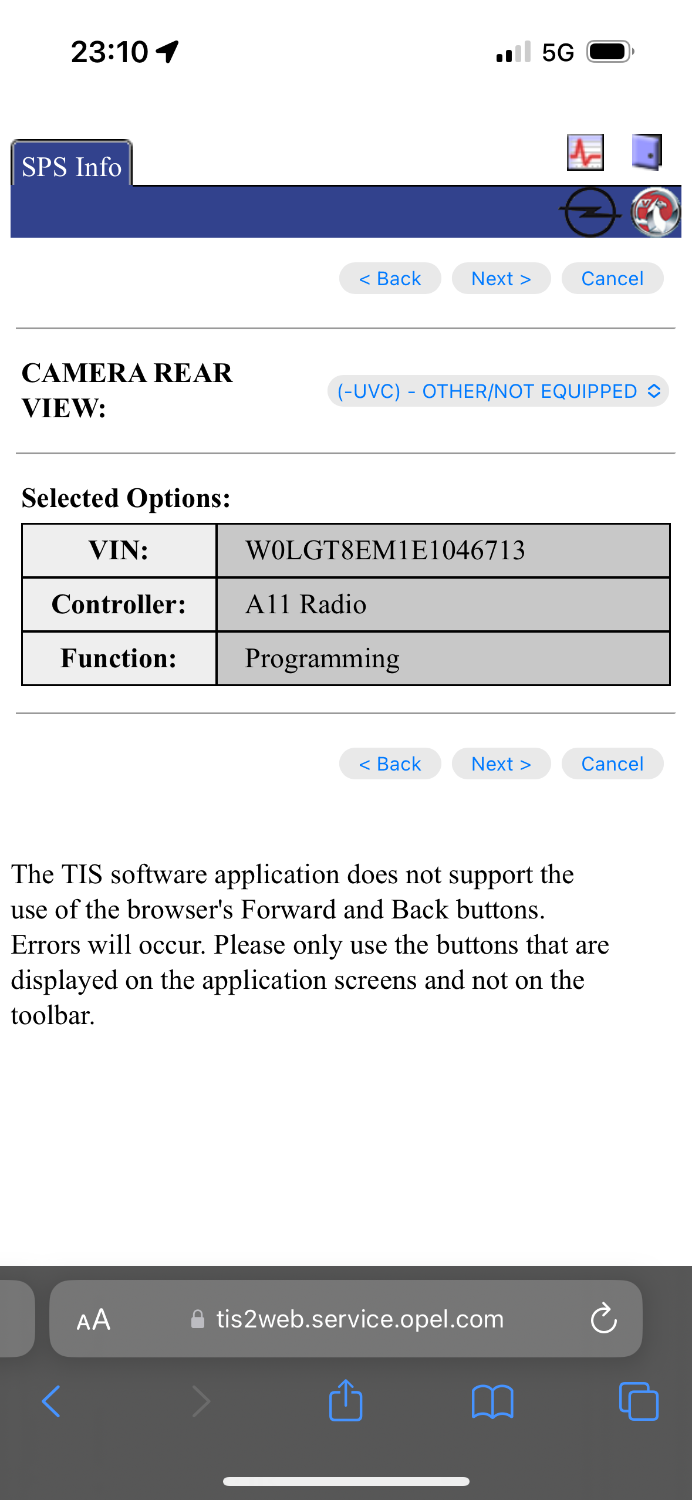

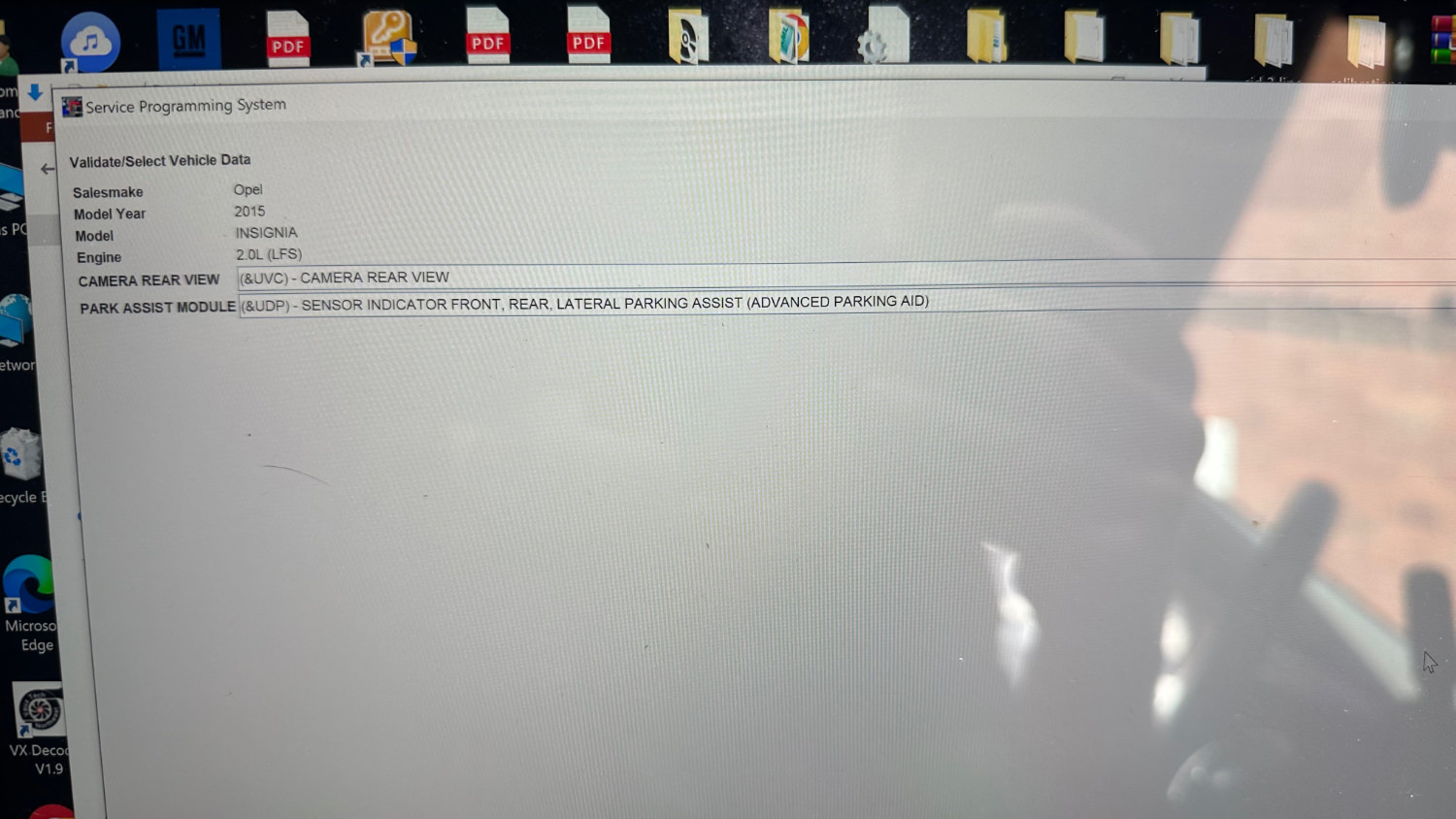

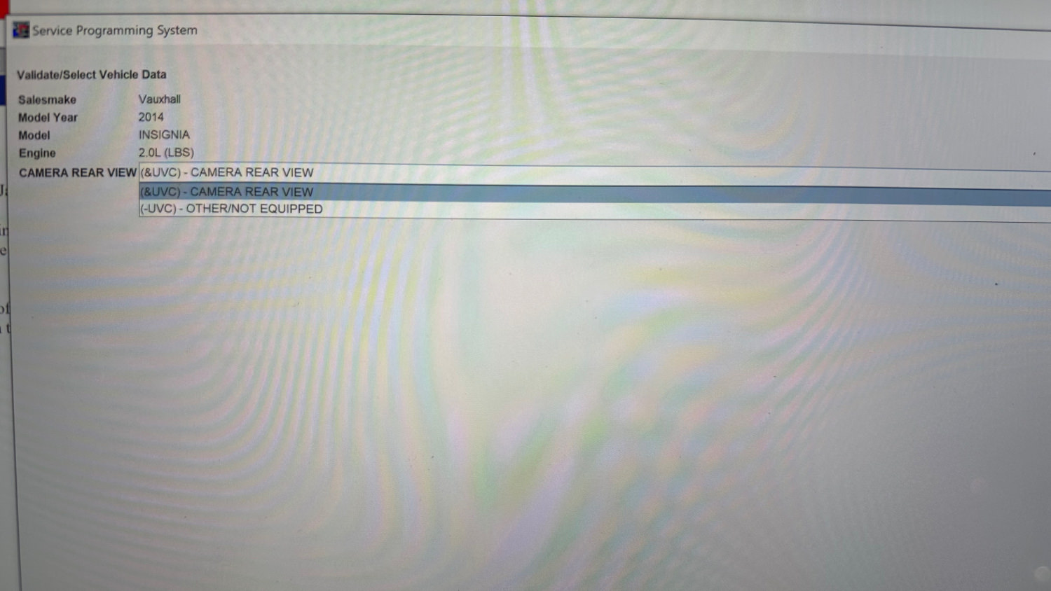

I want to activate rvc on my car which is VIN W0LGT8EM1E1046713 when i compared the only difference was 23199113 instead of 23183150, there may be alternatives.
Could be that W0LGM6EM5E1124041 also has advance park assist? maybe different call for that, mine doesn't so possible the wrong one for me.

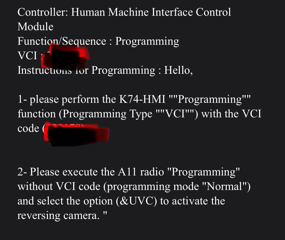

Be aware will need to program and A11 with RVC activated if remember correctly
Thank you, I wasn't aware of that, I knew you needed to program A11 for android auto, didn't know for RVC. I'll need to look to see what files I need for that.

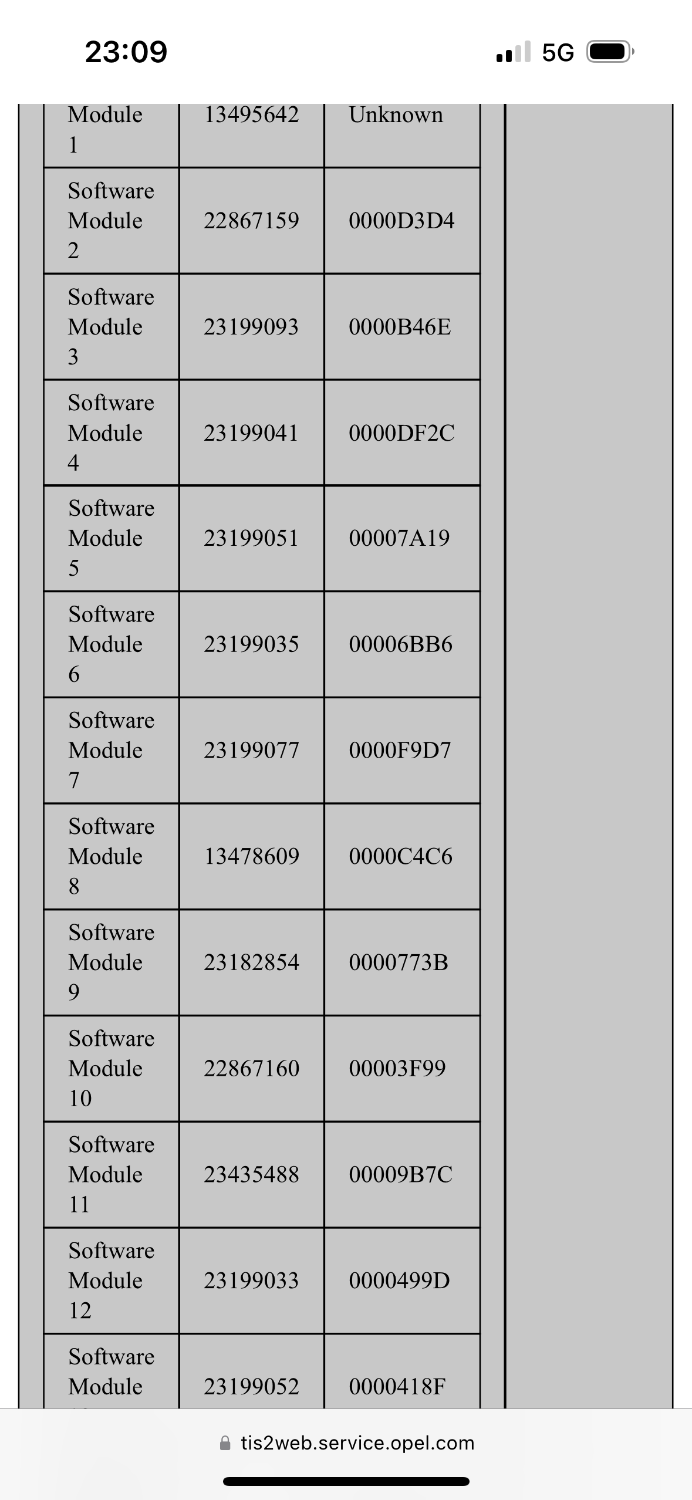

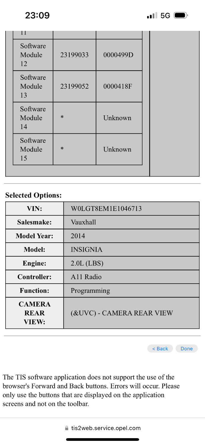

 Give me part number on your A11 module and base number please
47 minutes ago, Lyubomir Krastanov said:
@Vauxhall_Mark
Can this be found by OBD or physical inspection?

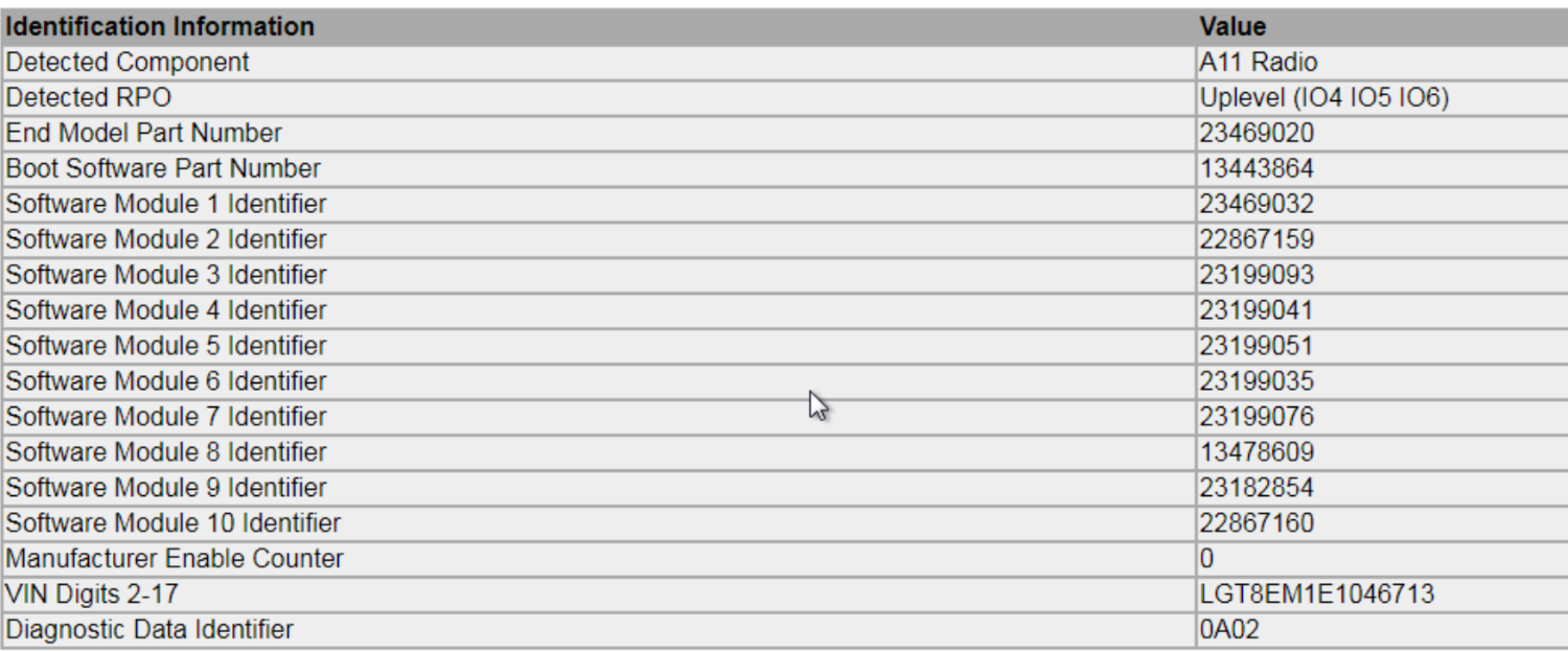

Thru obd in id page. Part model

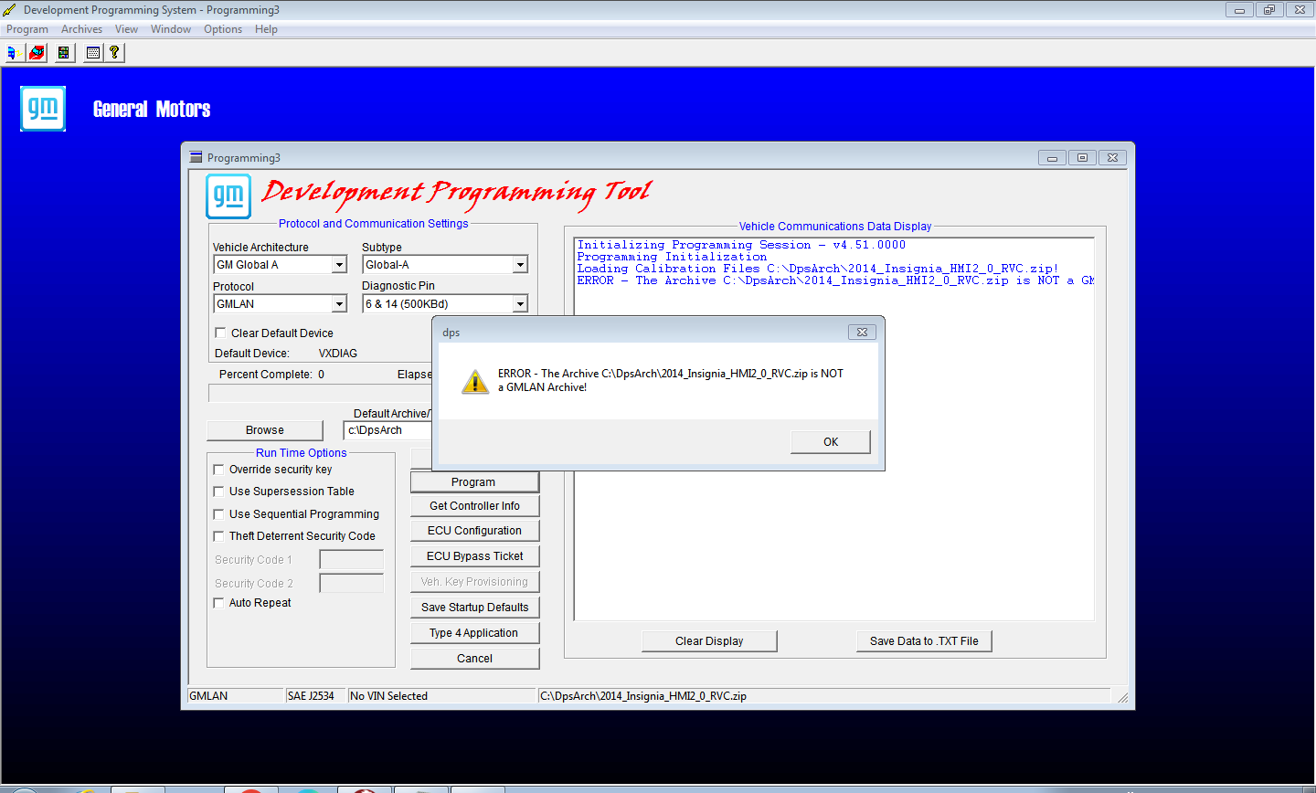

8 hours ago, Vauxhall_Mark said:
Sorry for the basic questions but any idea why i'm getting this message?
is a normal as package is not build correctly

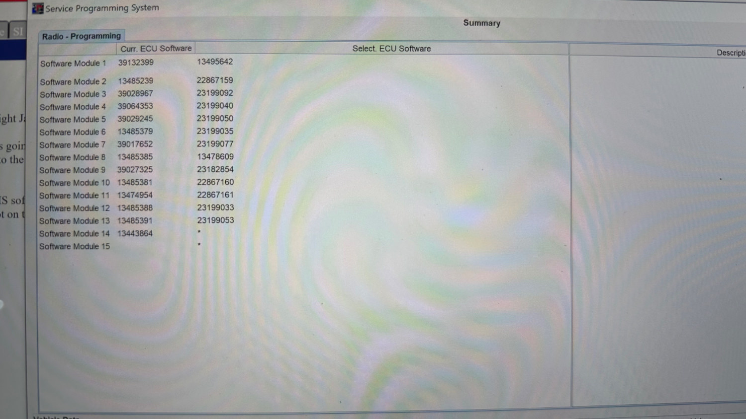

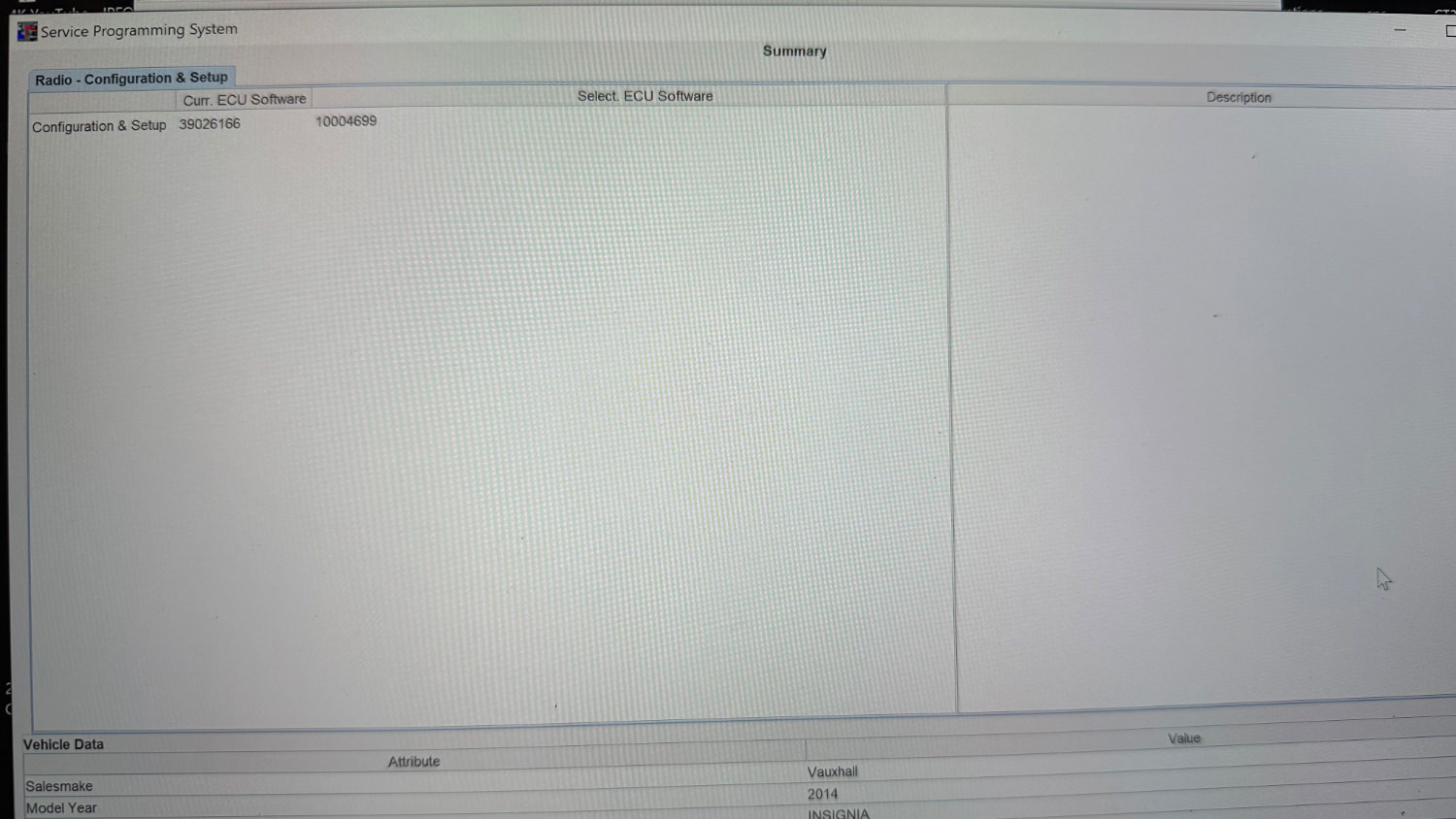

I couldn't see a utility file (there wasn't an extra one) and also there was a setup folder and blob files, I haven't seen this before in a DPS file.
Update, sorry was looking at wrong VIN
Don’t tell me where not understand files where I sent you. Is a complete. Setup folder contain files for setup and configuration function, blob file - use it to identify files structure.
