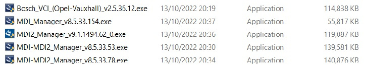

I have these installers, if any use for troubleshooting let me know...
