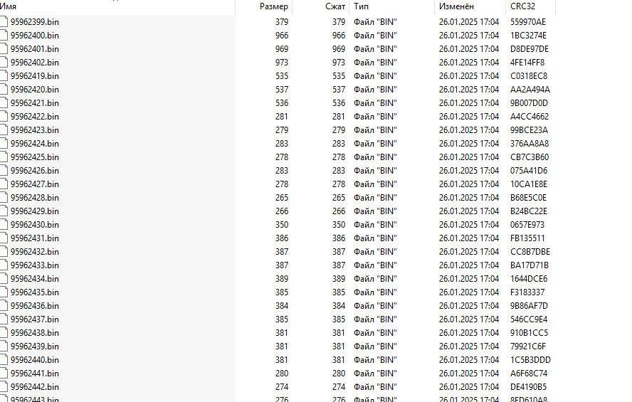

  • Yes, there is such a possibility. Only the CALs themselves are not there; they are stored cut into pieces in the _BLOB format. For that, in the database, if you change the HWID for HWNAME, then you ca

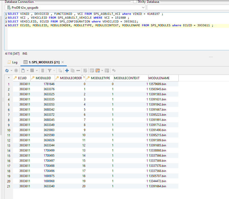

I spent a bit of time on this over Christmas and although I don't have global TIS, I do have TIS 2000.  I was able to learn a lot more about this process.  I was able to pull ALL the calibration files/util files from the TIS2000 database.  I also figured out a way to determine which files, according to TIS2000 (outdated but working) are required for anything.  This is mostly class 2 but some early GMLan stuff.  I suspect if you look in the "Calibration_files" table, you will find all of the files I did and blobs and listed by the cal part number

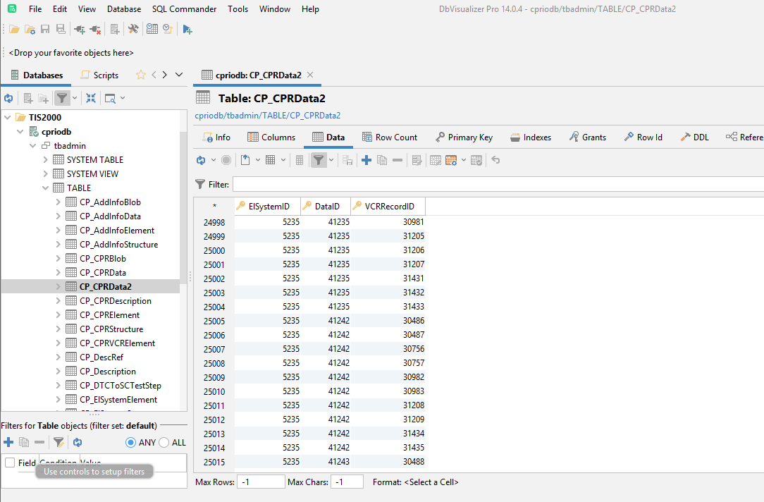

I want to explore the contents of TIS2000 DBs with DbVis.. Reason is, GlobalTIS have only ~150Mb big NAO SPS DB, while TIS2000 have much fatter >1,0Gb file..
TIS2000 have much earlier version of TransBase that GTIS, so it seems like access login/pass does not match.
I have two Win7 VMs - one with GlobasTIS, the other with TIS2000. Both have DbVis installed and configured for Transbase JDBC driver.

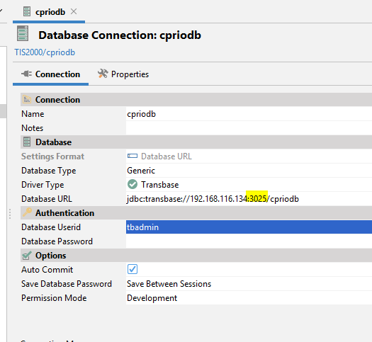

tis2000 don't have pw to connect to the DB
And use the 3025 port
@Arbe_gtc  Thanks for the tip!
I have successfully connected to the SPS DB.

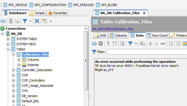

I can browse everything, except it does not want to load table with BIN blobs...
Which version of tis are you testing? It works perfectly with Opel's Globaltis32 and tis2000 v91.
don't know which release version this is exactly, but it states to be from 3/2008:

TIS2000 had different port, which Arbe have mentioned above - that solved the issue.
Now only need to sort BLOBS tab opening with an error... Will try to reinstall everything when I have some spare time.
