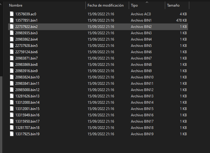

Hello all. It is possible to get calibration files from offline GlobalTis ? I have tried, but in the SPS cache i get  much more files and they are named like .bin1  .bin2 .bin3 etc..

I've never tried it but I assume it's the same process. Use 7zip to extract whatever files it gives. The name doesn't really matters.
Extract it with 7zip normaly. no problem.  the number says the ID of the file.
after extraction, the file dont have extension. you can rename as .bin

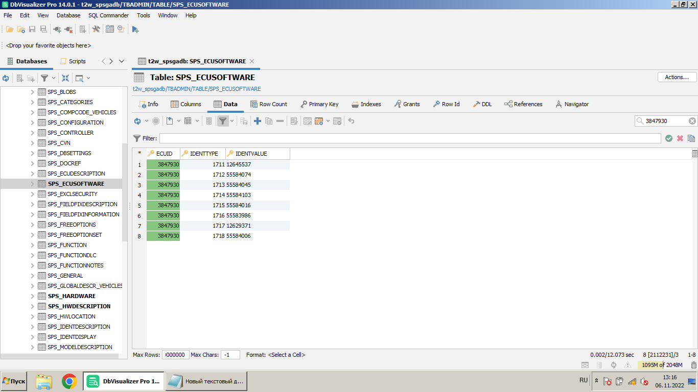

Has anyone tried to extract cal files from the Transbase DB from GlobalTis v32, or connect to it directly?

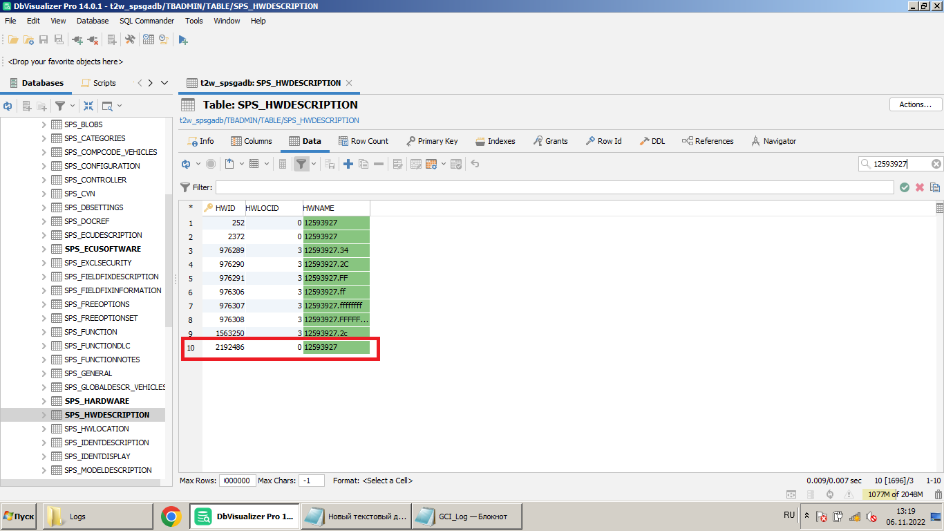

Yes, there is such a possibility. Only the CALs themselves are not there; they are stored cut into pieces in the _BLOB format. For that, in the database, if you change the HWID for HWNAME, then you can get the firmware for your VIN, but not your block by Part Numbers.
It seems there must be a table that associates the HWID's to the vin.  Any idea how that is structured?  Perhaps a query could be built to extract the data from the database.  I wonder if there is a way to turn on query logging while globaltis is running to see how it gathers info from the database..?
VIN is also decomposed into pieces in different tables. And each part is responsible for different IDs. Probably, by changing some of the indicators, you can force to assemble another firmware from not your CAL. I had a goal to flash a block that in a regular session threw an error "E2700 Hardware mismatch error".

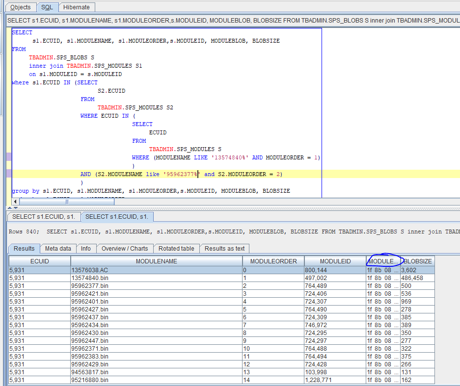

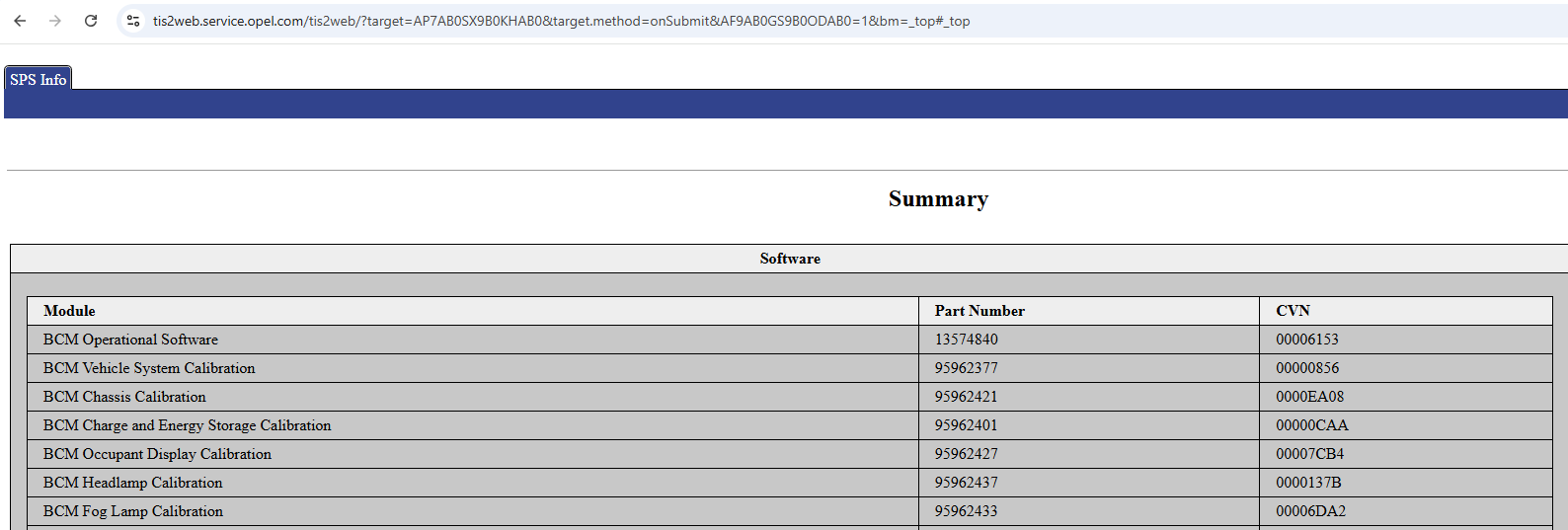

You can access to https://tis2web.service.opel.com/tis2web/ and get file, I have create sql using two part and query in database of Global Tis
Extract to file and using 7zip extract it, using dps and flash file ok

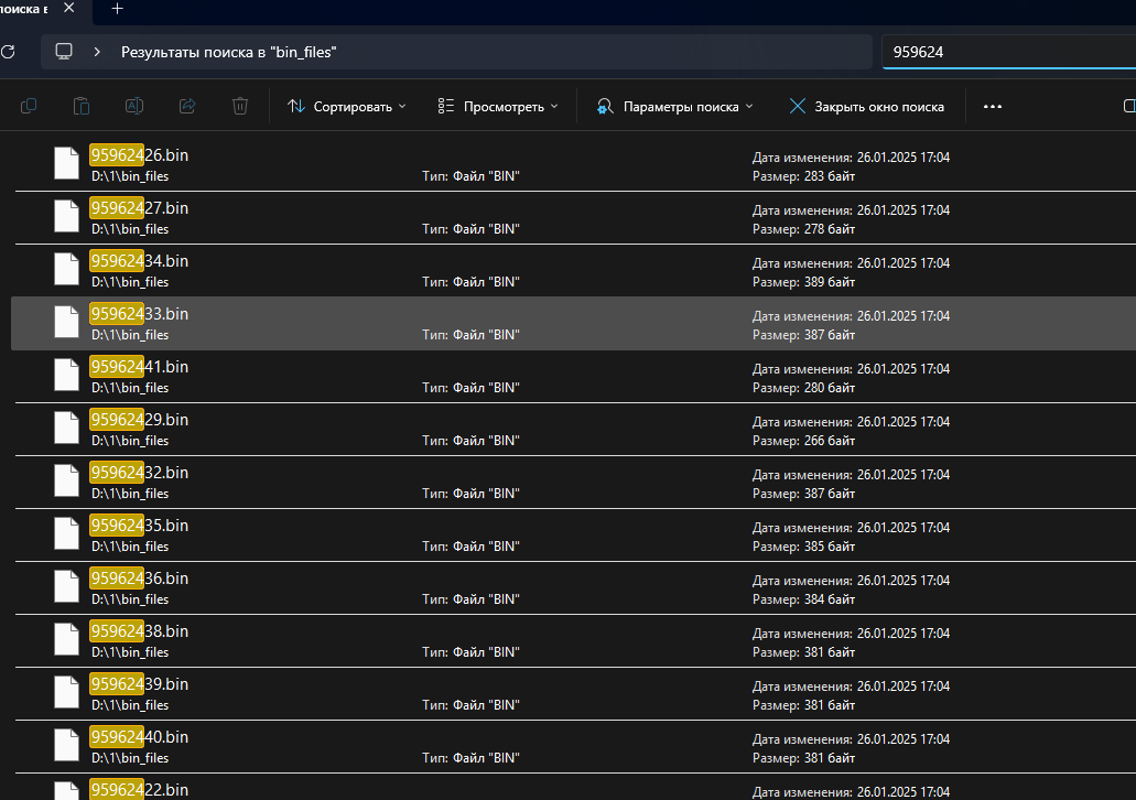

hi. At the beginning of the year, my friend and I wrote a script in pyton and extracted all the calibration files from the tiss v32 database. I also learned how to change the necessary calibrations directly in the database and write directly from tiss. but your script is also interesting, because it apparently also shows eeprom as the first *.AC file, although I may be mistaken. I'll have to figure this out. because even having all the files on hand, I couldn't determine how the rpo code is assembled into the firmware.

That's cool, but really won't be working with any vehicles which have received updates since that GTISv32 release..
Tis2Web will show newer calibrations which does not exist in offline database.

I check then 90% match with Global tis offline. May be some one module has been chang to new calibations. If you can using DPS and get current calibaration in module then may be exist in Global tis

I stumbled across the .ac file extension. Can someone explain exactly what formats there are and where the limits are with the sps blobs?
File extensions mean nothing. DPS/SPS works with unzipped binaries.
You can create an archive for DPS with .JPG or .EXE file extensions for calibrations (or without any) - it will still work.
Only the correct order matters (and that you load correct files, of course, don't try to cross-flash modules).
