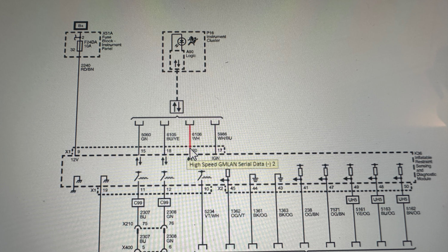

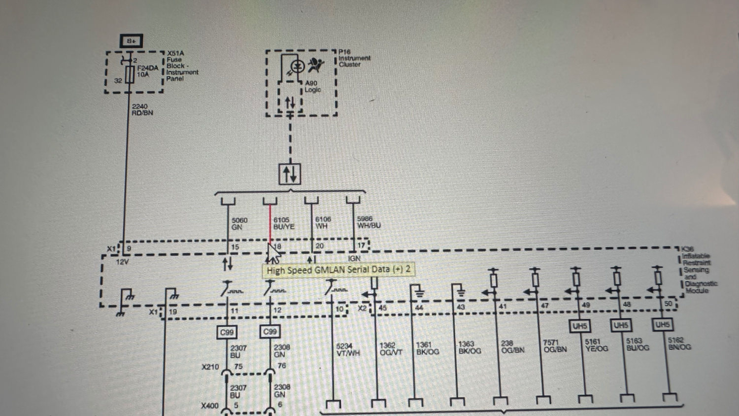

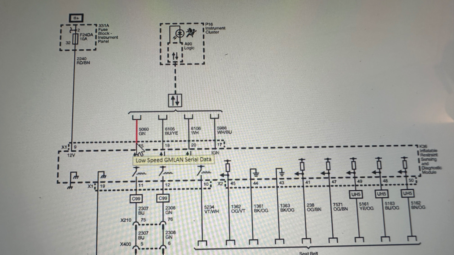

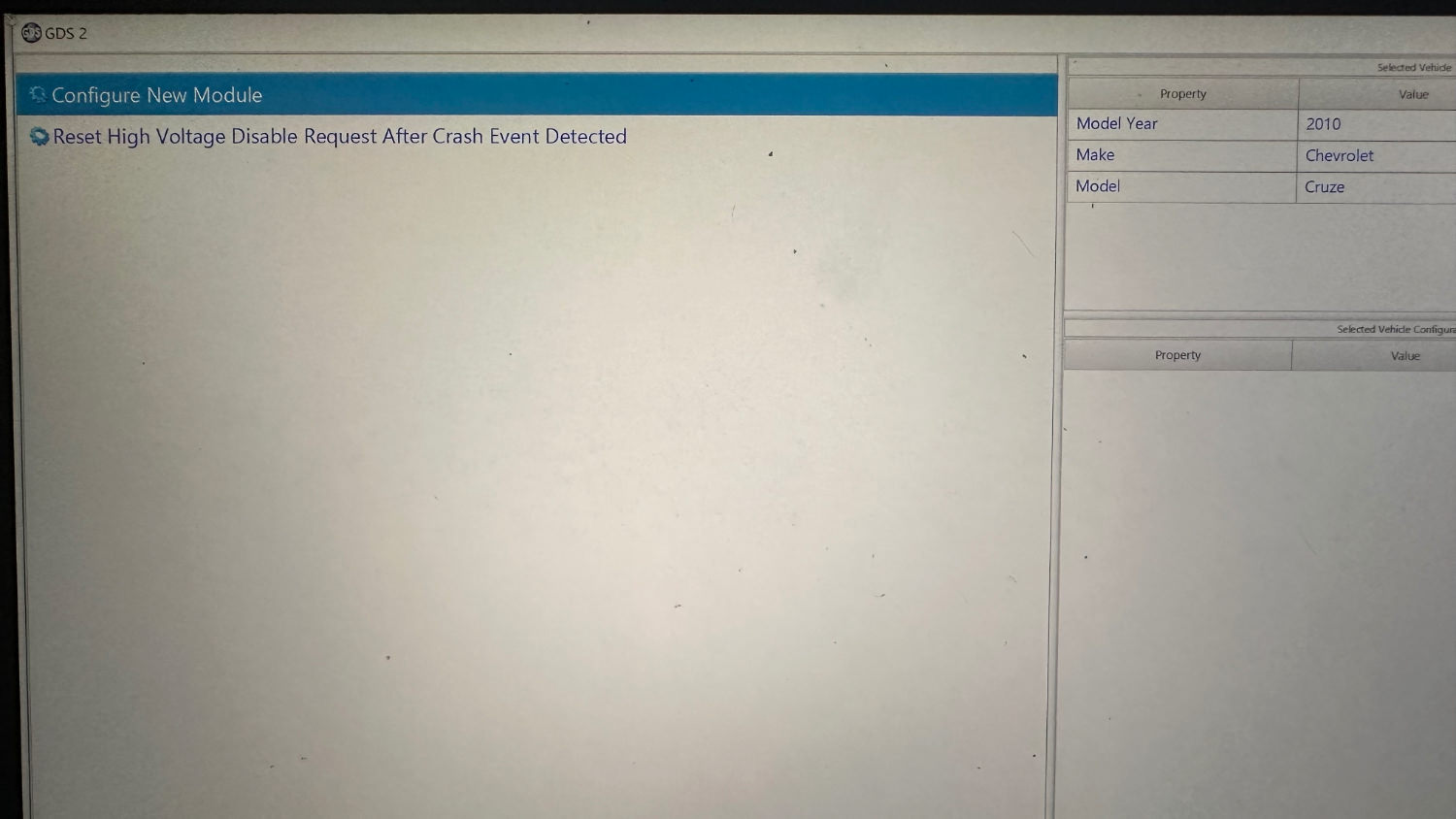

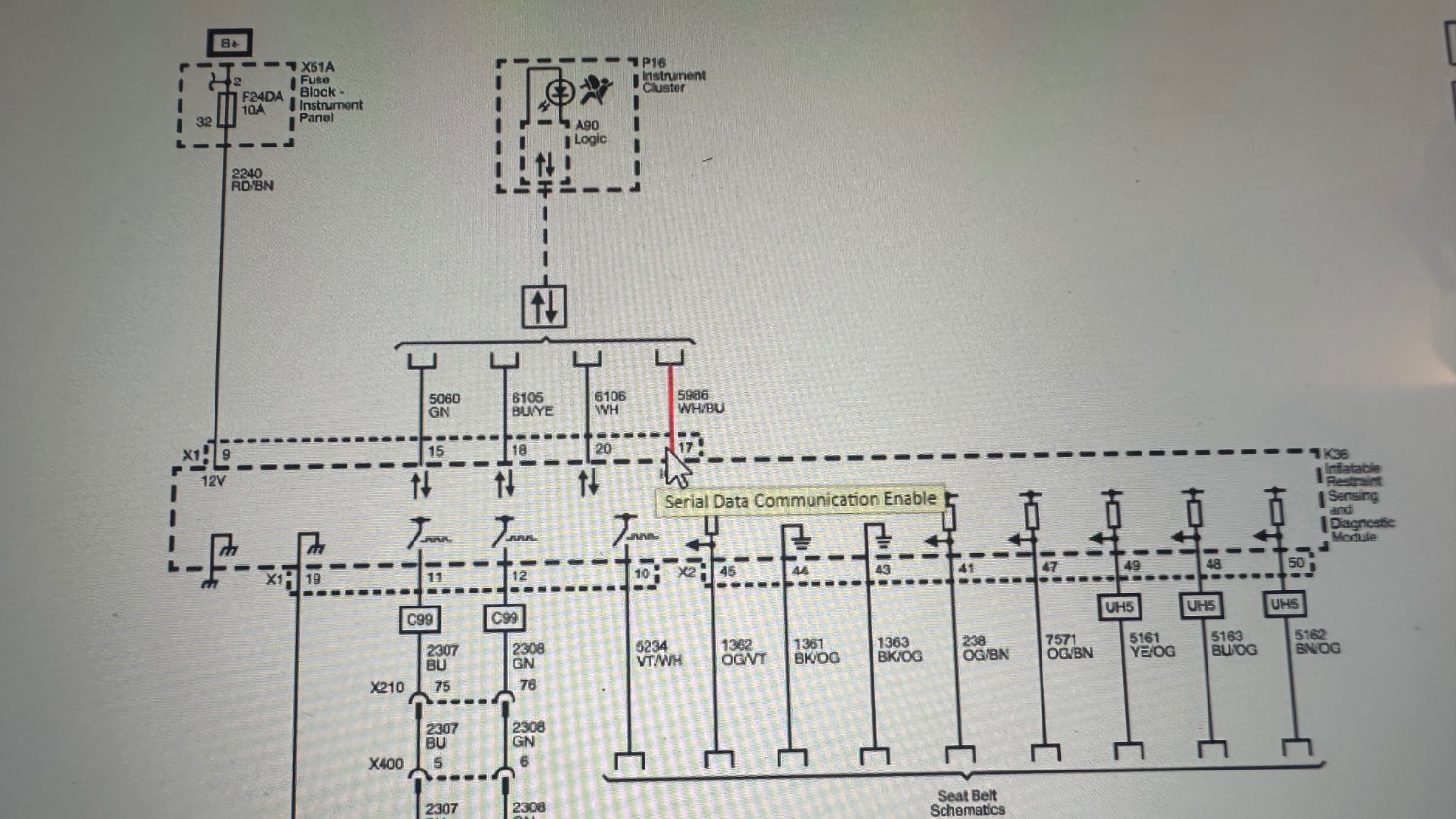

bear in mind I just check wiring diagrams and there is show obd-ipc-sdm, so to communicate with sdm may require to have ipc in line. As well you can try to go in GDS2 and configure SDM from there have option for new module. Someone on Insignia this rewrite VIN
@Lyubomir Krastanov i don't have GDS2
this works fine:
@Arbe_gtc that I say may be as not check wiring diagrams and no have SDM module yet.
@Arbe_gtc 2 questions..
Can you show how you made the connections in Red and Blue circles?
"17 0.35 PK 1139 Ignition 1 Voltage"
When you say this connection is it a normal 12v connection?
