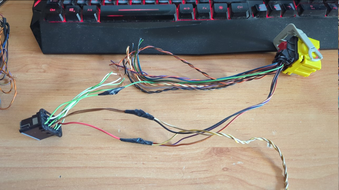

27 minutes ago, Selektion Automotive said:
@Arbe_gtc 2 questions..
Can you show how you made the connections in Red and Blue circles?
"17 0.35 PK 1139 Ignition 1 Voltage"
When you say this connection is it a normal 12v connection?
ignition voltage mean 12v thru switch to emulate you give on ignition with key - wake up signal. Is additional 12v to woke up module
blue circle cables unconnected
Red, positive and negative.
12 volts. nothing special
So basically it's a homemade breakout cable?
yes, you go o the scrapyard, cut the wires in the SDM module, and use in home.
I think the small connector is the same in ALL GM SDM units, the big connector changes.
I have a Insignia A and Astra K SDM and the small connector, matches. the big connector is different.
The OBD port its from Astra H

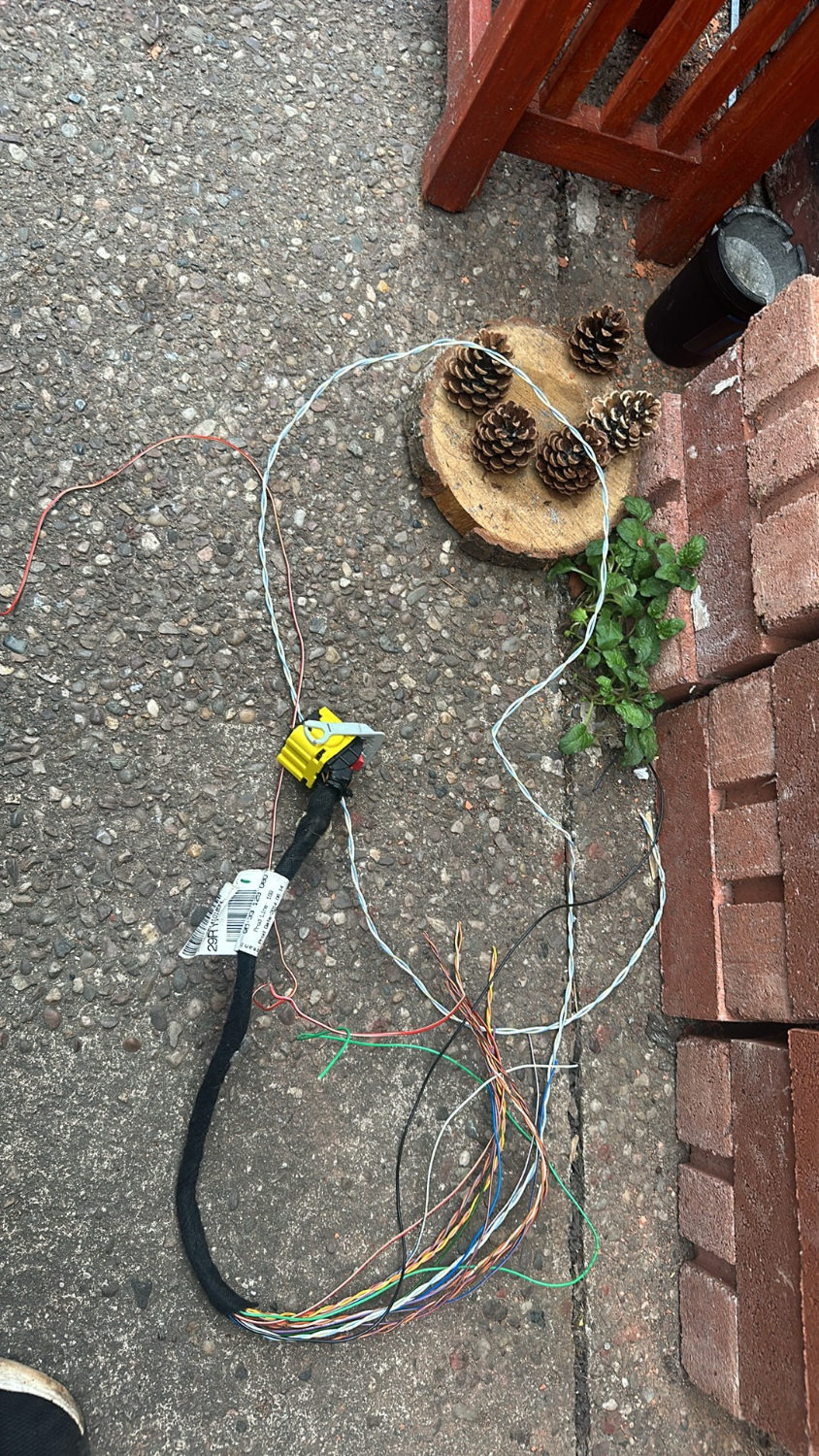

i've got 2 Chevrolet Cruze...one runing (the one with the error) and a salvage one. I will get take the connector of that car and do it like you did.

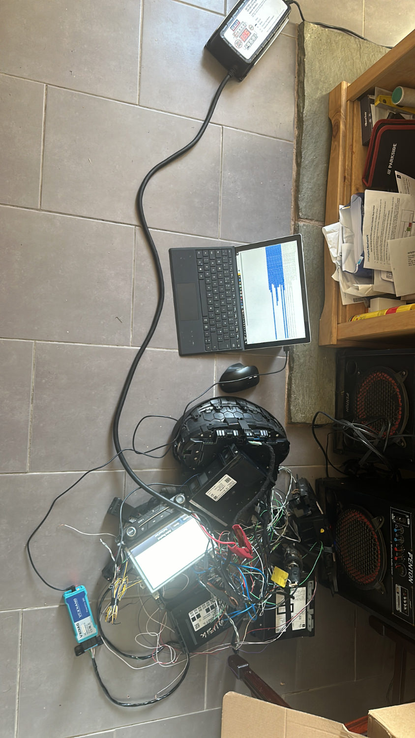

Soon full bench setup

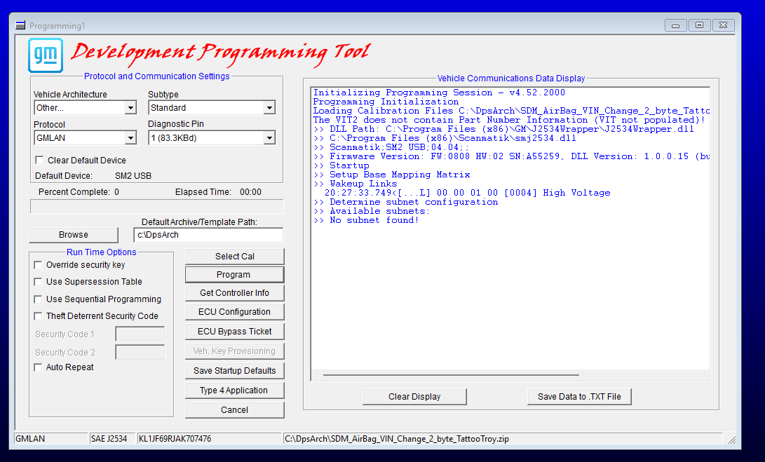

After trying every solution i came to the conclusion that this SDM is dead.
DPS directly says there's no subnet found.
did you wire white/blue cable to serial data communications?by my diagramsSDM require HI can plus serial data enable wire.
@Lyubomir Krastanov What diagram? Can you post?
10 minutes ago, Lyubomir Krastanov said:
So what cable to connect where? Help me out
@vladimius u have to get wake up device, like bcm.
@Selektion Automotivesee attached pdf diagrams, in instance to woke up module and allow to communicate you need to sent signal to it. Other way will see module in gds/dps, but will not allow you programming. Not yet tested on SDM as waiting to get one in my hands, but ECM not allow programming until signal been sent to it.
