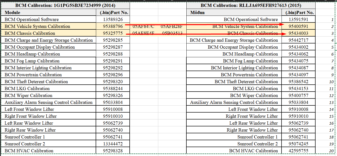

I want to copy Calibration #02 & #03 (BCM) of 1G1PG5SB3E7234999 into RLLJA695EFH927613. I has changed hex code (include checksum) & build Airchive SPAT. But when re-program with error.
Somebody help for me build archive. Thanks so much.

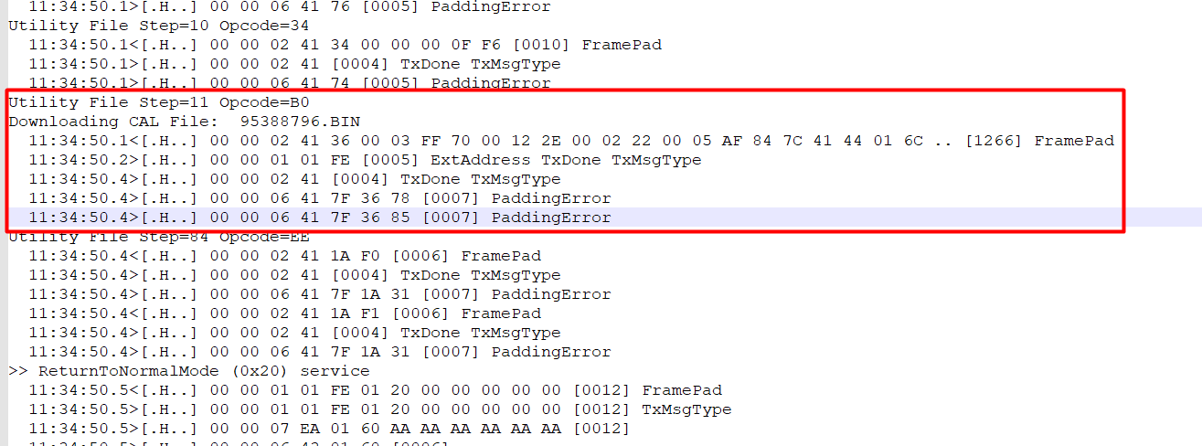

Here log program
10JAN22_BCM_ProgramLog.Txt

To step Downloading CAL File:  95388796.BIN error. Not step 95325775.BIN yet

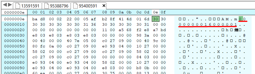

you need to match compatibility ID in your calibration file. (unfortunately, cannot use foreign calibration file directly)
13591591 (BCM Operational software) needs calibration file with compatibility ID named '0x016D'
so, try to modify your calibration file.
it's located in offset 0x0C and 0x0D. put 0x01 to 0x0C, 0x6D to 0x0D for every calibration file.

Thanks your reply. Your mean change here

No. I mean offset labeled as 0x0C, 0x0D in the picture.
