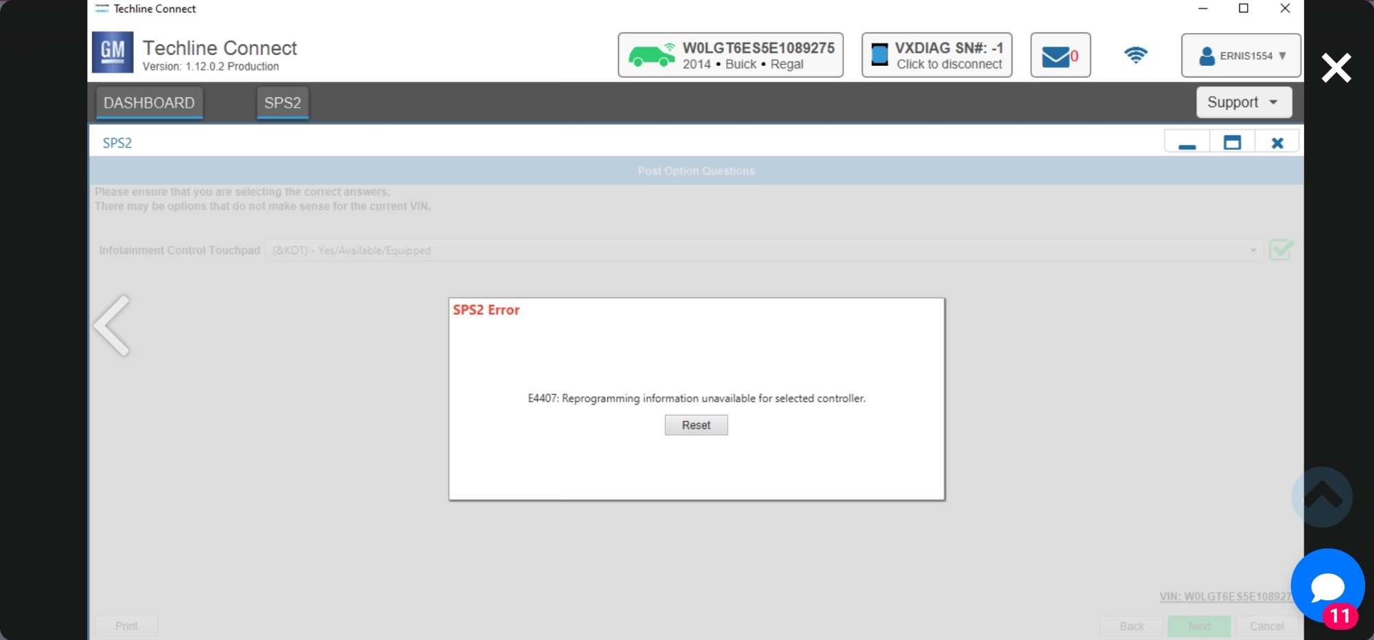

I just bought it 40$ subscription and played with it for a bit. But I'm having issues with it  any one have any idea whats up with it.? It throws same message for ipc and hmi.
Maybe anyone over here has 8 inch calibration files?

Radio and HMI need to Vin Change first,, once it vin changed you can reprogram it online by SPS to obtain original Calibration Files
