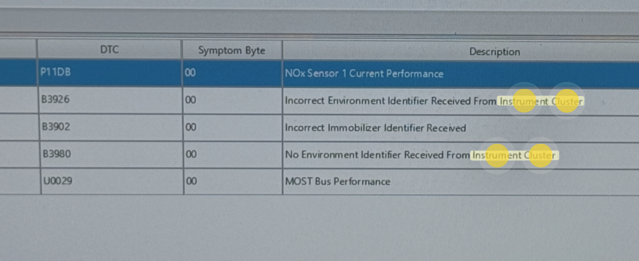

Hey guys, I'm new here, so sorry if this post would be better fit under a different forum. Just let me know and I can repost it elsewhere.
I've got a real doozy here, so get ready for a story. I'll tell you guys exactly as it happened so there's good documentation of this specific failure; anyone not interested in reading a book, the TL;DR will cover it in less detail.
TL;DR:  An improperly remanufactured HMI has managed to write its original vehicle's immobilizer identifier to 4 other modules on this 2014 Cadillac SRX Luxury 3.6L V6 FLX FLEX FI, and according to numerous sources it will only continue to spread. Once it reaches a module that is integral to the immobilizer system, the vehicle will become a no-start. I need to find a way to either manually put the correct identifiers back into these 4 modules or find a way to properly virginize them. I'm planning to buy the Xhorse Multi-Prog programmer to attempt this; if any of you have other tools you recommend over this one, please let me know. I'm completely new to this, so basically any tips you guys have are much appreciated. Has anyone here ever run into this issue before?
First off, I'm a professional mechanic. I specialize in electrical diagnostics and get a very high volume of vehicles, therefore I get the chance to see some real weird shit; this is no exception. It started as a simple parasitic draw on a 2014 Cadillac SRX Luxury 3.6L V6 FLX FLEX FI. I diagnosed it and found the Human Machine Interface Control Module was causing the parasitic draw. Once the part was delivered, I installed it, programmed it using SPS2 and an MDI2, ran it through the set up procedure using SPS2 and an MDI2, then scanned it for DTCs. I found DTC B3902:00 was set in the HMI, indicating the remanufactured unit I had installed was not fully virginized during remanufacturing. After cycling the key a few times, I rescanned the vehicle and found that DTC B3902 had now been set in the Instrument Panel Cluster, Electronic Brake Control Module, and the Climate Control module, as well as the HMI. This DTC is for Incorrect Immobilizer Identifier Received. General Motors official work-flow for this fault is to reprogram the module, then run the vehicle through an immobilizer relearn; if the DTC still returns, then the module must be replaced. I followed these instructions, but found that the DTC was still active.
Once I saw this, I called AC Delco's Diagnostic Hotline. I found that this exact issue has been documented, and never has a happy ending. In very rare cases on Global-A vehicles, when a used module is installed into a new vehicle while still containing the previous vehicle's security identifiers, the replacement modules' incorrect security identifiers can propagate, being rewritten to other modules on the networks. ACDelco has only seen this happen a couple dozen times, but it is a confirmed issue. In every case, all of the vehicles modules eventually relearned the incorrect security identifier, and the only fix is to replace every affected module at once, i.e. every module connected to the gateway. Once the incorrect identifier spreads to any of the modules integral to the antitheft system, the vehicle will also no longer be able to start. I was told to immediately remove the HMI from the vehicle to prevent further modules from being affected, to install a brand new one, and then after programming the HMI, to perform another immobilizer relearn on the vehicle.
Thankfully, in my case it had only spread to 3 others so far. I ordered a properly remanufactured HMI through GM and followed their instructions, but found the B3902 was still set in the IPC, EBCM, and HVAC. The only solution I was given by AC Delco was to replace all 3 modules with new ones. I decided to take the vehicle for a test drive to see if any new DTCs would set; rather than finding new DTCs, I found that the Inflatable Restraint Sensing and Diagnostic Module was now setting B3902 as well. No other DTCs are present in the vehicle. The incorrect security identifier is still managing to continue propagation to other modules despite the HMI being replaced; absolute worst case scenario. I reached out to a couple of my contacts that deal with programming issues on a large scale, and they also said they have seen this happen to Global-A vehicles. Much like AC Delco's reports, every time they had seen this issue, all modules in-network with the Gateway had already been affected. One of my contacts said that he had fixed these issues in the past by removing the MCUs from each module's PCB's, virginizing them, reinstalling them, then reprogramming all modules on the vehicle. Sadly he said that these jobs were all far too time consuming and not something he would be interested in ever touching again, so im still on my own.
I know all of this sounds crazy if you've never heard of it happening before, but I've had numerous independent sources confirm it as a known, extremely rare failure. Every single one agreed that it shouldn't be possible, but it is. My next step from what I can tell needs to be purchasing a programmer that will let me manually edit the bin file. From there I seem to have 3 options that I can think of.
  1. Figure out what hexadecimal bytes contain the immobilizer/environment identifier, determine the vehicle's correct identifier from an unaffected module, and write the correct data into the affected modules.
  2.  Find a way to properly virginize the modules, likely requiring me to purchase the virgin .bin files and write them to the affected modules.
  3.  The obvious one that I'm trying to avoid, replace all affected modules.
If anyone here can come up with better options, I'm open to them. I'm planning to buy the Xhorse Multi-Prog Programmer here shortly so I can get started with this soon; if anyone here has a better tool they recommend over this, please let me know. Once I get the bin files I'll be sure to post them here. Has anyone here personally dealt with Global A B3902 propagation like this, or successfully corrected/virginized affected IPC, EBCM, HVAC, or SDM modules?

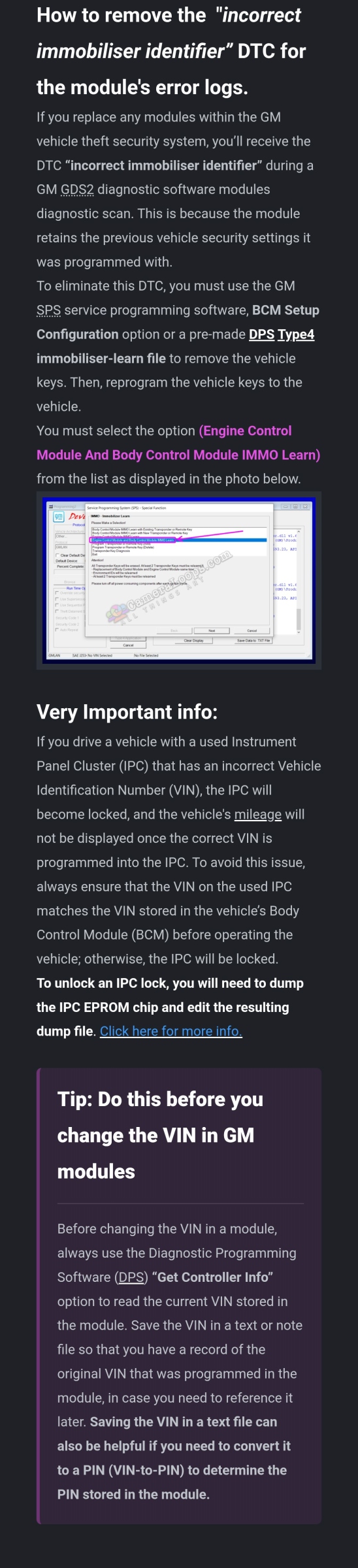

  • Hi, "incorrect immobiliser identifier" you will get this DTC whenever you install a used module that's on the GM vehicle's secured system, for example, a used BCM, IPC, EBCM, etc. This happens because

Hi, "incorrect immobiliser identifier" you will get this DTC whenever you install a used module that's on the GM vehicle's secured system, for example, a used BCM, IPC, EBCM, etc. This happens because the used module's immobiliser security code differs from the vehicle you're repairing. To program the correct immobiliser identifier code for the vehicle you're repairing onto a used module, you need to use GM SPS or DPS to remove and reprogram the vehicle keys. Also, to remove and program the vehicle keys, all modules on the GM vehicle's secured system must have the same PIN and VIN stored in them.
More information is listed in this article.

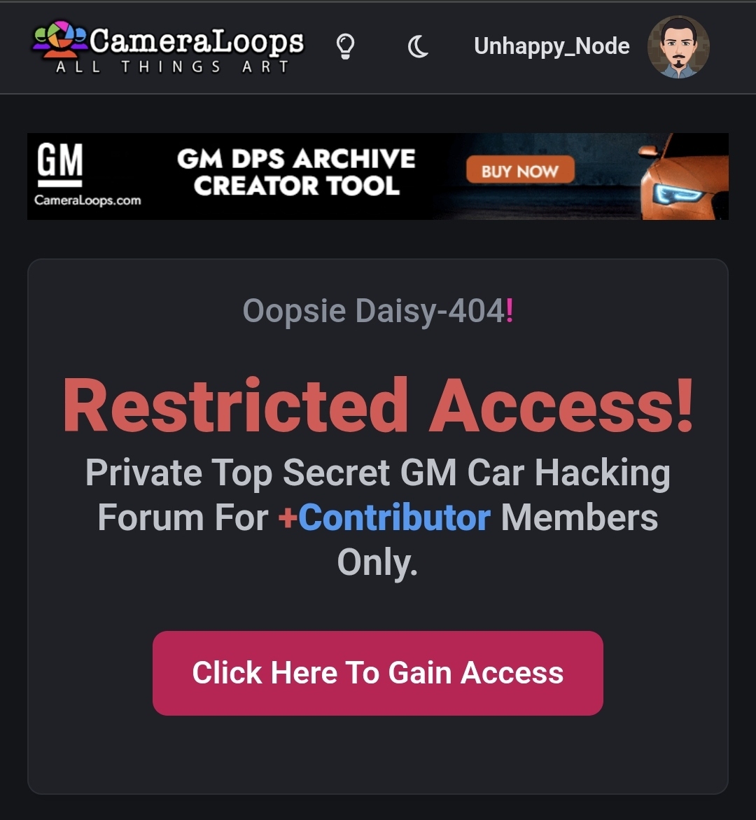

It seems like there are immobilizer identifiers stored somewhere in the bin file that SPS2 is unable to locate. It performs the procedure successfully, but fails to correct the B3902. I expect that the bytes will need to be manually located or the entire bin file will need to just be replaced with a virgin file.
Is it possible for you to run the VCAP on SPS2 and share the vcap file with us so we can review it?

Had same issue with retrofitted IPC. When i changed PIN to match BCM, error disappeared. No need for Key relearn.
In all the BCMs I’ve tested, the immobilizer environment DTC never cleared—even after simply changing the PIN and VIN—until I relearned the keys and the environment ID. There is a specific DID (though I don't recall which one) that "hides" the environment immobilizer DTC.
Honestly, no idea. Ive never heard of vcap, and when i click on the name it brings me to a 404.
Are you sure it was just the B3902 that was being reported? From what ive read, the PIN being incorrect should cause other DTCs other than B3902, which i do not have. If your right and a pin relearn can actually correct B3902, this may be something i need to look into.
Pretty sure.
B3926 and B3980 are from BCM
B3902 is from IPC
That article about the Vcap tool was hidden. I unhide it. The link to the vcap word now works.

This is pretty interesting. Your BCM is acknowledging the incorrect identifier in the IPC, but my BCM isnt acknowledging the incorrect identifiers in a single one of my modules. Even after a test drive, the only DTCs returning are the B3902s in the 4 modules. No others.
I appologize that i have zero illustrations or files to back up what im describing, as i said, im new here. I still need to get all the dps software set up on a laptop before i can get you guys everything. I think im gonna be purchasing a seperate laptop just for all of this stuff, cause i currently use my personal laptop for alot of school stuff which is picky as hell about what programs it sees installed. Id use one of my work laptops if i didnt think the owners would mind, but theyd most definitely not be happy to find i installed a bunch of 3rd party software onto any of their devices. Ill order a laptop very soon, likley this evening.

1 hour ago, Adelin said:
Pretty sure.
B3902 is from IPC
B3902 - Incorrect Immobilizer Identifier Received.PDF Diagnostic Information and Procedures - DTC B3902.PDF
48 minutes ago, Arbe_gtc said:
You know if there are some TSB about that?
I actually asked Acdelco this exact question when i had them on the phone. They said that there hasnt been enough verified reports of the identifier propagation for a tsb to be officially created. There are only tsbs for general warnings of installing used modules, expessing that the modules may become damaged; none that go into detail of identifier propagation. Here is the bulletin im referancing.
PIP4670J.pdf
