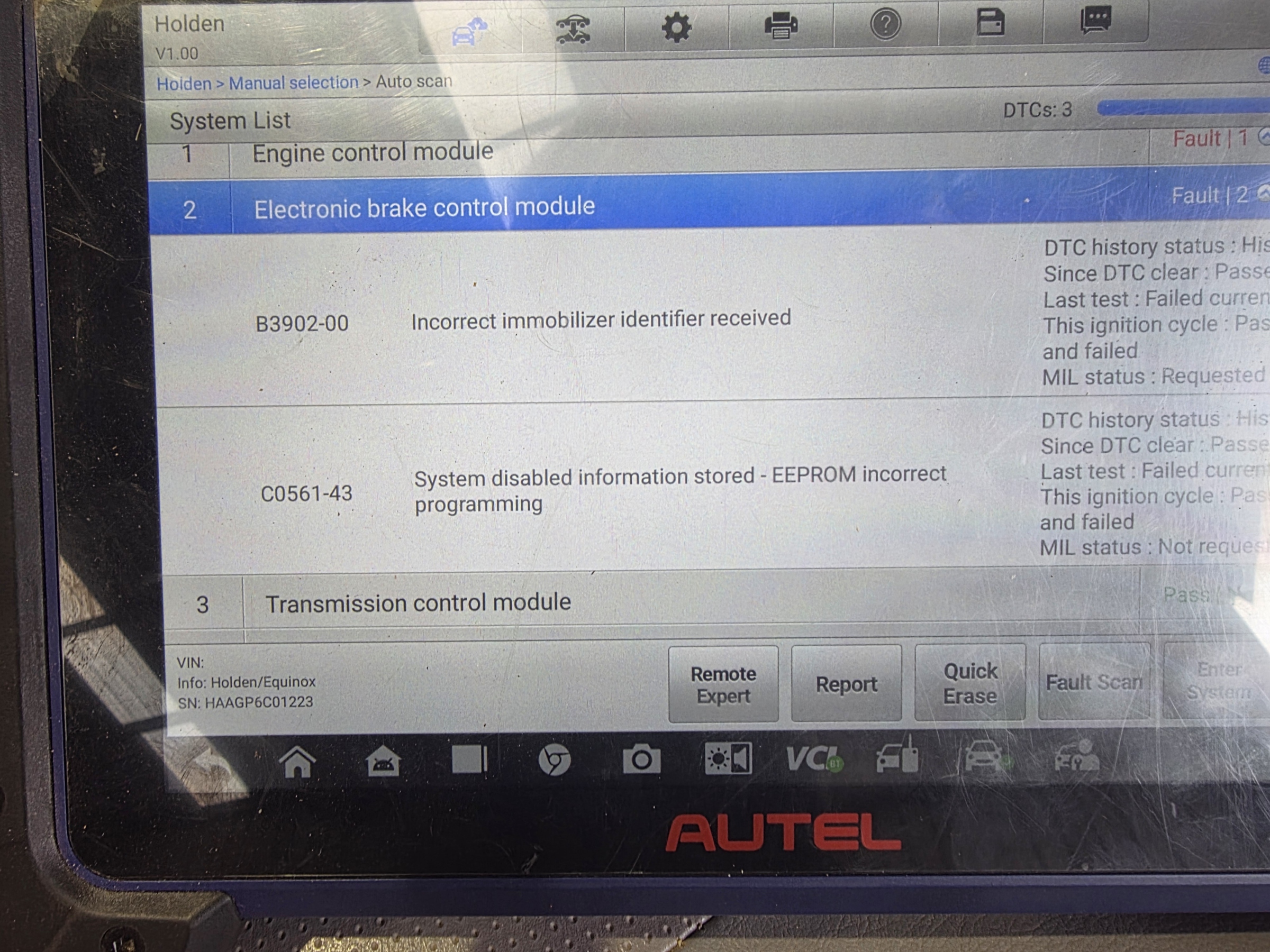

I have used sps on a second hand ebcm it has changed the vin in the ebcm but not the immo data im getting these codes i will up load photo20260724_085827.jpg

  • Some people (on this forum too) have dealership access and can get security code by VIN. After getting both PINs, you should program EBCM again with DPS (must be setup correctly beforehand, of course
Of course it won't change that..
You need to know donor and cars PINs, to change PIN in donor module to the car's value.
After that need to perform Immo learn to remove DTC error about incorrect identifier.
If i have the vin for the used ebcm how do I get the pins for both vehicles and change then
After getting both PINs, you should program EBCM again with DPS (must be setup correctly beforehand, of course).
