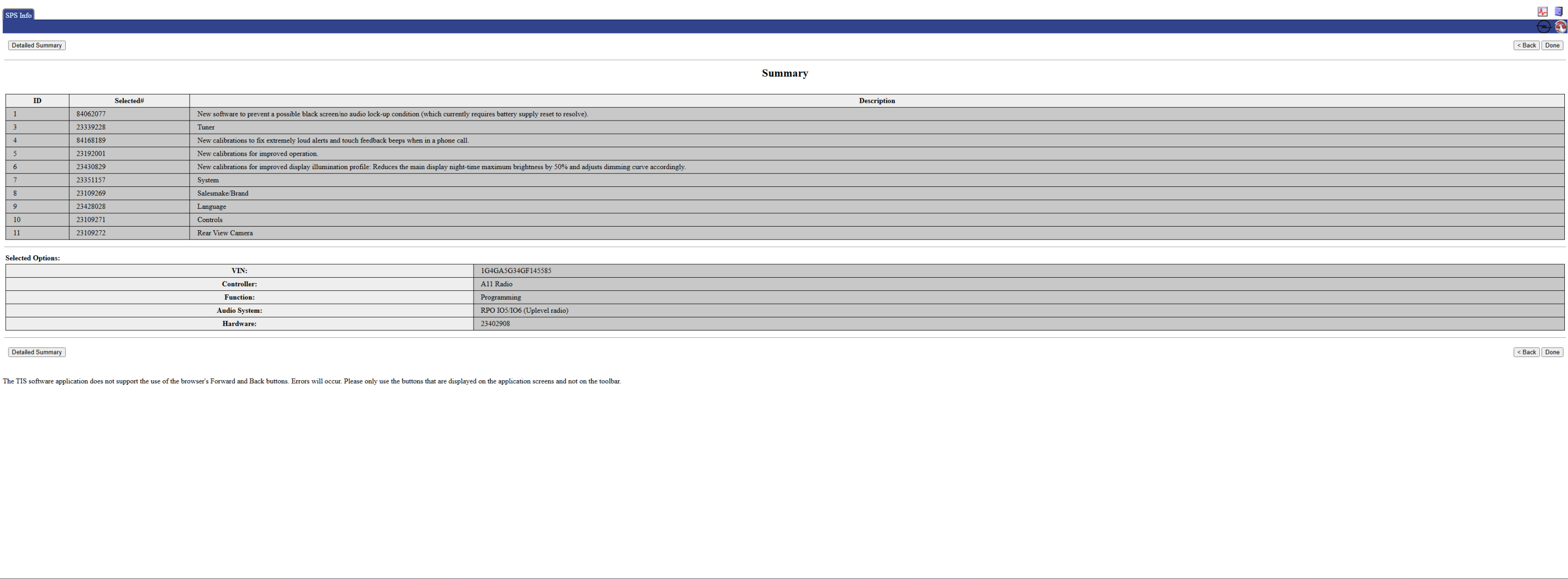

@Arbe_gtc Yes the programming starts. I have attached a picture of the calibration order with the archive order. I've noticed that the calibration order from GM goes from 1 to 3 and skips #2. Not sure if that makes a difference or not.

That could be your issue..
Files need to be in the correct order.
Correct index is inside each calibration file. The mostly are the same as in the TIS info page you have screenshot from, but not always.
better post you BIN files, so we can put together an archive for you.
