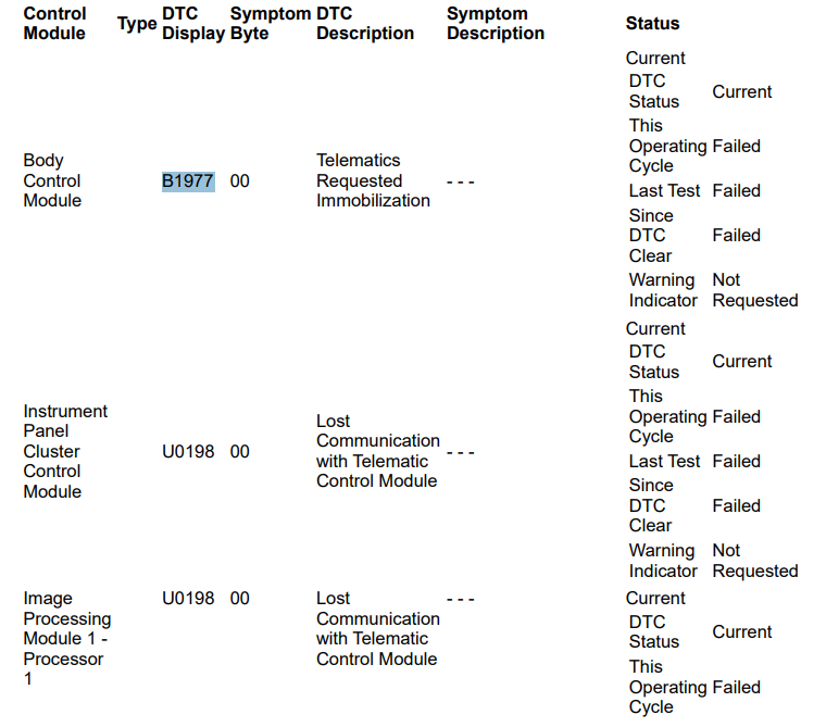

Hi everyone,
I have a 2023 Cadillac Escalade bought at a US auction as stolen/salvage title and imported to Europe.
The car won’t start and is showing DTC B1977 (Telematics Requested Immobilization). OnStar module is fully bypassed and physically removed. The code now appears only in the BCM.
Questions:
  • Does anyone have a working solution for this problem?
  • Will replacing the BCM with a new one fix it?
Any advice or experience would be greatly appreciated.
Thanks!

    As far as I'm aware Onstar does not have service in Europe, so probably no way of relocking the car again. And you do change TCU - its has different IMEI which are not in the database. I tried contac
  • All these units are on SWCAN bus. Sounds like you have issues with that, rather than active theft lock.
  • It could be that too! We do not have remote vehicle blocking via OnStar in Europe - so I do not know how it actually works. Need to study wiring diagrams a bit! Find what triggers "Comm. enable" signa
Hi,
Yes replacing BCM with a new one would work, had the same thing with Cadillac Lyriq - car stolen, Telematics imobilized the vehichle. Had to replace BCM, redo the Immo in order for the car to start again.
Global A module it was possible to remove theft flag from BCM by editing epprom, there new global B modules have encrypted MCU so as far as i researched - no solution yet.
If you want to have the car fully functional you will need new TCU too, cause lots of a systems in the car are going trough Telematic module on these new cars.

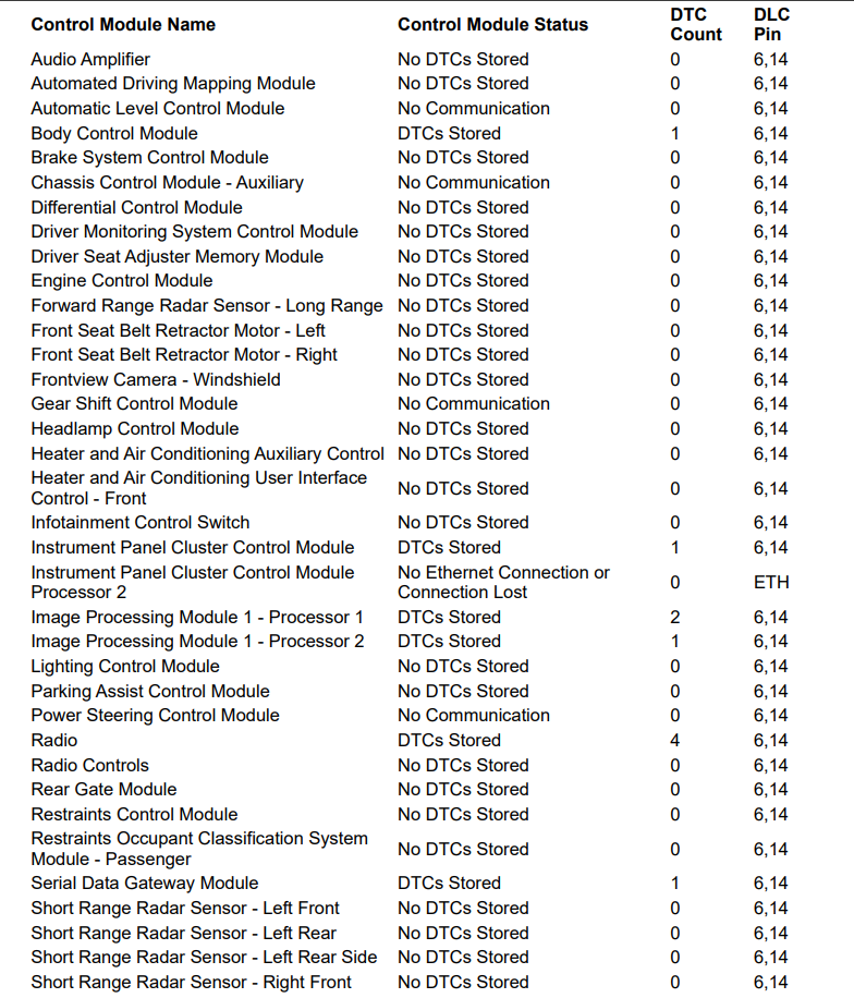

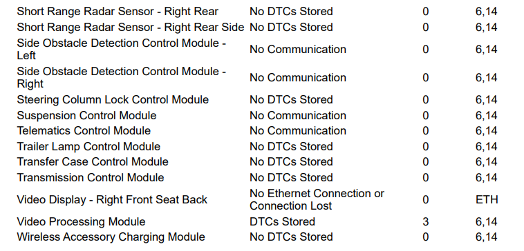

This all being Global B. What surprises me is how the start thread shows only a few modules have lost or show NO communication. The 23 Envision I have was in an accident ....drained the battery completely dead. Battery was replaced and minor wirings for headlights and short range radar sensors were repaired. However the radio hvac , and cluster do not turn on at all. I will have to get a print out, yet I am told 7 modules show NO comms . Local independent shop here in the states mentioned it was towed wrong (key not in the vehicle) and possibly went into theft mode....... Vehicle will start / drive , yet no cluster, radio, hvac controls, what gives.
For me I got new bcm and new ecu but can’t find new telematics as it is in back order. If I replaced this two by removing the old telematics will the car start without the telematic control module?
Thank you pupu14, the local shop had me believing it was the serial gateway module preventing comms between the 6 modules.....some sort of security mode. I best locate a different shop.
Find what triggers "Comm. enable" signal to activate these modules. Try to bypass SGW and connect directly to CAN bus to see if you can communicate with IPC, HVAC, etc..
Thank you pupu14, I will have to learn how to dive into CAN hi/low sniffing.... with a major learning curve (I understand hardware a lot more than software). I look forward to selecting a CAN FD transceiver to monitor on a PC through USB. Should be easily found on ali-xpress / -bay robotic sites and will have to rely on freeware CAN translators .......to see/ understand bus traffic.
The serial gateway in this gm vehicle is tucked behind the radio screen, will tap into the twisted pair wires there when i get the CAN interface. I appreciate your help, Thank you very much.
