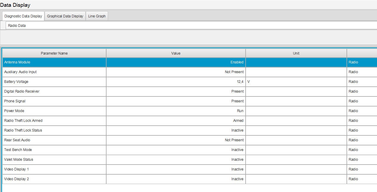

Radio Data List:
Radio Theft Lock Armed - Armed
Radio Theft Lock Status - Inactive
The display is blank—black.

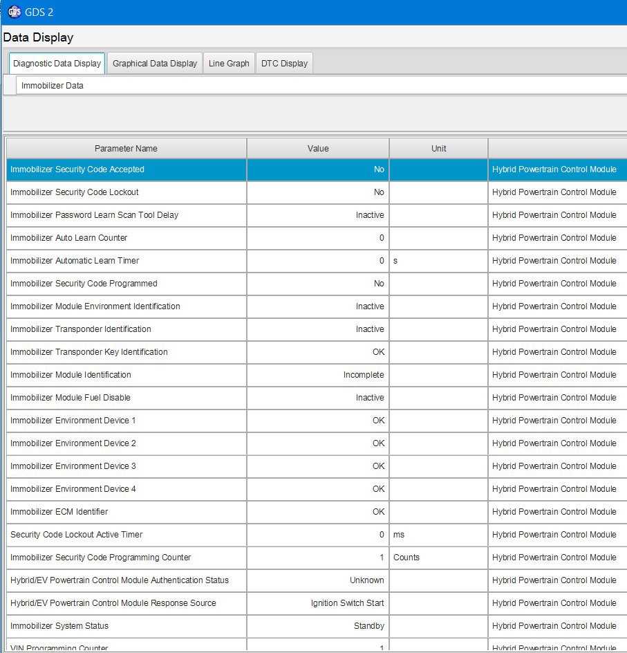

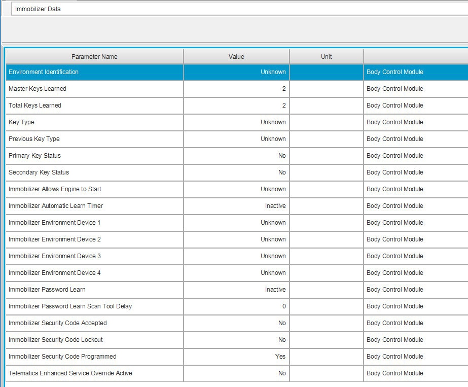

When the car arrived, it had a non-OEM EBCM installed. I changed the PIN and VIN and programmed latest calibration by SPS, then completed IMMO Learning, adding 1 new key . All programming went smoothly and successfully. But the radio won't turn on, and there's some garbage in the IMMO data lists—Environment Identification—Unknown. Has anyone else had something like this? Where should I look for the problem?

  • If it's always black, no matter the ignition status - it's safe to assume there is NO POWER to display, or it is faulty. As you can access the radio throughs GDS2 - this part is working correctly, so
Radio Data List:
This is normal. At least, everything works in this car..
Also, radio have nothing to do with IMMO.
So your problem is somewhere else. Check all relevant fuses for infotainment system.

There is no any words on the display, it's black.
no IMMO DTC
Radio data list:
Inactive
Armed
As you can access the radio throughs GDS2 - this part is working correctly, so it cannot be the reason there is no picture on the screen.
Once again - check fuses. Check there is actual voltage coming to display connector. Try with a different screen (order a second-hand unit).
