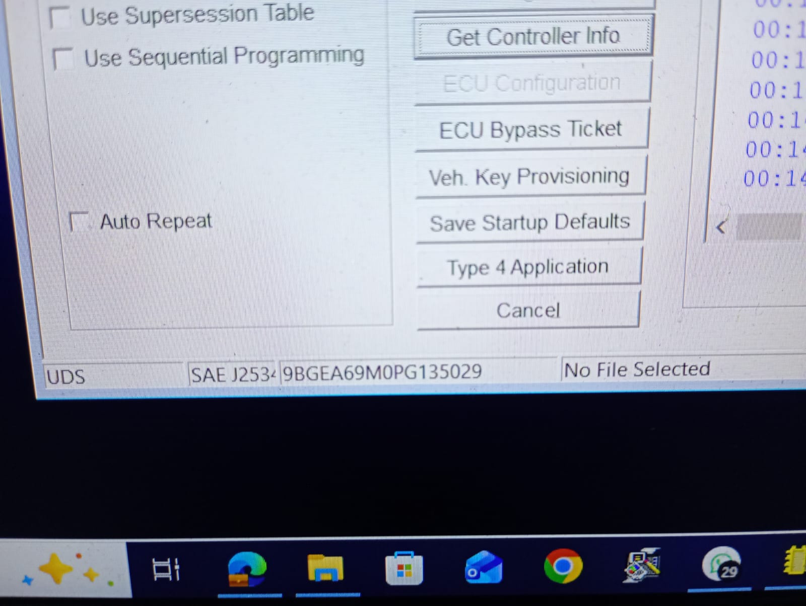

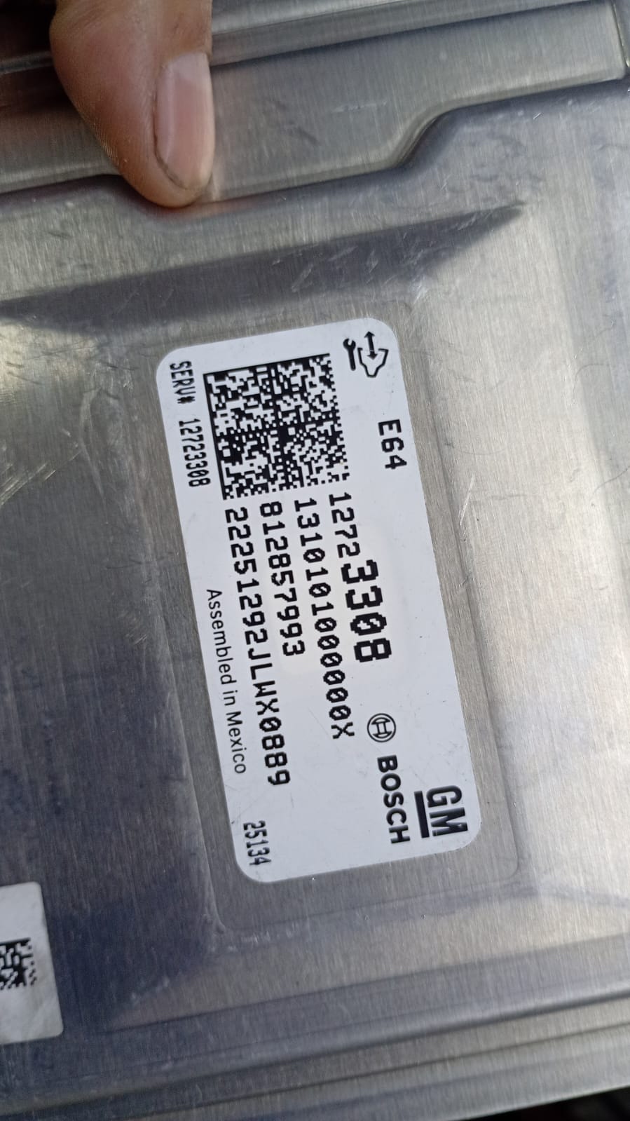

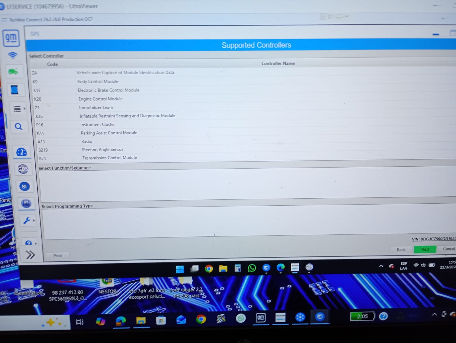

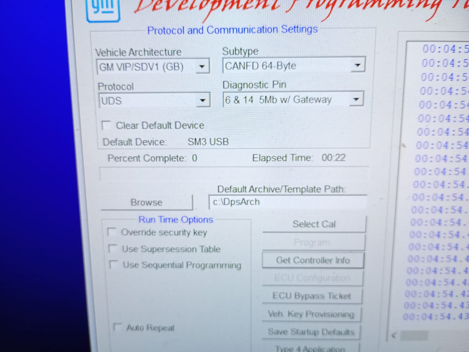

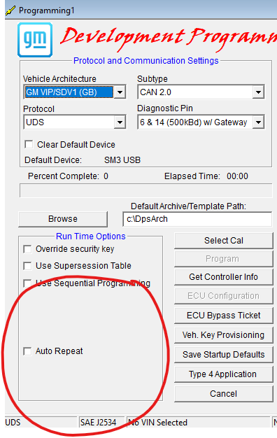

es posible poner ecu de motor usada ya que estoy tratando de hacer pruebas con DPS Y no logro cambiar chasis vin.
tengo calibraciones bajadas haciendo SPS

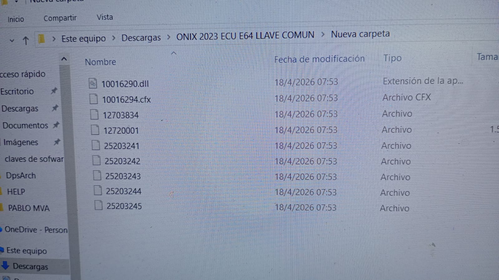

ONIX 2023 ECU E64 LLAVE COMUN.zip

    Is possible, but you have to know both VINs and PINs.

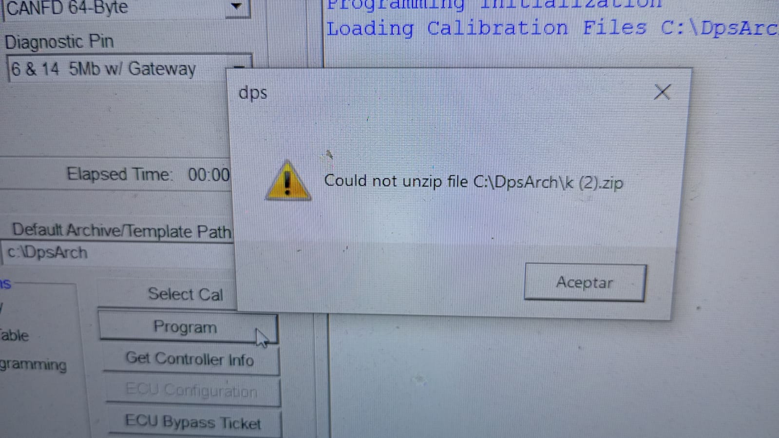

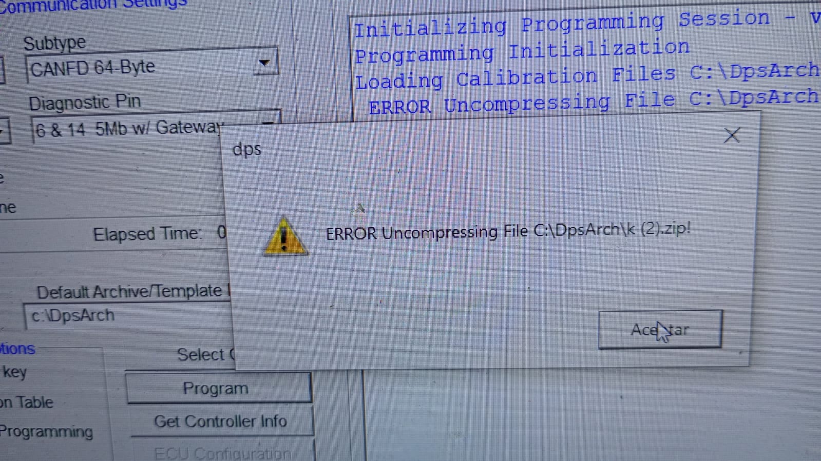

  • You need to unzip received files from SPS/TLC cache folder first... K20_BIN.zip K20_Type4_removal.zip
    I'm not 100% certain, but I believe Global B doesn't require a PIN.

Is it possible to put a used engine ECU since I am trying to do tests with DPS and I can't manage to change the chassis VIN.
I have calibrations downloaded doing SPS
OK THANK YOU
Will need PIN to be deimobilised and then immobilised.
47 minutes ago, blocked said:
You have Vehicle key provisioning :)

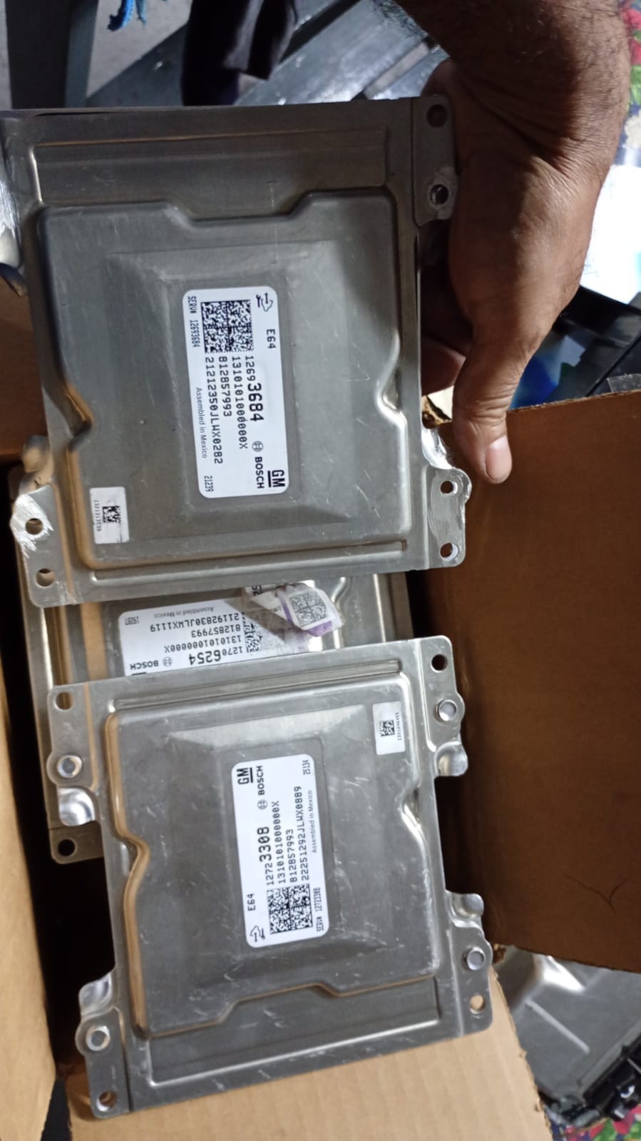

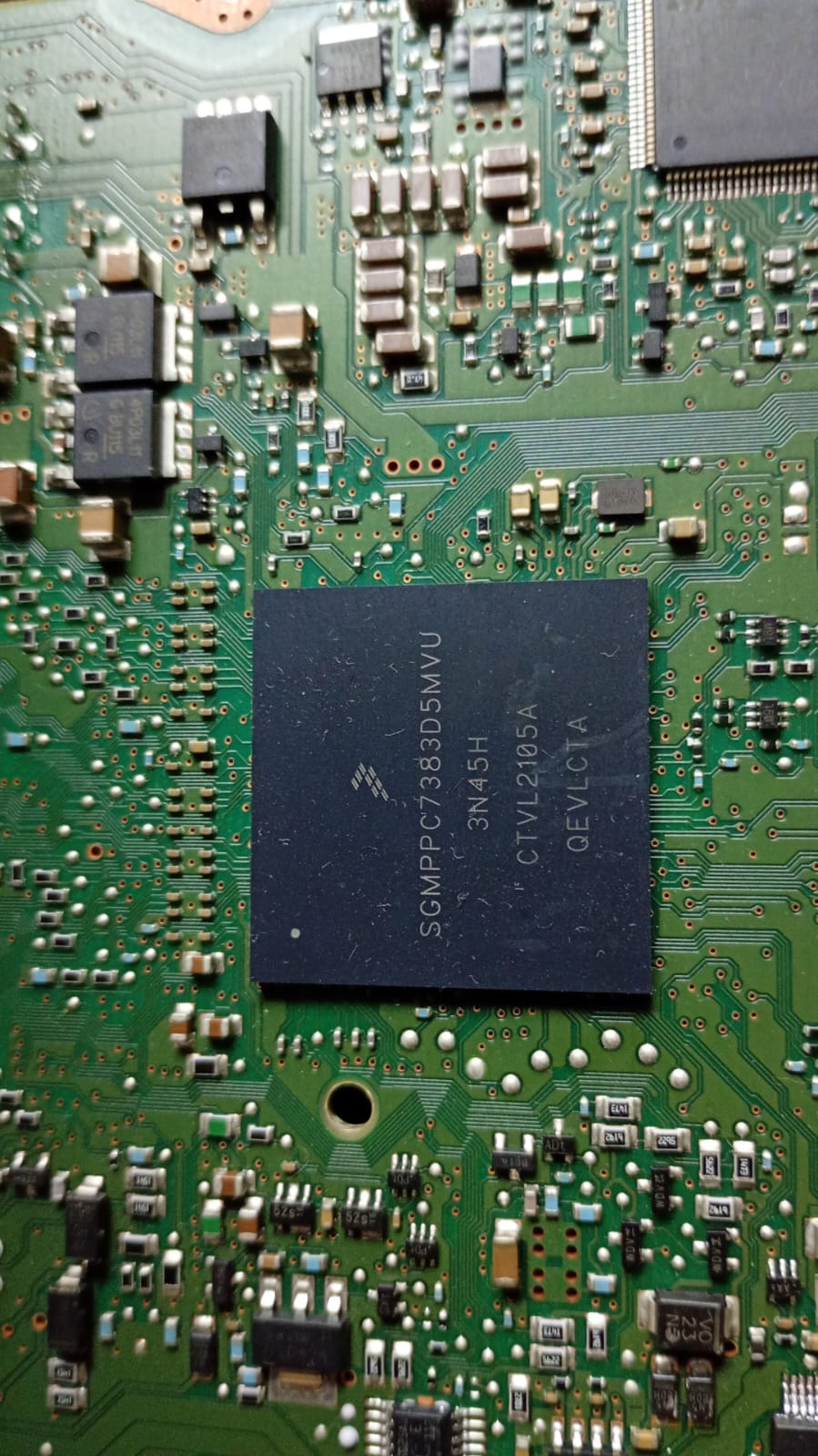

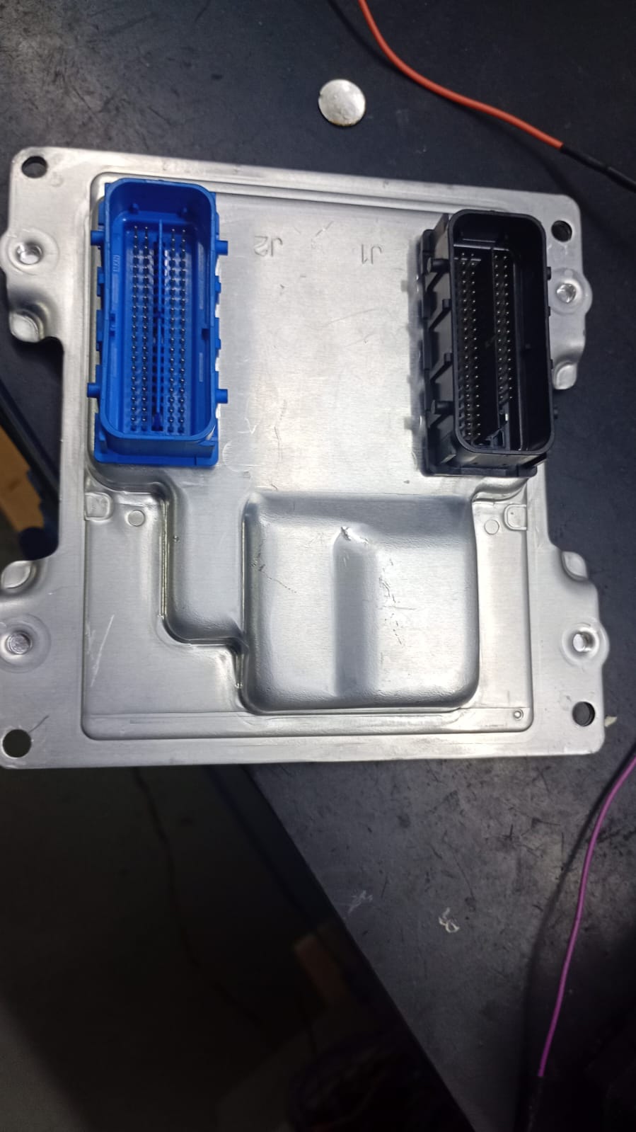

I still don't have a solution, I can't write. I saw the zip file is fine... I'll tell you =). This is the engine ECU, there is still no equipment that can read it, not even Transdata, .flex, Kess3, .Autotuner says there may be a solution at some time... I have only installed a virgin ECU and programmed it online doing SPS... if it is not virgin we still haven't been able to do anything... lots of cars left unused.

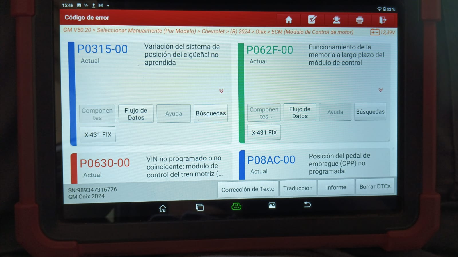

GM HAS NOT TAKEN CHARGE.. IT IS A LOW VOLTAGE BATTERY PROBLEM THAT DAMAGES THE ECU..
ALWAYS THE SAME DTC

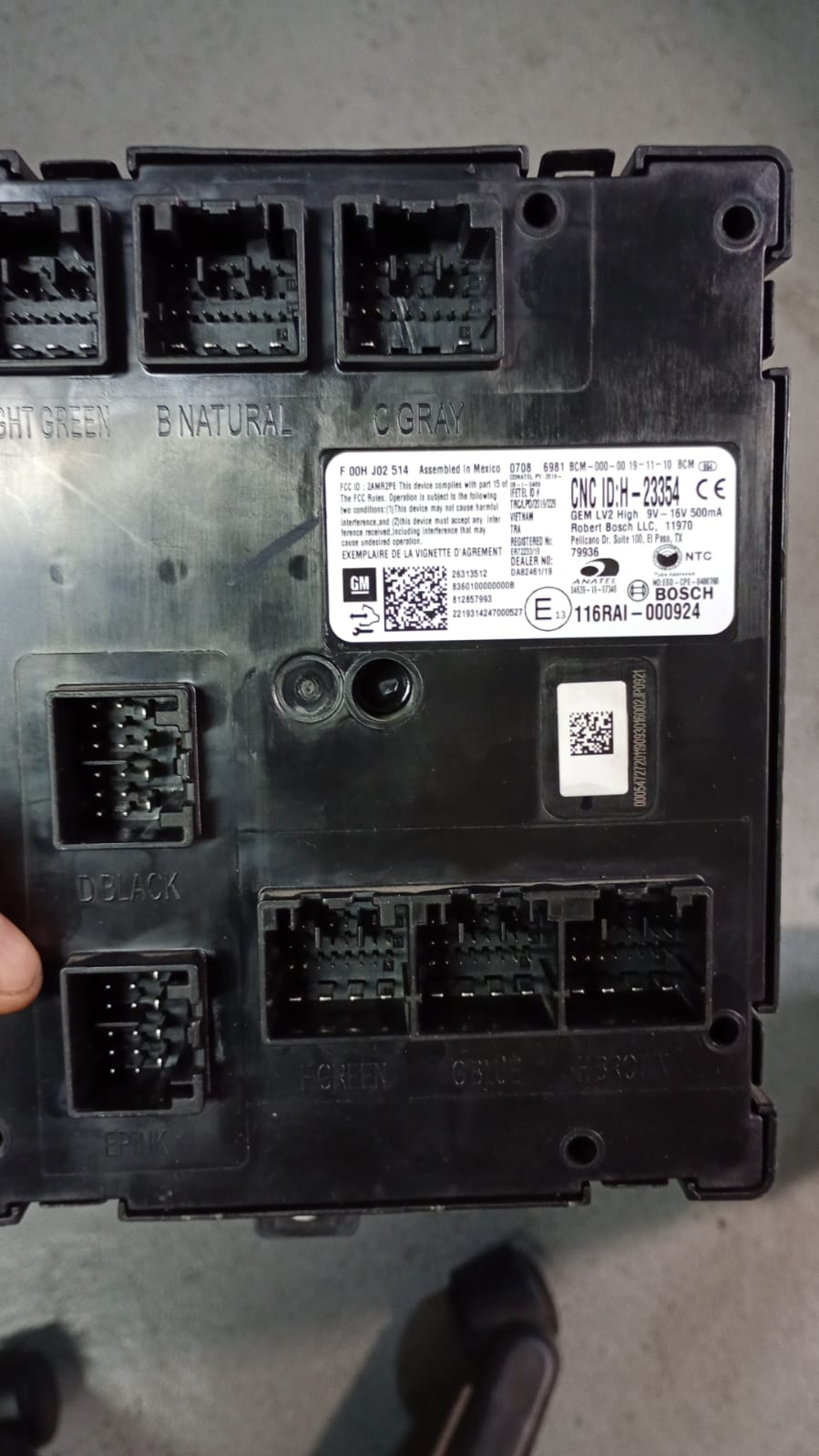

THAT IS THE ENGINE ECU MICRO AND PHOTO OF THE BCM
