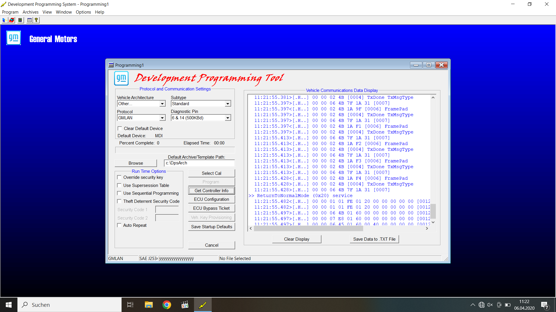

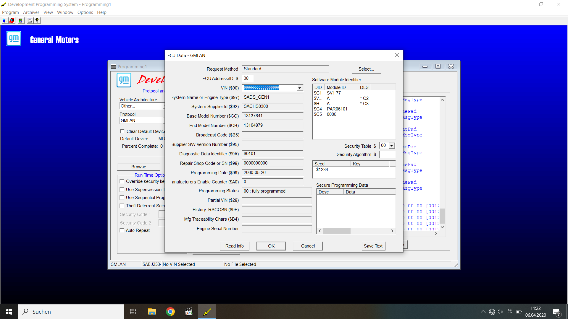

For two. When I connect to the control unit on Get Controller Info or on the Vehicel Communications Data Display. Can I click on Save Data to.TXT File at the bottom right and the ECU data will be saved as a text file under Logs. How can I now program this data to a new or different control unit?
You can't. That's just a log with information on ID numbers of software (calibrations).
It does not contain any program code which you can reprogram other control units with.
As an analogy - you cannot know the whole content of a book by just reading the title.

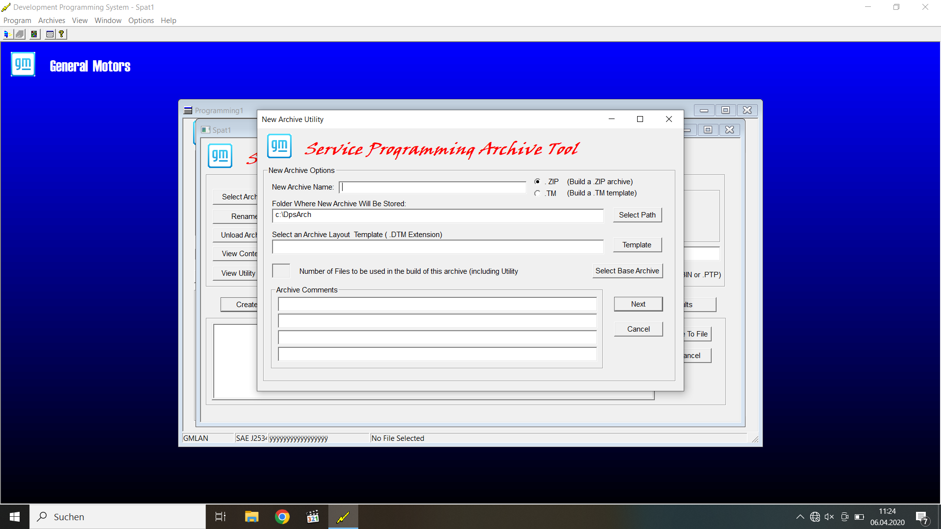

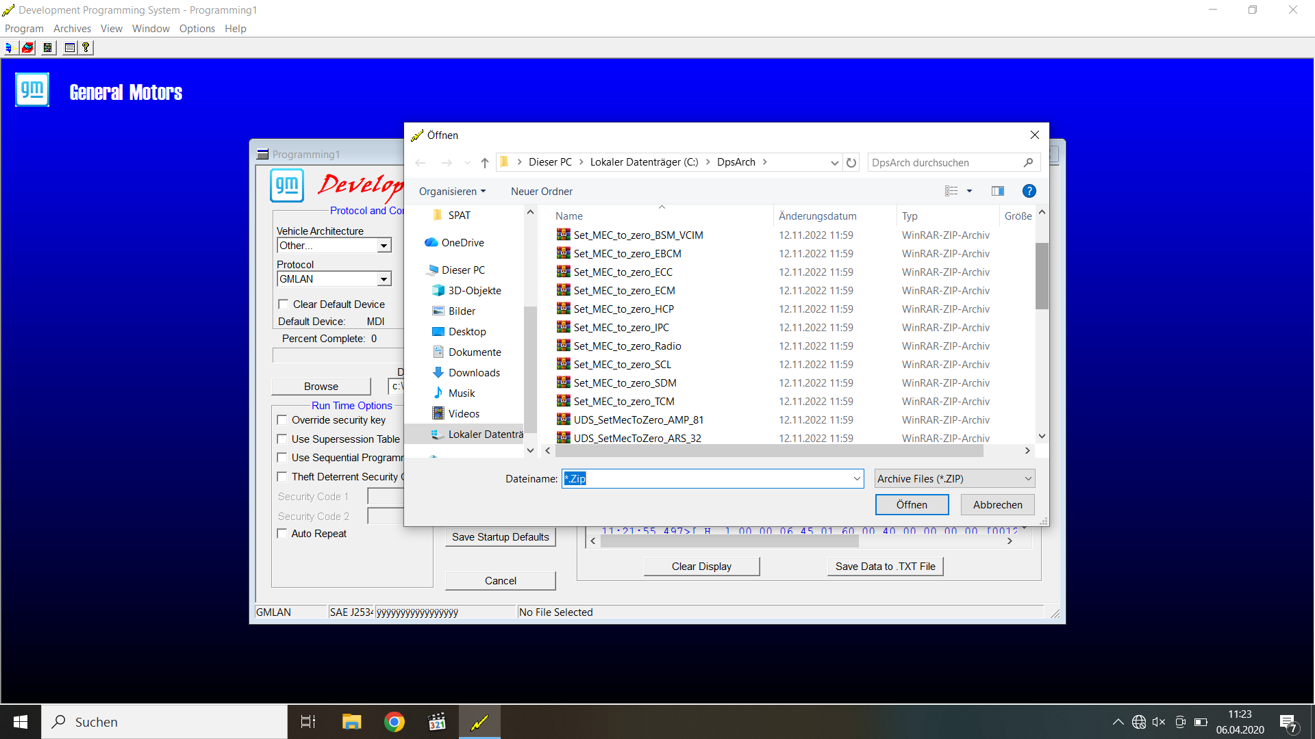

1.In the attachment sreenshots from the CDC control unit read out.
2.The empty files.
3.I had thought I could create my own files in the SPAT of control units that I can read out? There is no software for the CDC control unit via PLC and would like to read, save and program it on a used CDC control unit?

1) You are just reading the "headers" - what software numbers (calibration ID) is currently inside a module. Only the NAME, not the binary code itself.
2) Yeah, these do exactly what their filename says - set MEC counter to zero.
What is MEC - you can read on this forum, or search on the Internet, or read a manual from GM (the infamous GMW3110).
3) Yes, you can create your own archive (that what I meant by "freedom" in my previous reply), but from .BIN blobs from SPS cache folder (after an online session), or from dumping BIN files from GlobalTIS v32 database.

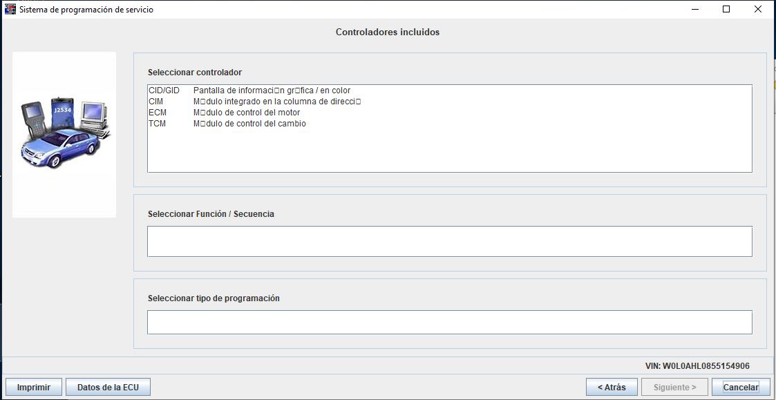

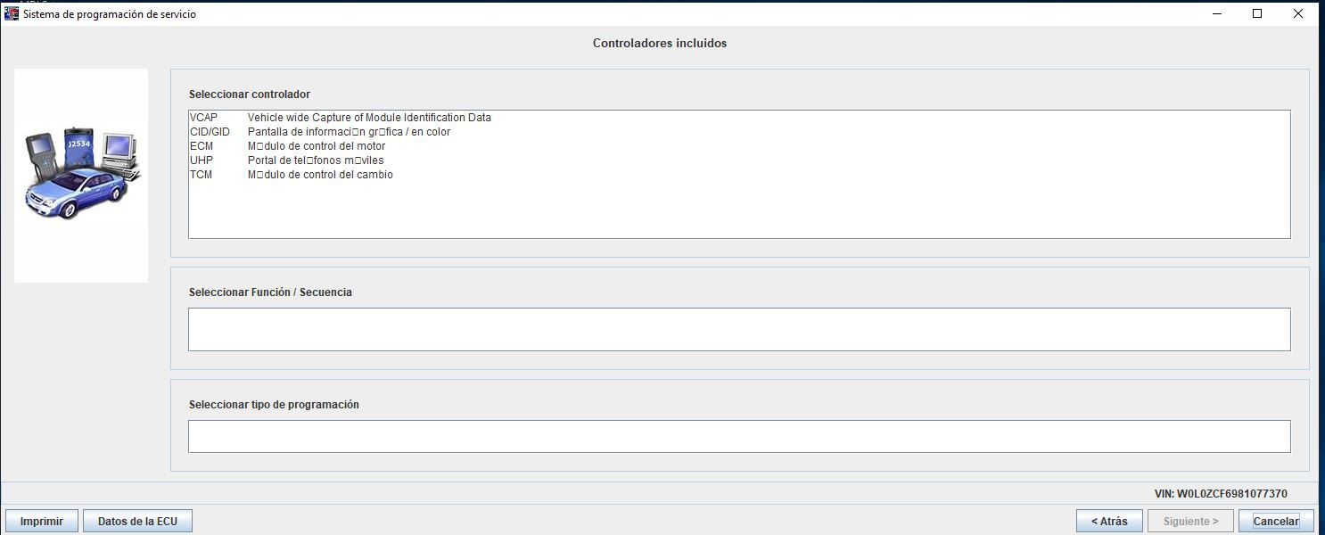

get controller info works in units from Astra H, vectra c.... like CDC ecu 13104879, you will get the diagnostic data allowed by the unit, but if in SPS dont have controllers to use, this controllers cant be programmed using DPS/SPS, i means, if CDC ecu not show in SPS, you cant use SPS/DPS to programm it
Example Vin from astra h in globaltis 32:
Vectra c
