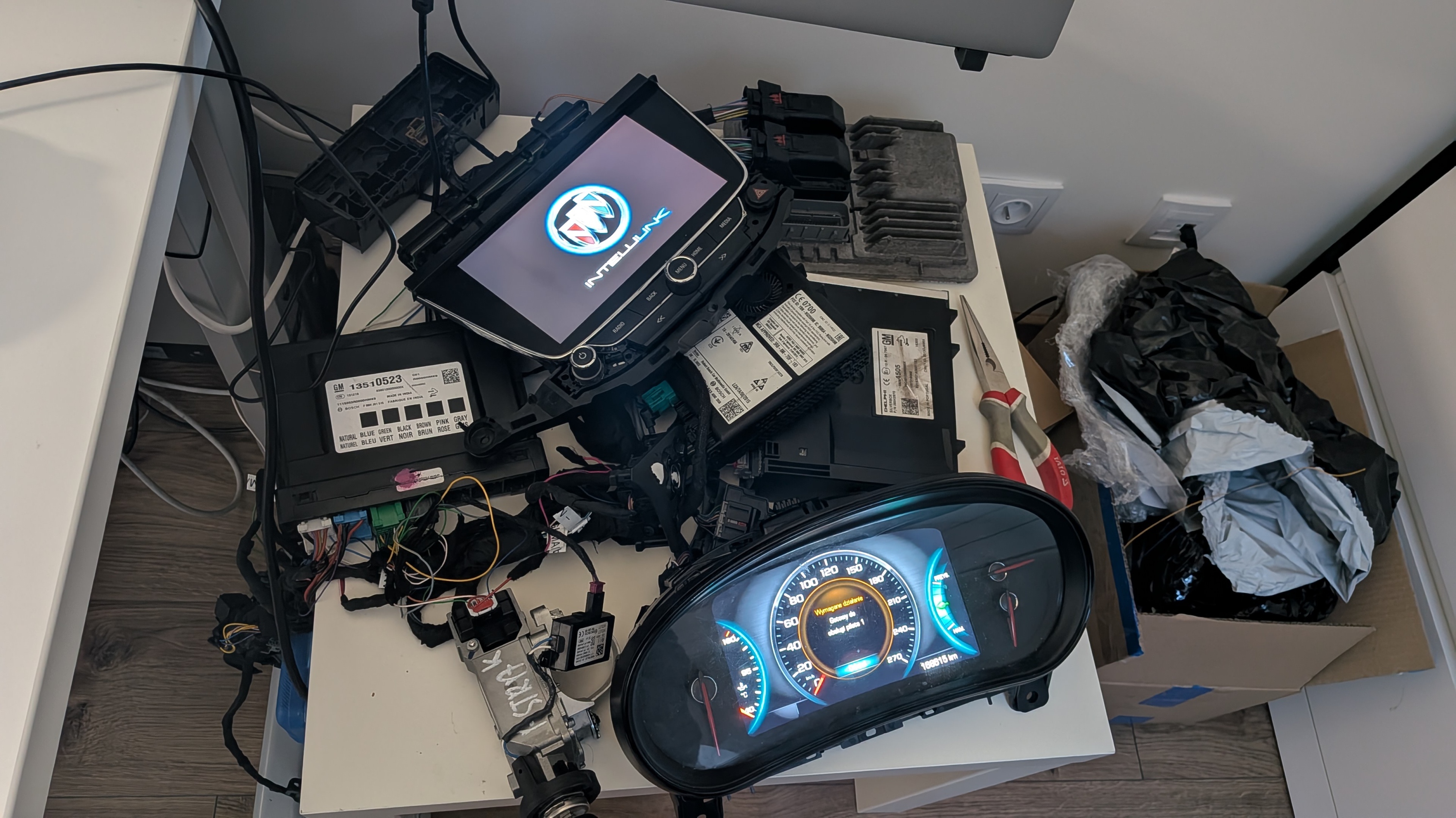

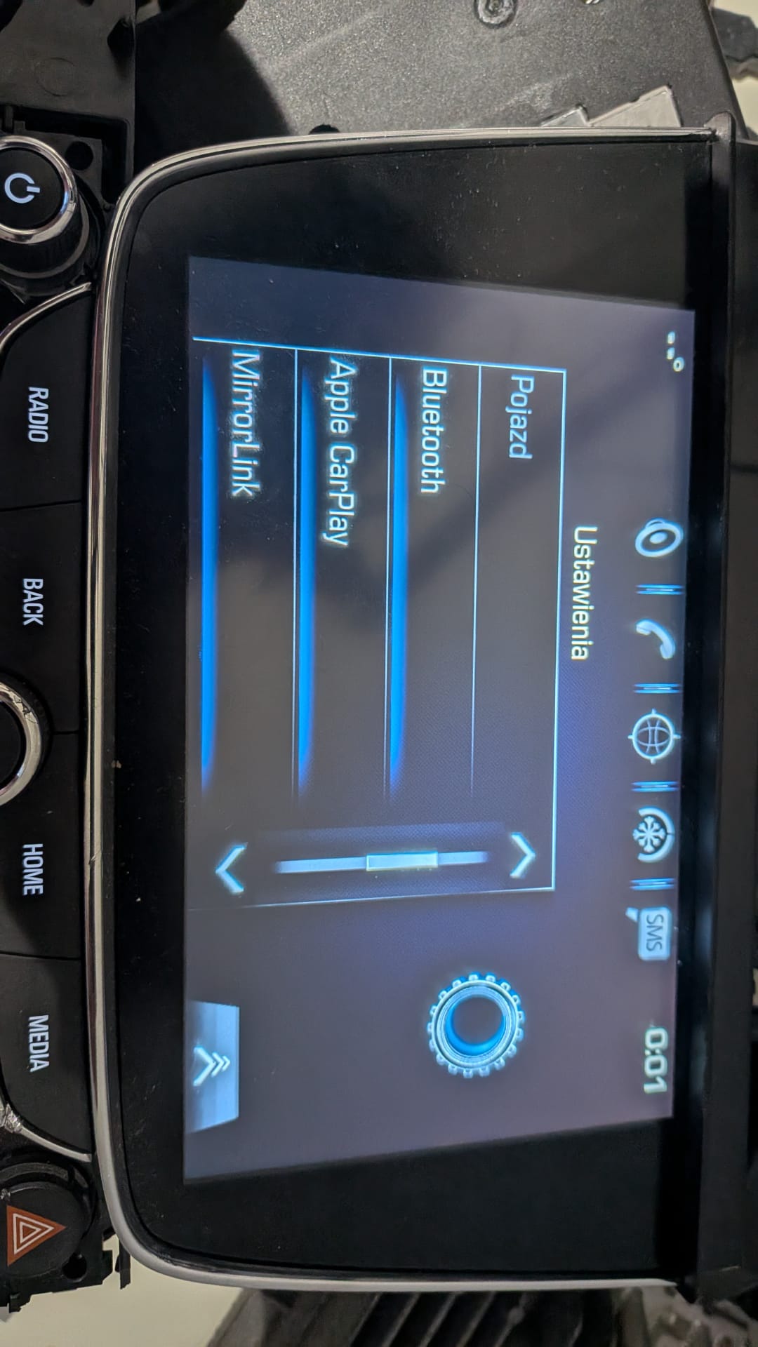

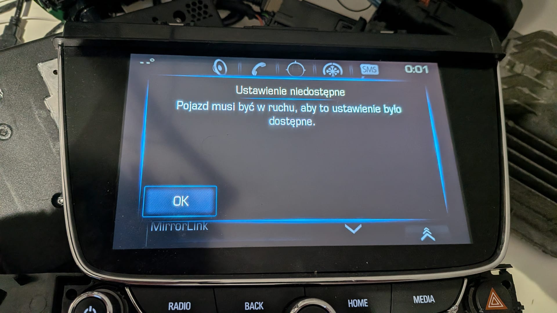

Hello everyone, I've been struggling with a problem for a while now and I don't know how to solve it. I have the IPC, BCM, ECU, HVAC, Silvrbox HMI2.5, and radio display all connected according to the diagrams, unless I've made a mistake somewhere. I can't access the vehicle function; I get a message that the car must be in motion. How do I trick this for this function to work? Best regards to everyone.

    issue is BCM need to know car is with Park brake applied or gear selector in Park position - depend of calibrations for Manual or Automatic gearbox

First you need to know what calibrations you have loaded in BCM and them - either get EBCM and Parking brake button, or get TCM and force to be in Park position.

Open schematics for BCM /parking brake. You will probably have to short one pin to ground - this will emulate EPB in "On" position.
I've already spoken to him privately about this. The vehicle options aren't appearing because he can't power on the BCM. A BCM with keyless calibrations (like his car) can't be set to Ignition ON by connecting pins 5 and 6 of the X3 BCM to +12V or using a non-keyless switch connected to BCM. The BCM won't power on, but if it were a non-keyless calibration, it would work fine.
If you want to emulate a keyless system, you need more than just a keyless module; you'll need antennas, a keyless ignition switch, a start/stop button, etc. I have a keyless system on my test bench, and it works with all the components required for a keyless system. I can turn the ignition on using the start/stop button.
instead, you can change your bcm calibration 2 for one for non-keyless, and you can power on with a normal key

Thank you my friend Arbe_gtc was right, I managed to do all this thanks to his help.
