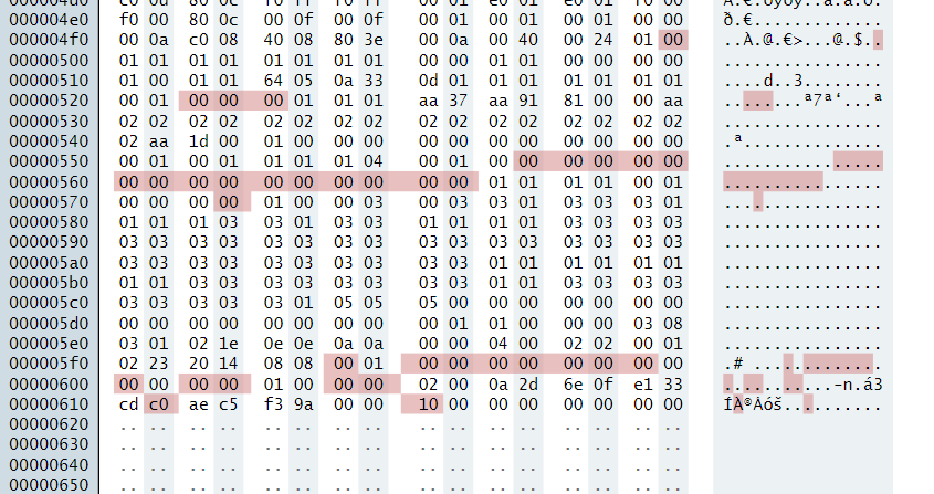

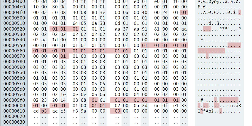

I rechecked the calibrations again, and I had some doubts: is it even possible to activate UJM on the 13582622 operating system? I compared calibrations 13388948 and 13388947. Without UJN and with UJN, respectively, I highlighted the bytes that change when the option is enabled, they are shown in the spoilers.

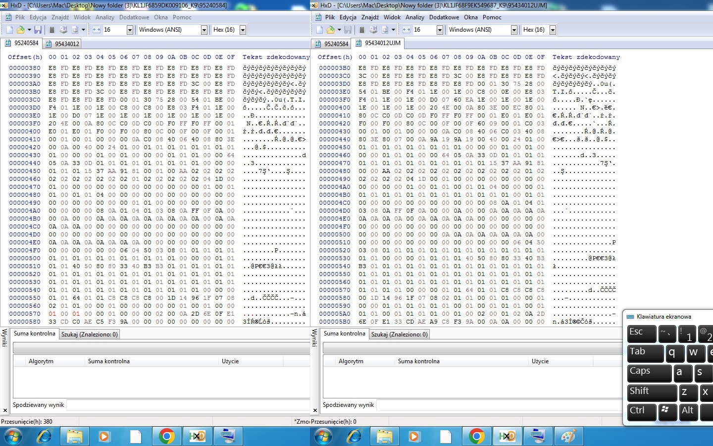

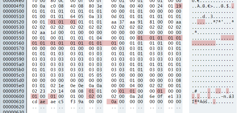

Then I analyzed the calibration of 13451847 from Astra j GTC 2014 with UJM. A similar BCM Continental unit is used there. Although the calibrations differ in overall size, I was able to identify similar fragments, and it seems to me that the bytes responsible for the UJM are the same. After transferring them to my calibration, I received a service TPMS system message, as well as error C0775, which is logical, because the sensors are not trained. But the learning process could not be started, even through GDS2. Hence, I have a question, maybe this software does not support this system at all, or maybe I'm just missing something.

13388947 bytes (UJN)
bytes from 13451847 (UJM) in 13388948 (orig)
13388948 bytes

@alatka asd If the file order was correct, the problem is most likely an operating system mismatch. Simply put, replacing the files won't do the trick. Open it in a hex editor, compare the original calibration with the UJM, and transfer the bytes.
