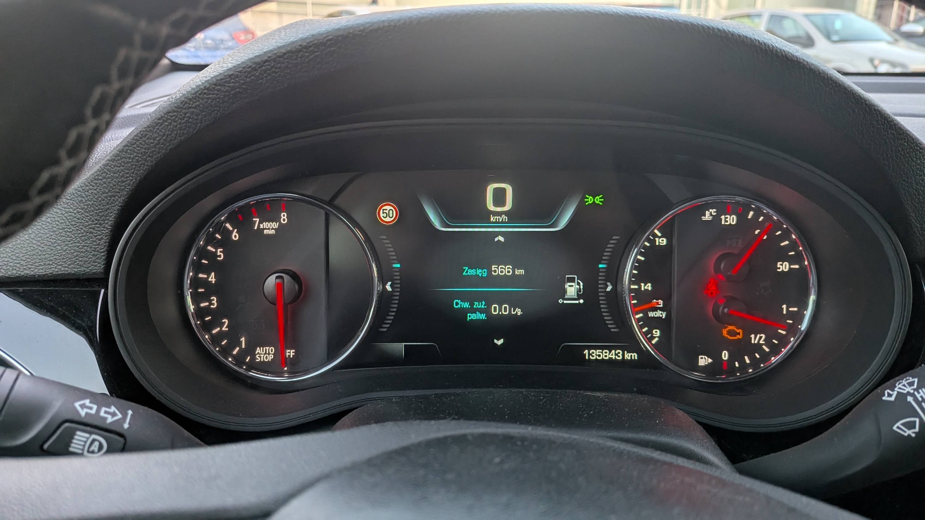

Hi Has anyone managed to enable the oil temperature reading on this small black screen so that it shows the real values in a 2016 Astra K 1.4 turbo 150 hp?

There's no need to install additional sensors. Oil temperature is calculated by the engine control unit and transmitted to the gauges. I did this mod in a 1.4t Astra K, and it works.
Could you please describe how to do this? Does it require ECU programming because I have a map already made?

Do you mind sharing how? I have currently got an ESP32 reading the calculated temp from the ECM and replaying it the the cluster, it works on the bench but it's not pretty.
Need to test on the car but if it can just be coded even better - from my research it seems it's just masked by the BCM as the IPC get's the info?

I can check it out at my place if you tell me exactly what to do. I have my BCM files, so I can send them to you.

It'll be good to know. I've fitted a UHS to 1.2 turbo engine on Astra K and the oil temp gauge is already working and I understand there isn't even a sensor for oil temp, so it's all in ECU. I assume that there are certain bytes used to activate it. My astra k is 1.6 turbo with e80 ecu.
