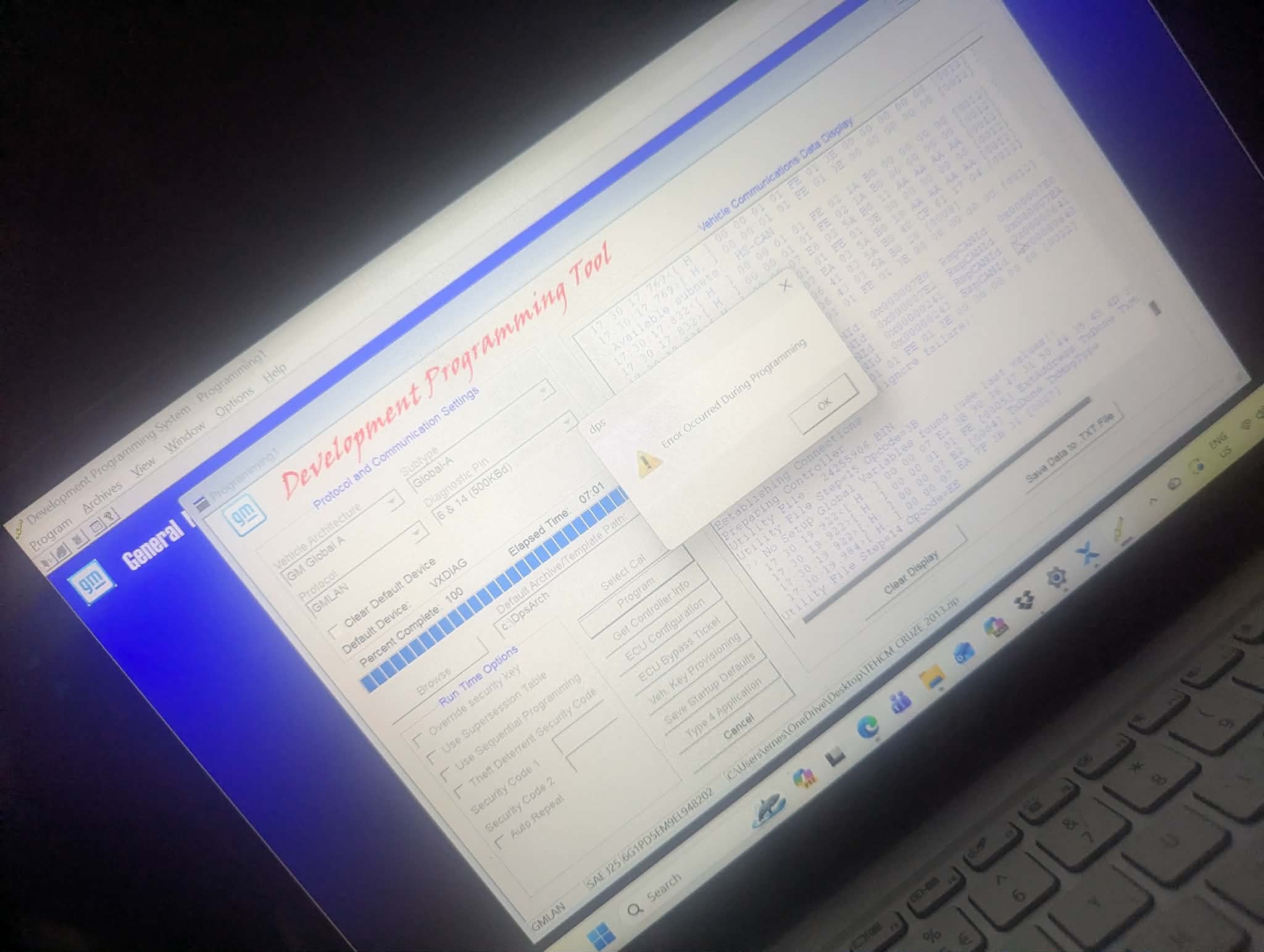

@Troy  It finishes 100%, but errors out afterwards. i have tries reprogramming all other modules just to test, all seems to be successful.

DPS states 100%. That means the module was fully programmed with the calibration files. That error is not important.

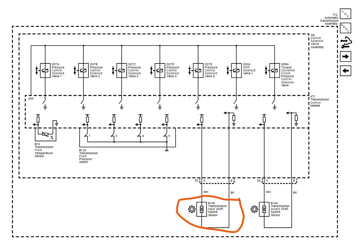

P07BF is about sensor error. You cannot fix that with programming.
DPS have flashed software to TCM correctly, but fails at writing VIN.
I have modified your utility file, so you can retry with writing VIN again with wasting time with flashing CU again.

Car being on limp mode might be just the faulty input speed sensor and the transmission not had been properly bled(with getting the trans temp to 85°C - 105°C then opening the bleeding plug whilst the ending is running and topping it up with fluid till it drips there)
