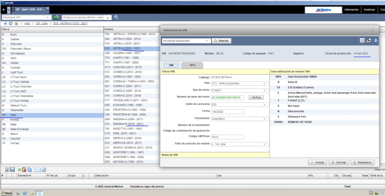

Okay that makes sens. No i dont want to buy thinks for this. I thought i can try my Programm skils with this, without need more Hardware. By the way did you know an good EPC? Thanks for the clarification.
GM EPC until 2023 for VMWARE, include Opel. Astra K, Insignia B...
epc.txt
