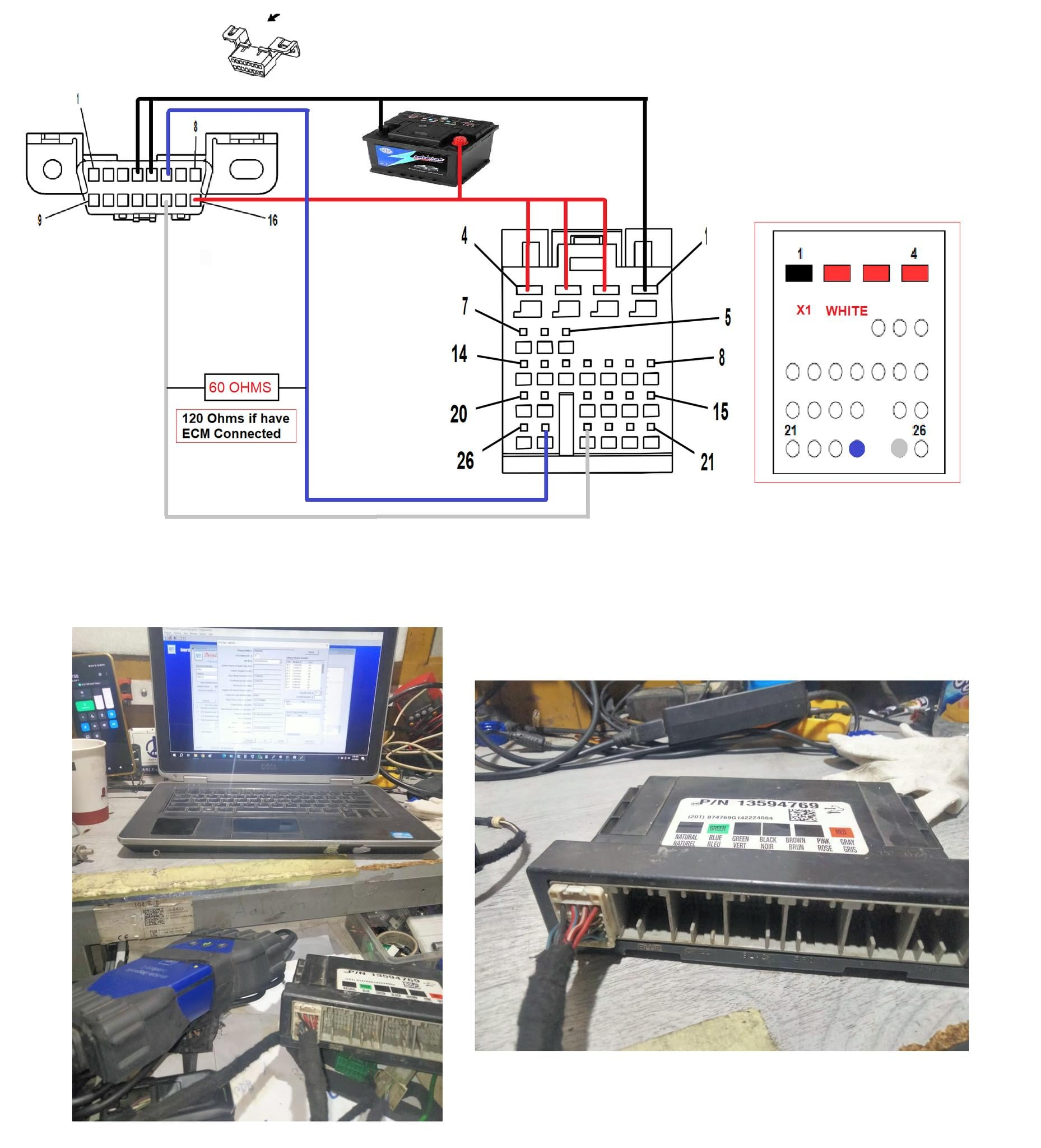

hi can any tell me the diagnostic pin and the ecu id address for astra j bcm. got the dps file put cant find the bit that tell u the diagnostic pin and the ecu id must lost it when i swap laptops thanks

BCM 40 HS
CONNECTION
