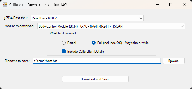

I've written a full BCM reading application and I've taken EFI-Live calibrations and manually converted them to DPS. It's possible for sure, it can hurt your eyes doing it manually lol.

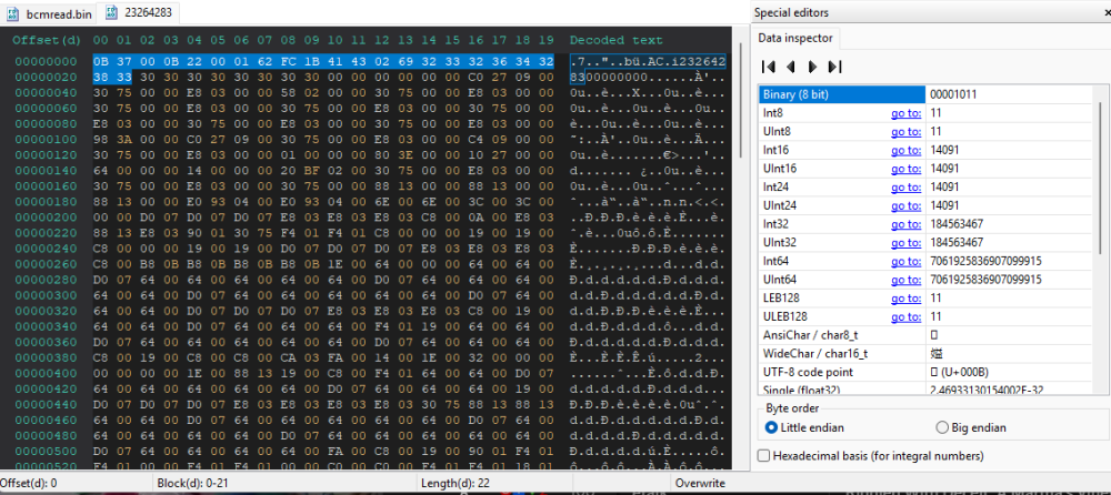

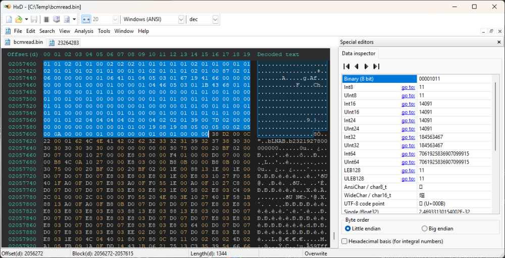

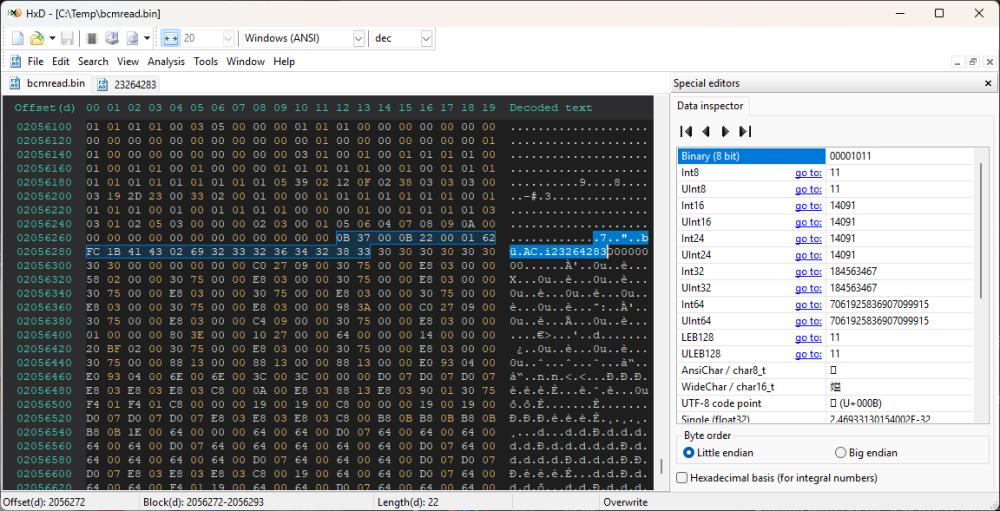

Thank you! I've put a LOT of time in hahaha. You are correct, you need a hex editor to do it. I could technically throw an app together but I haven't needed it a ton of times. I'll show an example, you can see the BCM Read file which is a full BCM dump, then a calibration (might not have pasted in the right order but you can see the filename). This is an easy one as everything lines up. After the operating system, there's a lot of blank space of course and in the OS, they likely say what size and where they want to read each calibration from. When it comes to DPS, it's all up to the utility. They're putting the addresses in that they know they have their module reading each calibration from. So in some cases, you may have to modify or build a new utility file with different addresses. Also, in this case, the checksum is actually in the BCM flash as well. It's used internally too to ensure no corruption happens after even when the module is programmed, so it'll come out with the read.
