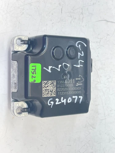

The 2022 Cadillac Escalade Sport has a steering column lock. It has a module as well. You will have to check if it has a VIN as well. If so then there is a VIN mismatch.
Get the wiring diagram.
2021-2024 CADILLAC ESCALADE ESV STEERING COLUMN LOCK CONTROL MODULE OEM 13551011 - Picture 1 of 4

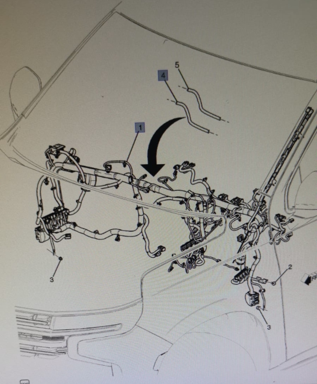

Also, I believe this is not a simple plug-and-play installation and would likely require replacing the entire main wiring harness, not just adding the module and programming.
