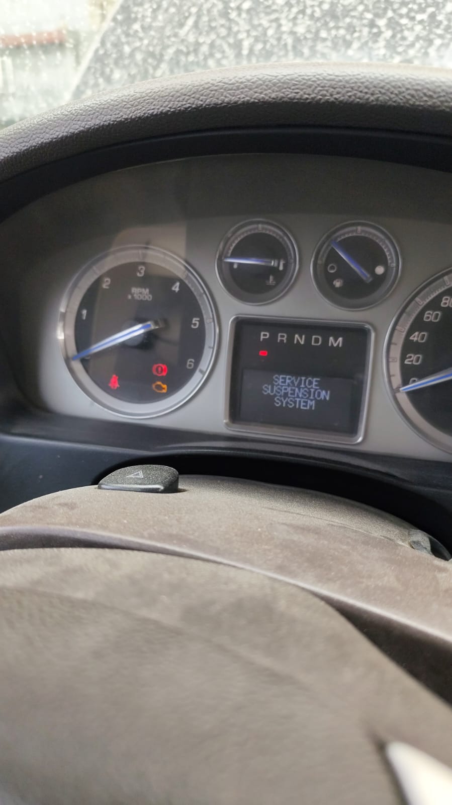

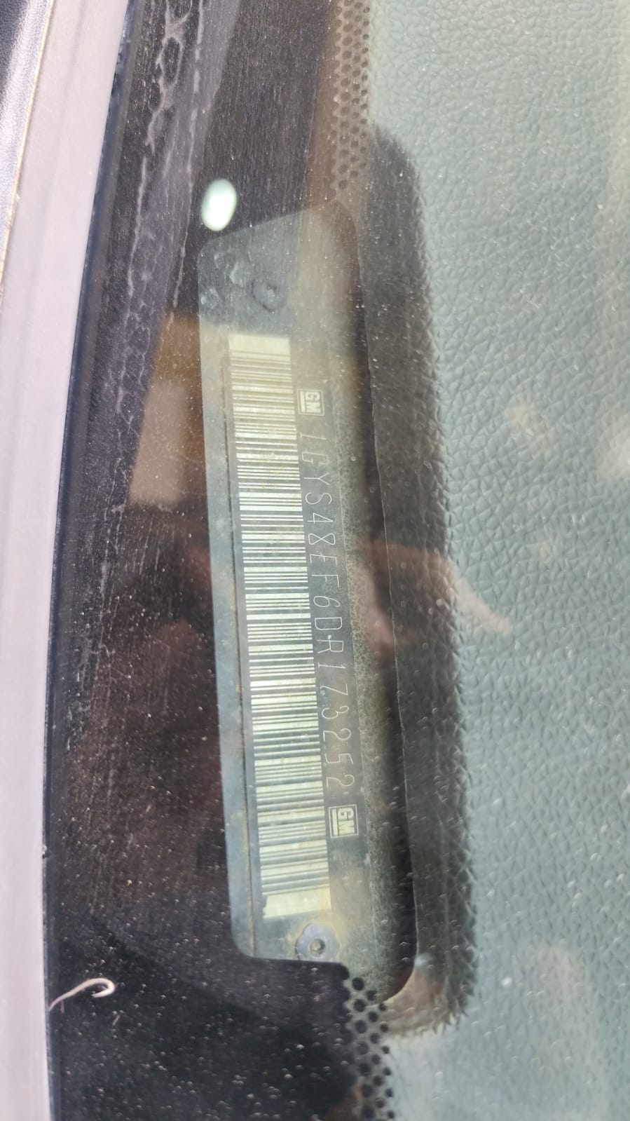

hi everyone i need to remove (service suspension system) from instrument cluster the vin number i uploaded
Cadillac Escalade 2013

I think you have a few options.
You can flash the BCM with the correct calibration file to remove the electronic suspension module, or you can flash the IPC to remove the error.
On a 2009 I just changed the BCM calibration so it wasn't looking for the suspension module and throwing an error.
In the first option did you have calibrations file without any suspension module
Yes, In the BCM cal# 10 is the one that needs changed.
Try this one. I'm pretty sure I removed the suspension controller from the BCM.
1GYS48EF6DR173252-BCM.zip
I downloaded and wrote to the bcm but the control dead now and showed to me message
Error
Now I want to download the right files with same vin
I'm not sure you did it correctly on your end if that file didn't work.
Here is the stock calibration
1GYS48EF6DR173252 - Stock-BCM.zip
Thanks bro I really appreciate your time to solve my problem ☺️ ☺️
