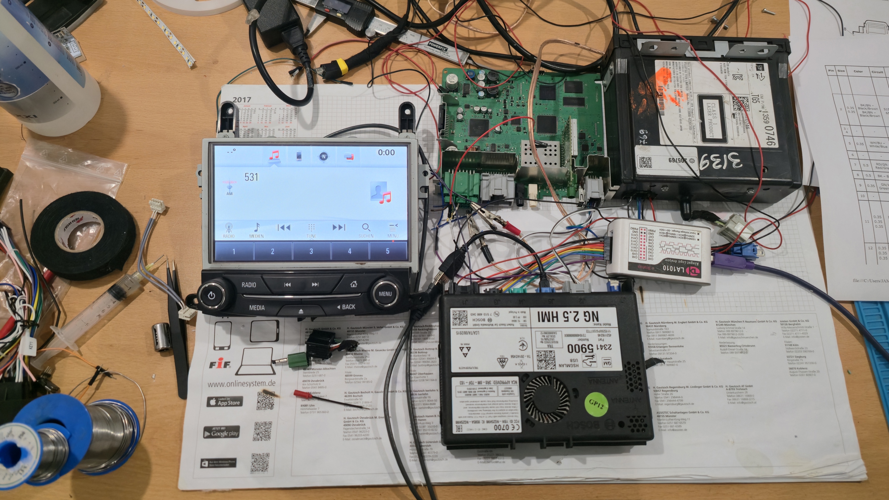

    Hey, I want to share my setup. Its a littel bit Sketchie but its works. Now i can hack the hmi. The Flash from the silverbox i have dumped Successful.

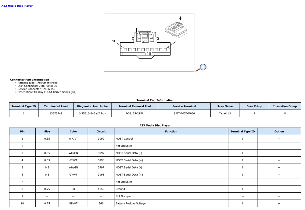

Does anyone have an pinout or diagram for the Media disc Player Modul? I found the Most connections and the Power rails but the disc Player need an extra pin to ground to turn on. How is this switch pin provied in the car?
Hey,
