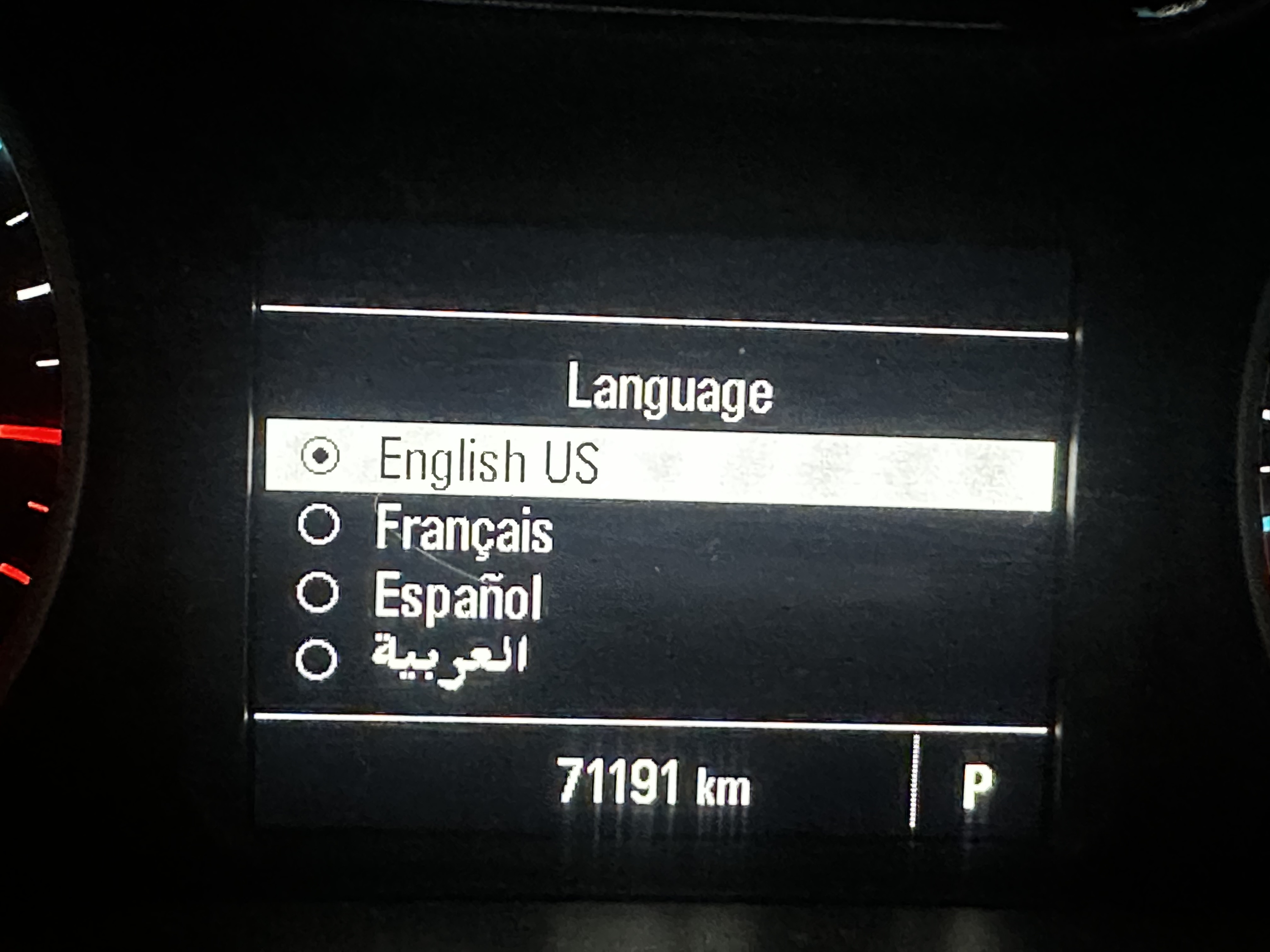

Hi everyone! Can anyone tell me how to add the required language to the IPC so that the selection appears as in the picture? I learned how to set the default language, regardless of the HMI, but now I'd like to add Russian as a language option.

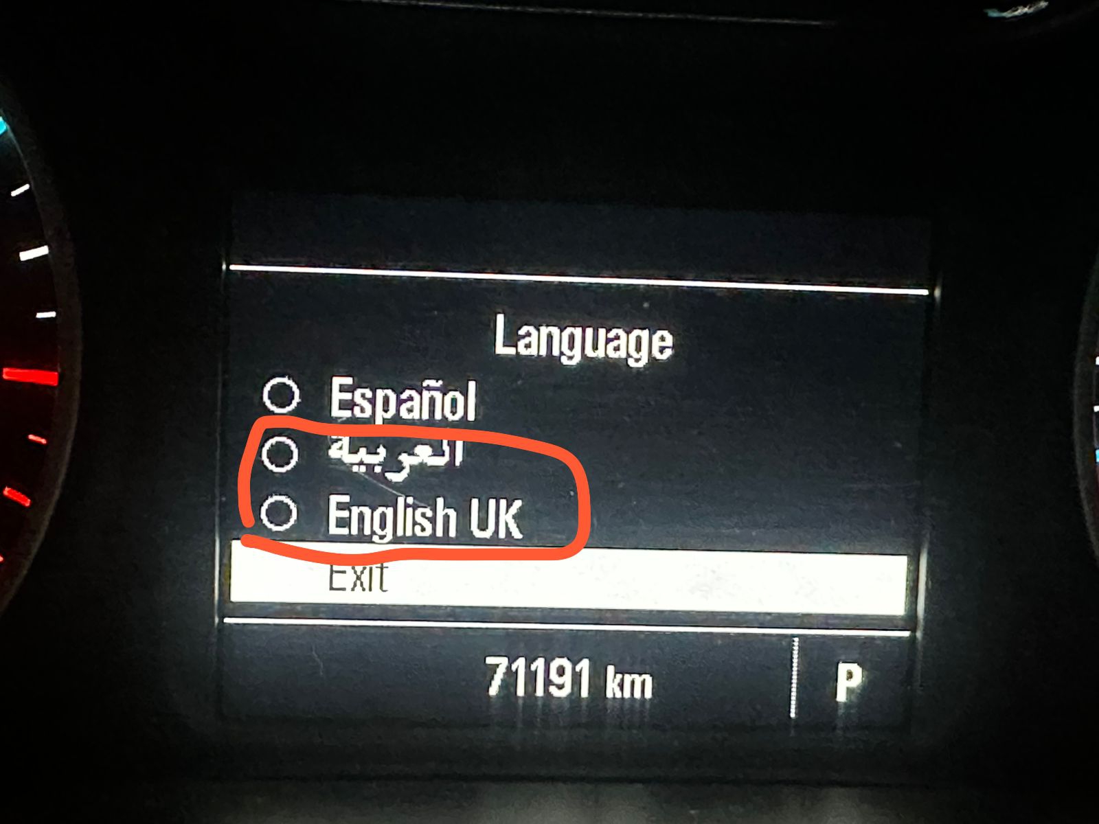

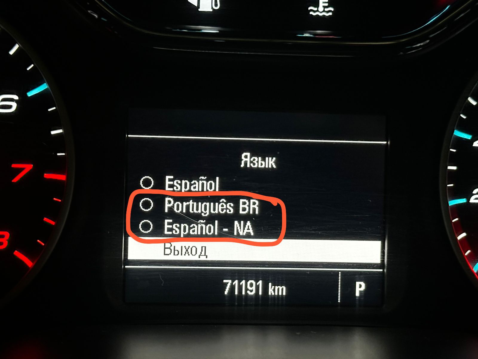

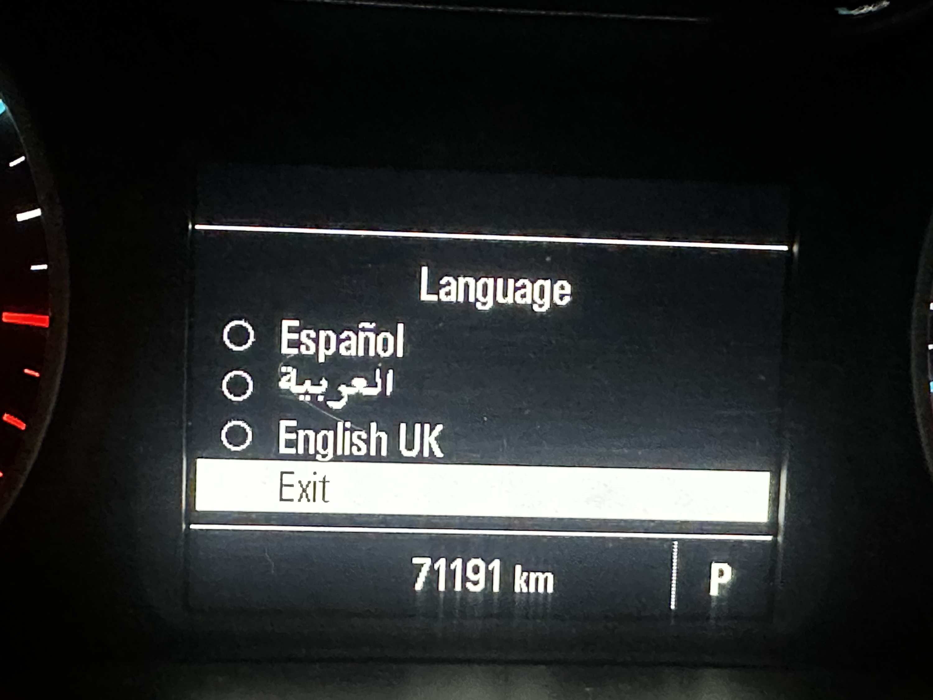

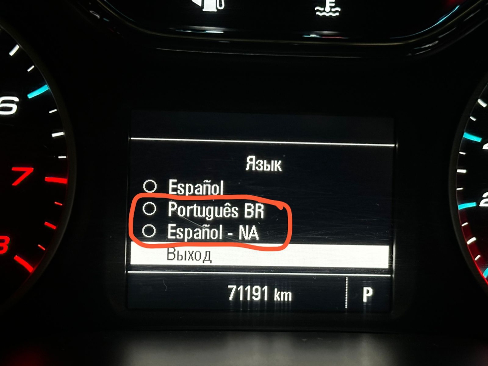

I set Russian as the default language, but it's unavailable in the language selection menu. Also, with certain changes in the XML file, Arabic and English (UK) are replaced with Portuguese (BR) and Spanish (NA). I can't find the connection yet. It's most likely related to RPO codes, but I've added a different RPO code, but nothing has worked so far. I'll investigate further.

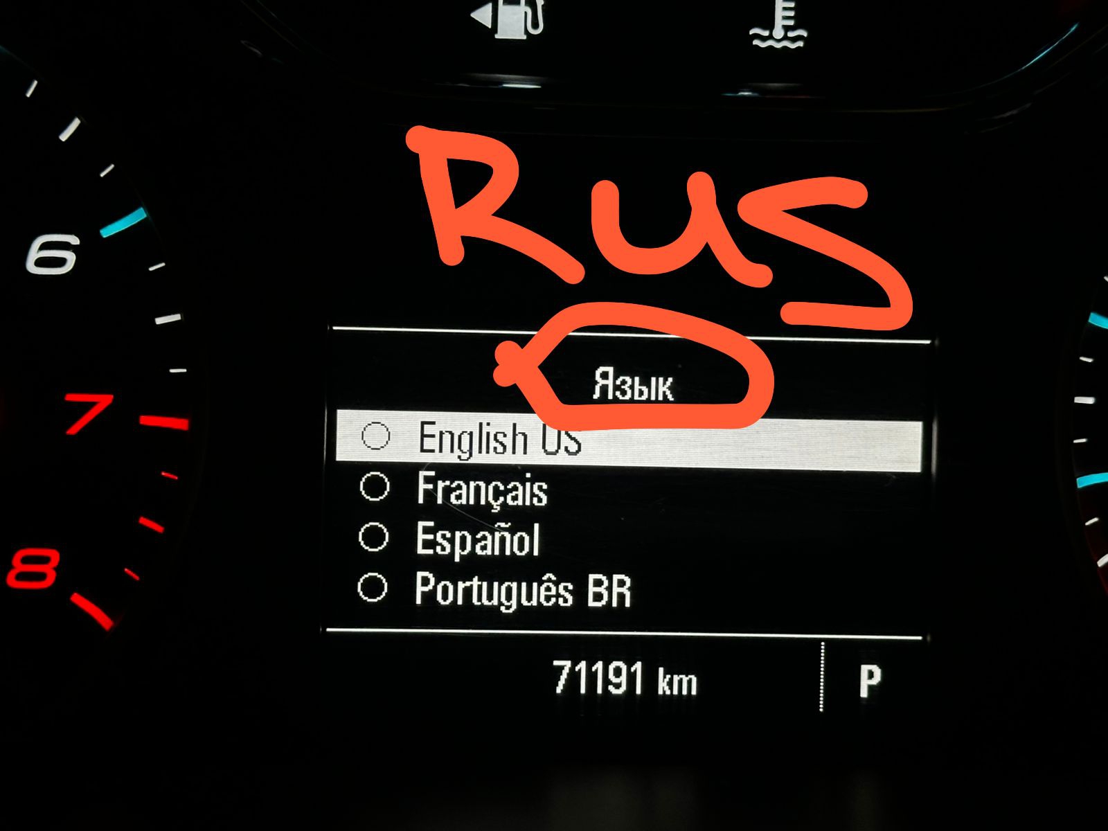

My HMI is programmed for Russian, and the entire system is translated. However, I encountered a problem with one car where the standard head unit was replaced with an Android one. The Android system translates the IPC into Chinese. I found a setting in the IPC via XML to set Russian as the default language, regardless of the HMI/Android language setting. However, I would like to add a language selection option, as I showed in the screenshots above.
There's a language selector in IPC. I want to add Russian, but I haven't found a solution yet. If anyone can help, I'd be grateful.
