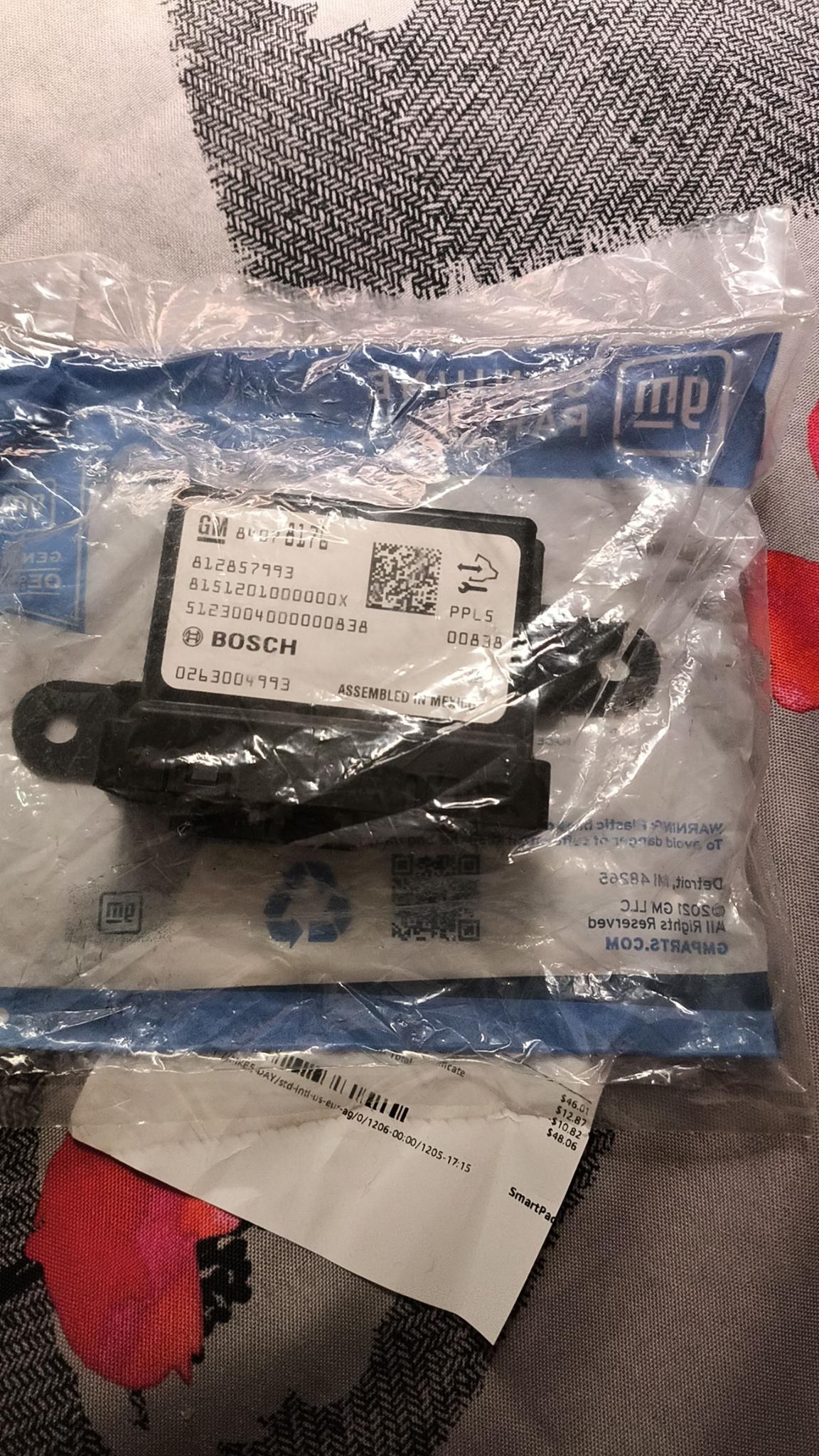

I bought a brand new PDC Controller and it is installed in the vehicle.

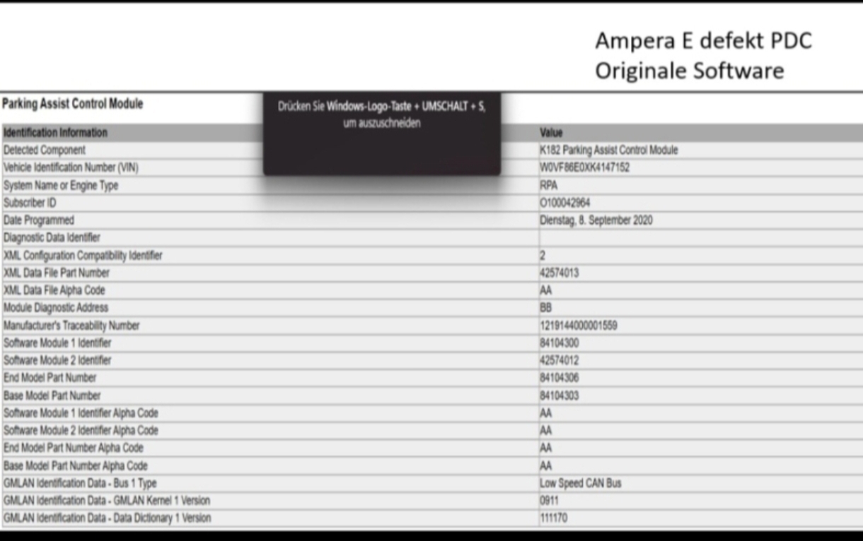

Below you see the GDS2 report of the PDC K182 module.
This was my sw level.
Option code UD7

Hello Pupu14,
yes GDS2 was working.
So we were able to read out the vehicle and erase trouble codes.
Somehow the vin is not detected by Opel SPS but by GM SPS
