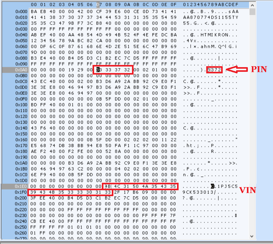

i read a bcm eprom from cruze 2010 from europe but the pin security code FXC7 is possible anyone see if real pin the vin is KL1PM5C69AK515074.
i try program with sps but give me error E6220 .

change pin to FF FF FF FF, you can change vin it not match to vehicle , then do sps
techline do no let me conect to the car i think is because from sul korea.
