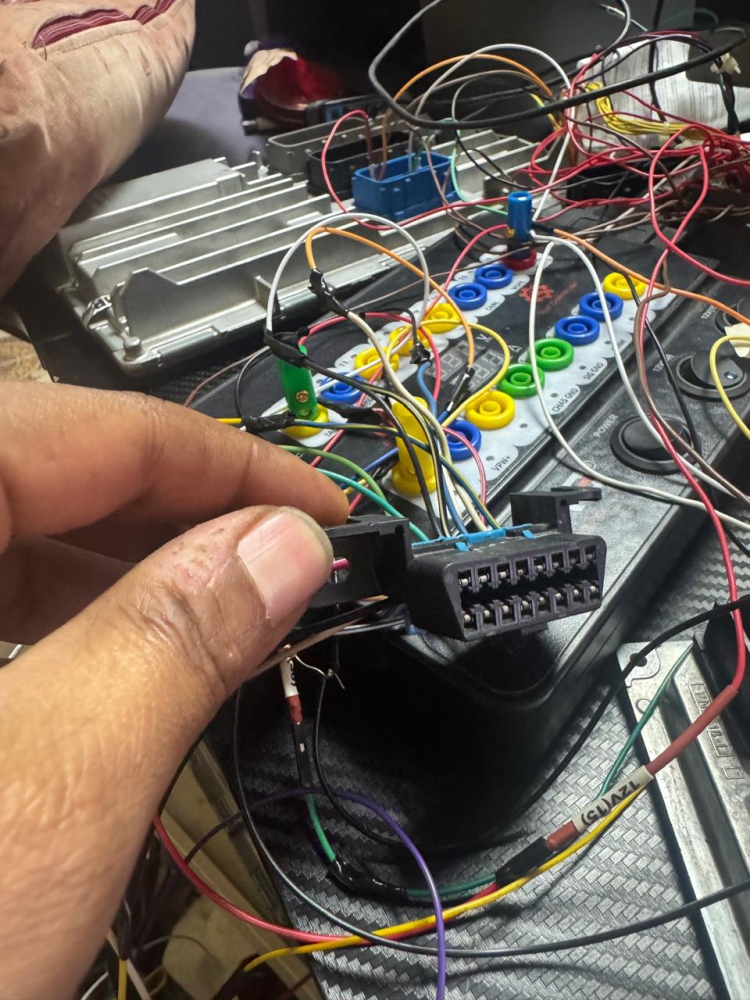

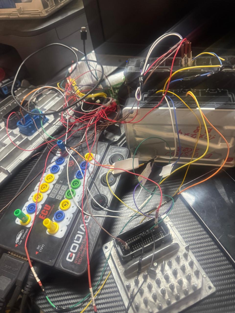

i have T93 tcm E90 ecm Global b
in DPS work good w GATEWAY and BCM and godiag gt100
i trying to connect to Mpvi3 HPT
But it doesn't work Bench
Does anyone know how to connect the wires to make it work for me Mpvi3 HPT?
THANKS

    add serial data gateway module ang follow data communication schematics, if by DPS ok, it must same as HPT, try add 120 ohms resistor on ECM high speed data

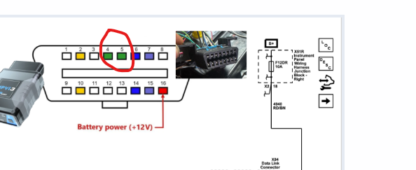

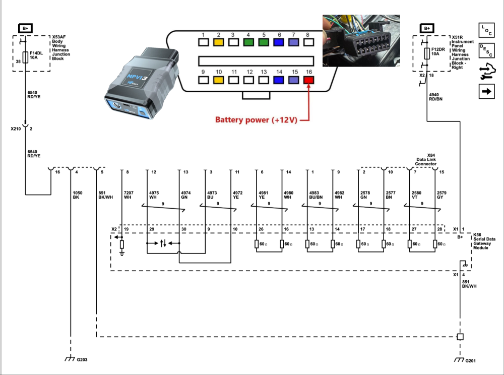

image.png both connected?
yes both
4 and 5
Ground
