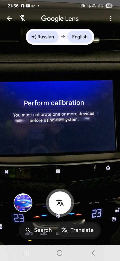

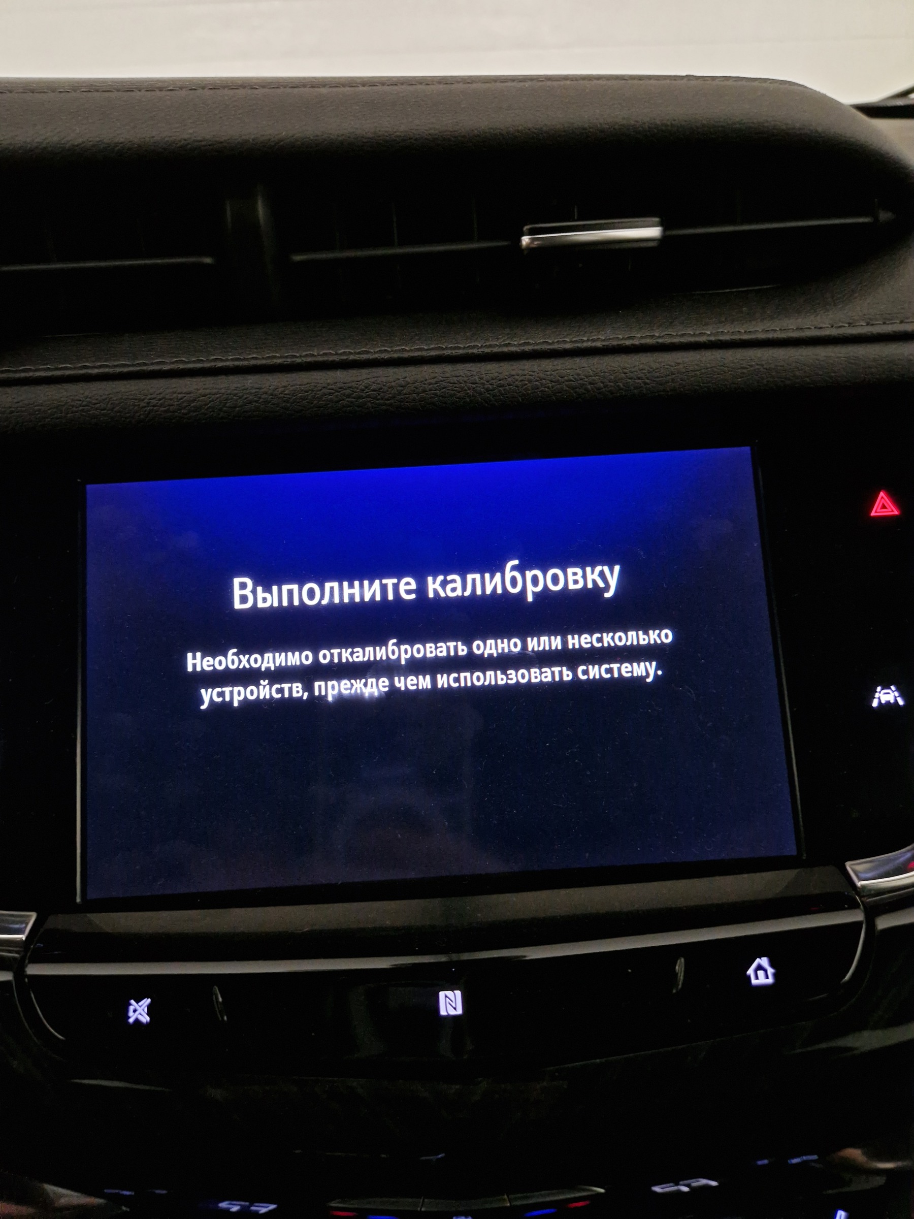

I was trying to change the language on my A11 radio module.
So I grab calibrations from my vehicle and EU model and replace only the language cal file, the other files remains unchanged.
Programming succeeded, I can see Russian language on IPC but radio, navi and whole CUE does not work.
CUE says this: "Perform calibrations. You must calibrate one or more devices before using the system.
Could you advise what other devices I must re-calibrate to get this working?
