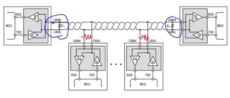

Must be ok. Sps works fine
@tobiasp
Yeah, resistor matters only on bench. Inside the car - everything is done at the factory..
