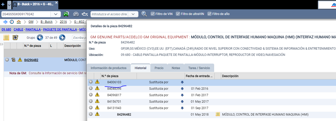

  • This vin is from corea: VIN: 1G1155SA7GU134038 CW1 PAÍS COREA (NO SUMINISTRE PIEZAS A TH) IO6 SISTEMA DE INFOENTRETENIMIENTO - DE GAMA ALTA CON CONECTIVIDAD Y SISTEMA DE NAVEGACIÓN INTEGRADO are you s
do you have vin
2 minutes ago, GM-Enthusiast said:
do you have vin
Buick Regal 2016 2G4GS5GX0G9179242
Buick Regal GS 2017 2G4GU5GX8H9188413
Buick Regal GS 2020 V6 W04GS6SSXL1017228
are you sure its IO5?
Try this:
