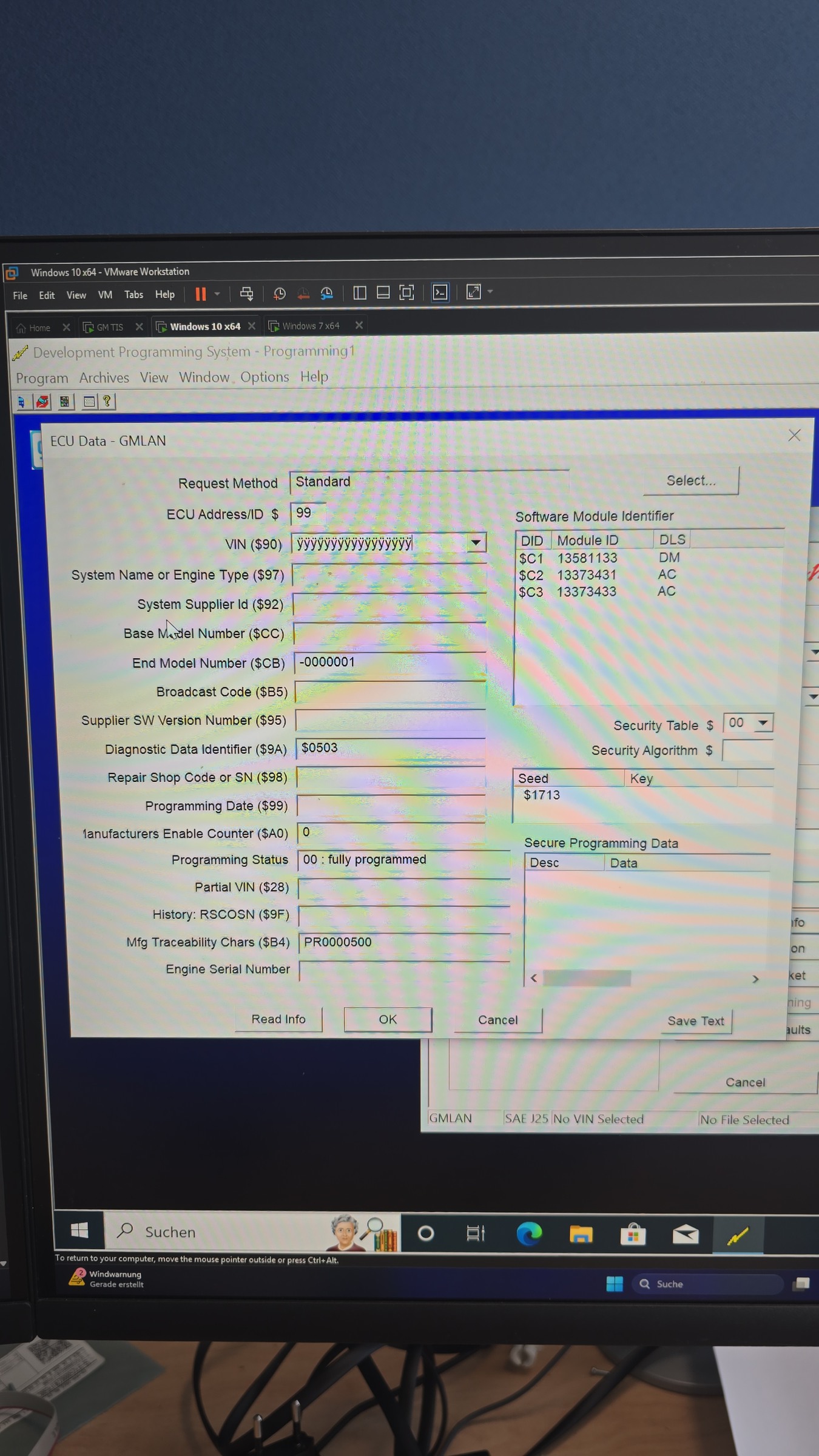

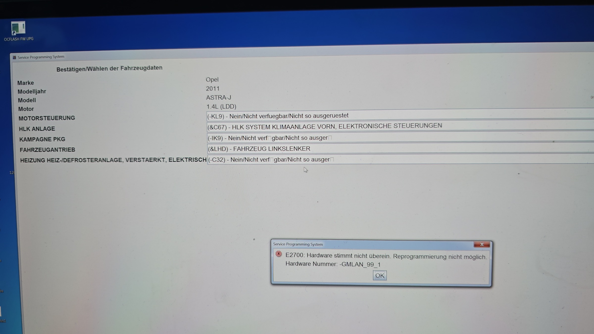

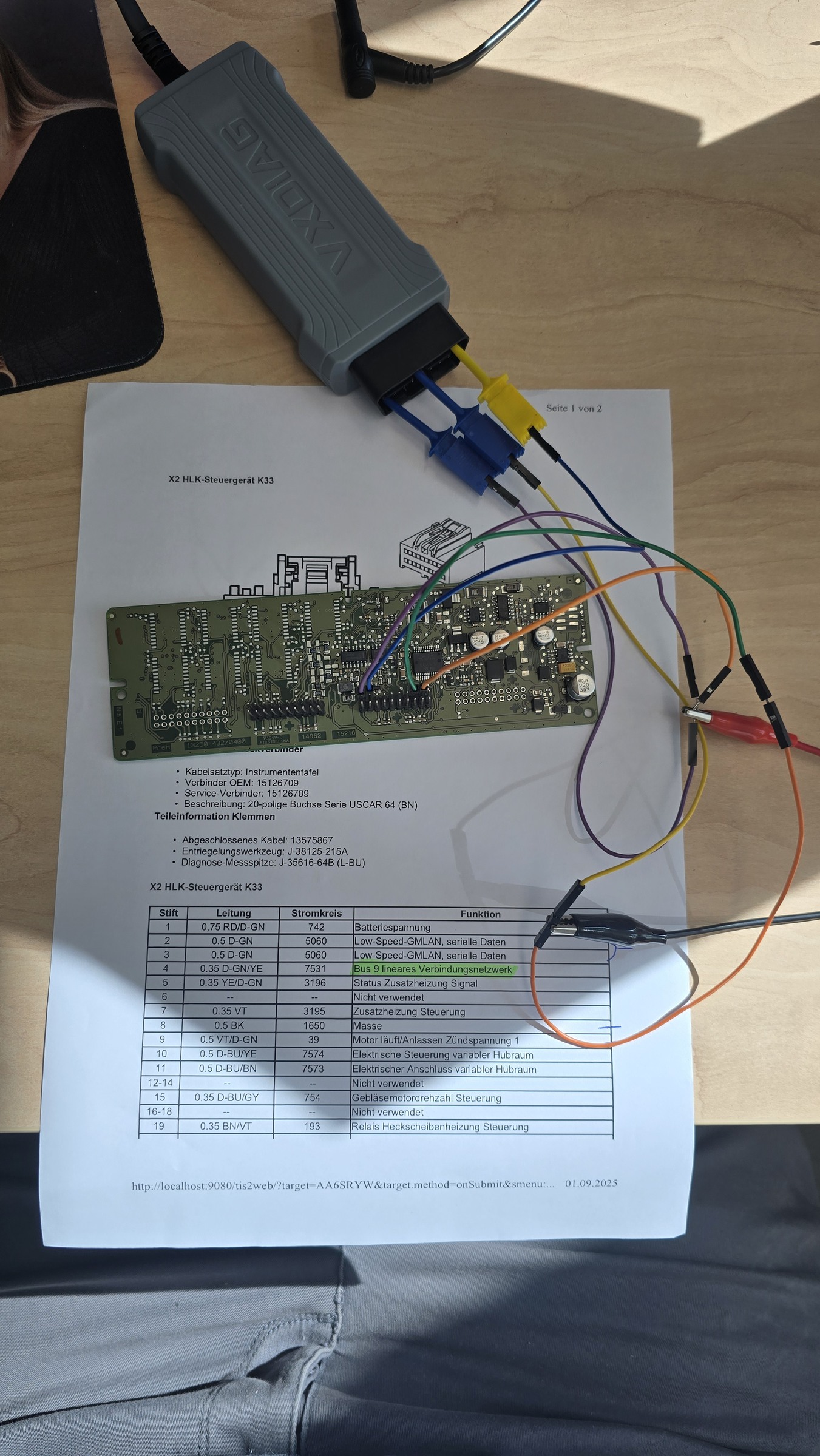

I have an ECC in my astra j 2011 which cannot be programmed via sps. Under dps read out I see that no part number and no vin is programmed. Have you ever seen something like this? I have a complete eeprom dump.

ÿÿÿÿÿÿÿÿÿÿÿÿÿÿÿÿÿ is unprogrammed module, hardware mismatch
See at CB and CC
That appears to be a damaged EPROM or corrupted firmware. You could try dumping the EPROM chip bin file from a working ECC, then program that ECC EPROM chip.
