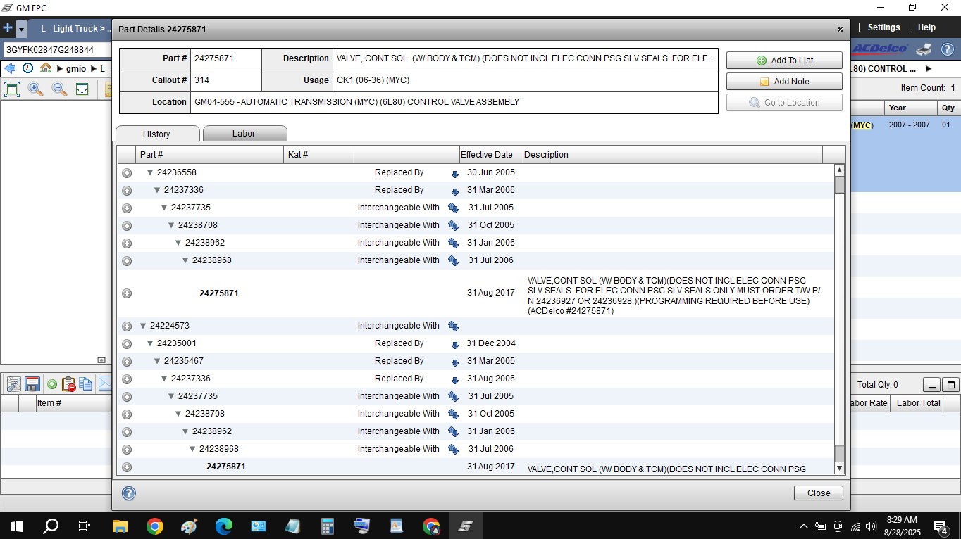

ACDELCO lists GM PART # 24275871 as the correct part. A Google search lists GM PART # 24254908 as compatible.
I have GM PART # 24254908, please can someone confirm if the OS are the same.
