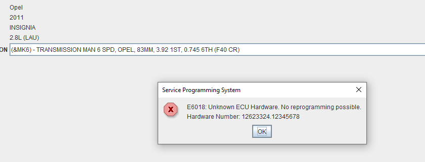

E6018 Unknown Ecu hardware
Has anyone encountered this problem?
Opel Insignia-A ECM module

  • Was it tuned before? Anyway , try flashing with DPS, as it does not check HW number against database.
