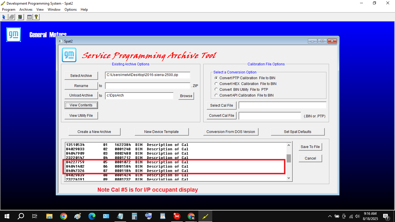

    check this 84227759 84041402 84047326

I wanted to change files 5-6-7 from my stock bcm cal to another cars cal in order to activate some features such as remote start and fog lamp control
The reason i dont use the other vehicles full bcm cal because i will be losing other functions such as windows lock and children lock

I was able to know the issue it was different OS versions you have to stick with the same OS and mix and match however you want

from sps cache of two bcm,, just replace what calibration you want and convert to dps rar file,, if you swap calibration from already converted file it will not work
