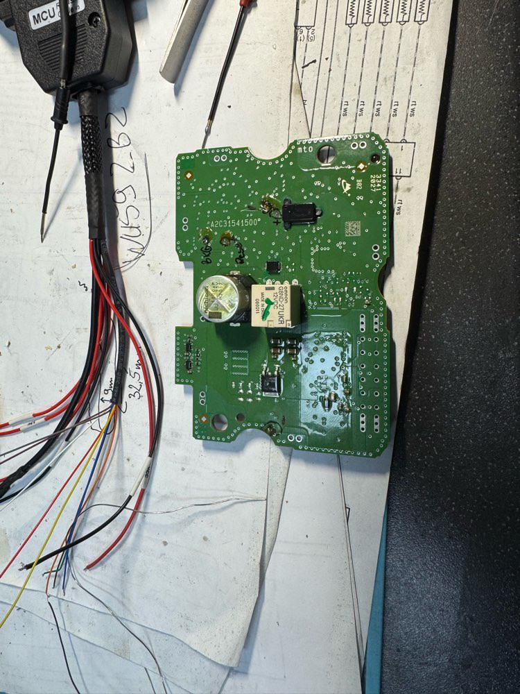

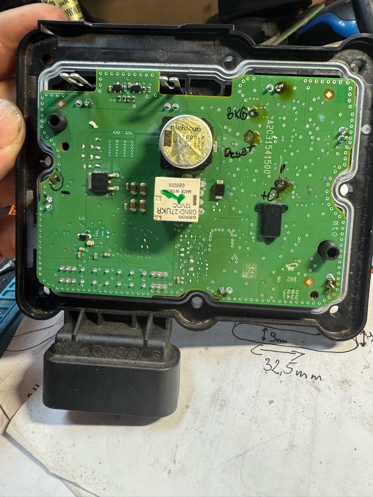

I have read 9S12G128 if some one needs file here EPB module ECUA33G 3273051 29021.10.05 HW AA SW AB (2).zip
Good for you!
But flashing over OBD2 port with DPS/SPS would have been much faster and easier 😄
I have no idea how to do with DPS
