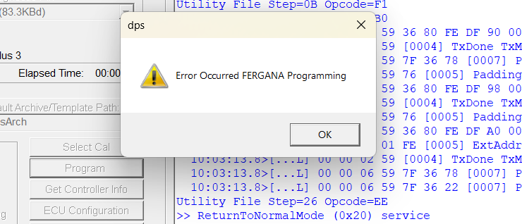

I changed Module and tried programming the Calibrations files via DPS .
But it didn't accept my request and I get a message. error
Calibrations file is attached.
APA Parking Aid.zip
I don't know where the problem . I hope you can help me fix it.
Thank you.

Can you share a DPS logs please?
ok thanks
ProgramLog.Txt
why you're using 83.3 KBPS? Try 33,3 KBPS
I try 33.3 and also 83
Same problem

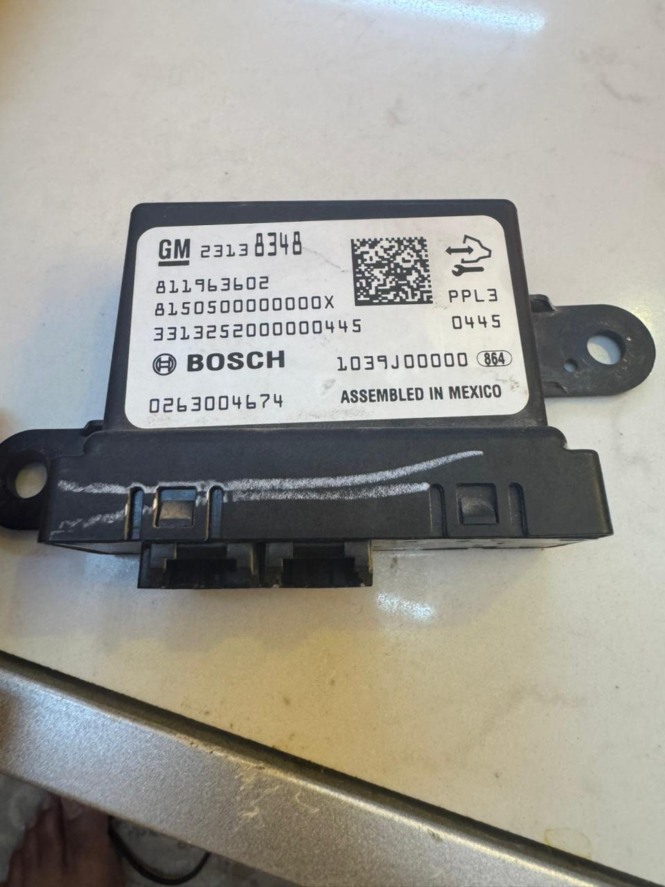

i have 2014 chevrolet silverado 1500
Parking Assist Control Module only Rear
I am currently upgrading and changing my Module to use Front and Rear.
this old module
only Rear

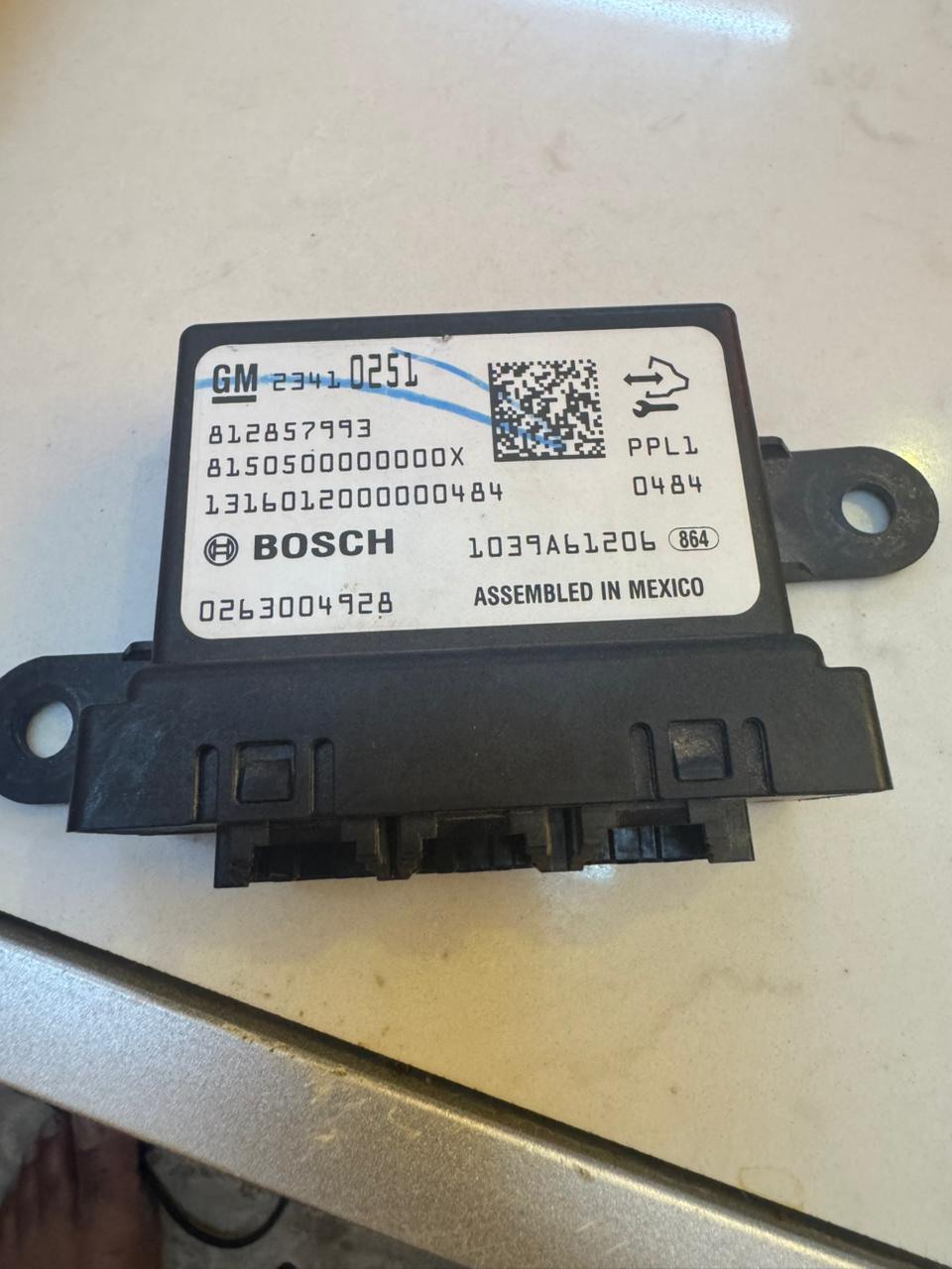

ad this Used new module
