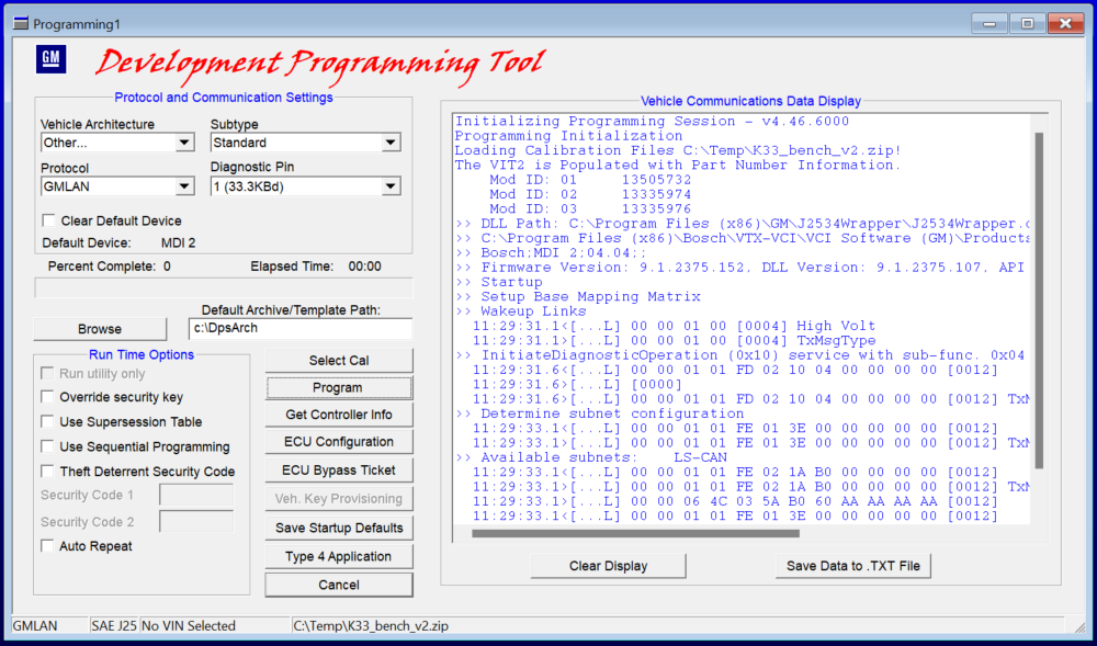

Hello, I'm having a bit of an issue working with a K33 HVAC module in bench setup.
I can connect and read module IDs, but I cannot do anything else.
Programming attempt just aborts instantly with error or asks to populate VIT2.
There are no error codes, just nothing happens.
I would like to hear some words of wisdom on how to proceed.
I have attached ECU read log and "programming" log.
K33_log.TxtProgramLog_error.Txt

Can you upload your DPS zip file? The log doesn't show enough. I see the K33_log.txt is the read and that's showing as expected. I see some failures but that's normal. The programlog_error.txt though, I'd need to test it myself, the log doesn't show anything helpful.

Your DPS build is good.... Almost more convinced you might have an issue with your DPS 4.56. I get much further than you do, yours doesn't appear to get as far as loading the pass-thru driver for some reason:
Ok, I had my doubts about this build too.. Will try with an older one.
yes DPS ARCHIVE file is good as codebuilder said
i checked with my DPS V4.56
Something strange happening..
I will try this v4.56 on another PC too, later on.
Clearly, issue is with app installation and API libraries on my end.
