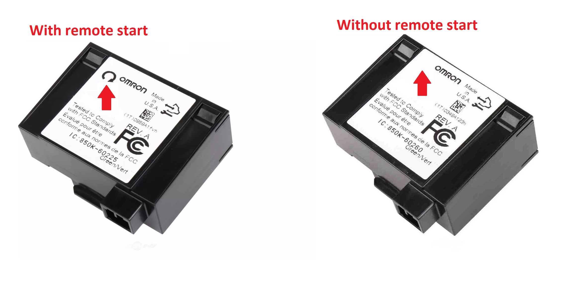

i'm pretty sure this is the part GM Part # 84922494, but would need to double check that,
also worth noting that I'm able to lock/unlock & start using the OnStar app, which tells me the components are there... only thing i'm not sure of if the remote control door lock receiver is there, but as far as i'm aware it's the same as the TPMS which is present

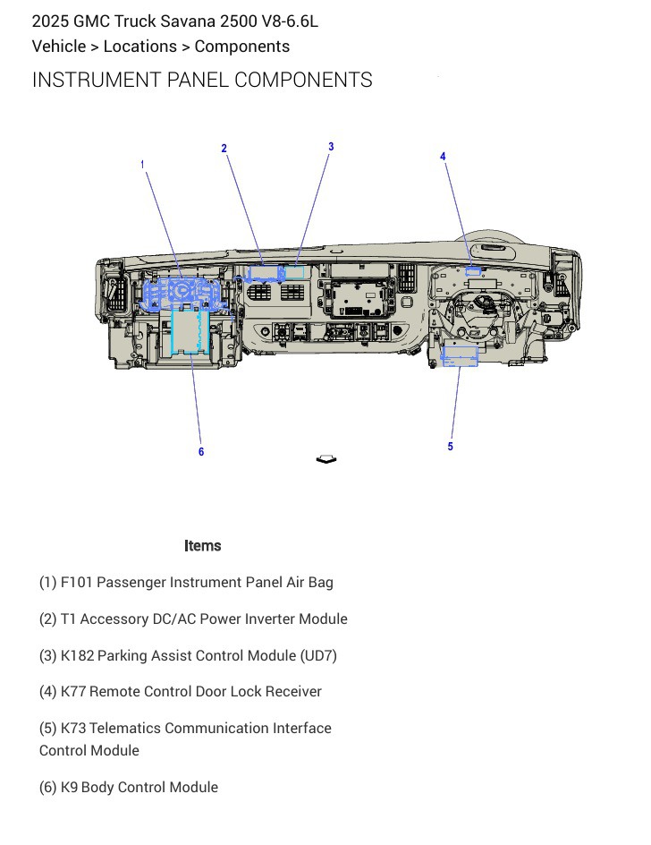

1GTW7AF77S1158820 inside story -).pdf2025 remote reciever savana .jpgremote control reciever location.jpg
i need picture of remote reciever and bcm showing part number
The system is still like the old one since 2007, everything is the same. Your RCDLR  number is 20863945 and BCM number is 84922494, which means you can program (K77 & K9 ) using the previous VIN with SPS and use a remote that operates on 315 frequencies. Then, using GDS2 or TECH2, -> RCDLR -> add the remote
