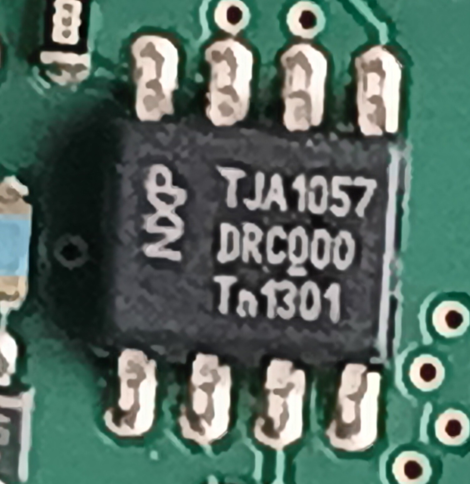

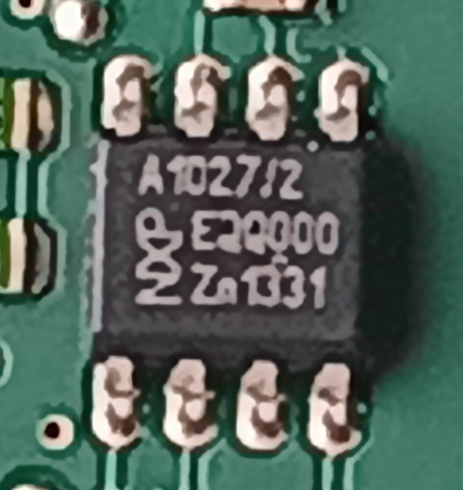

Not every SOP8 chip is a EEPROM...
And where do you seen "in-house" product codes/names? Both chips (that can be mistaken with EEPROM) are by NXP, and both have standard marking which is easily searchable on the web. TJA1057 is CAN transceiver, and A1027 is for LIN network.

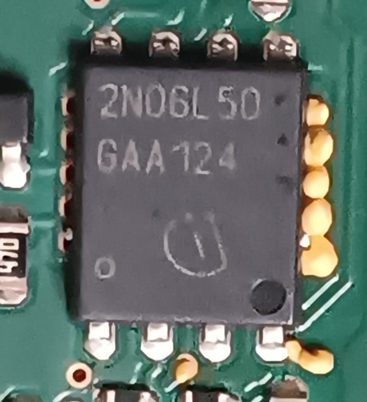

2N06L50 - OptiMOS® Power-Transistor

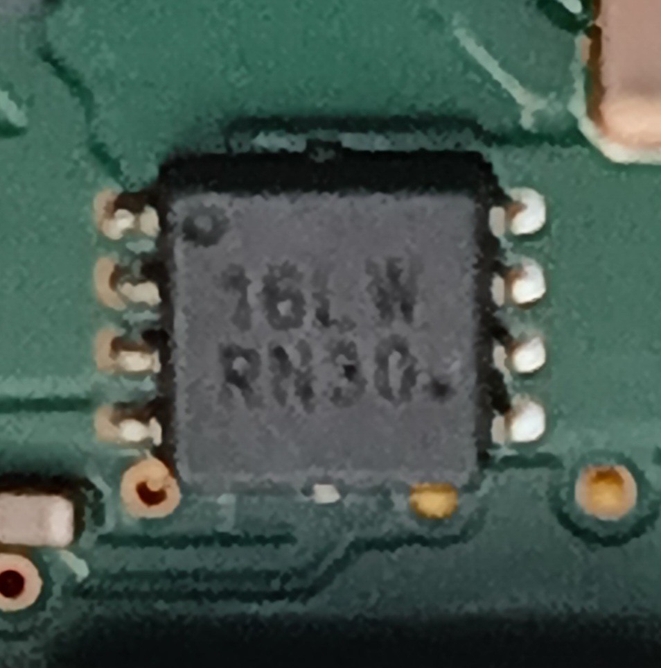

16LW - also some kind of transistor..

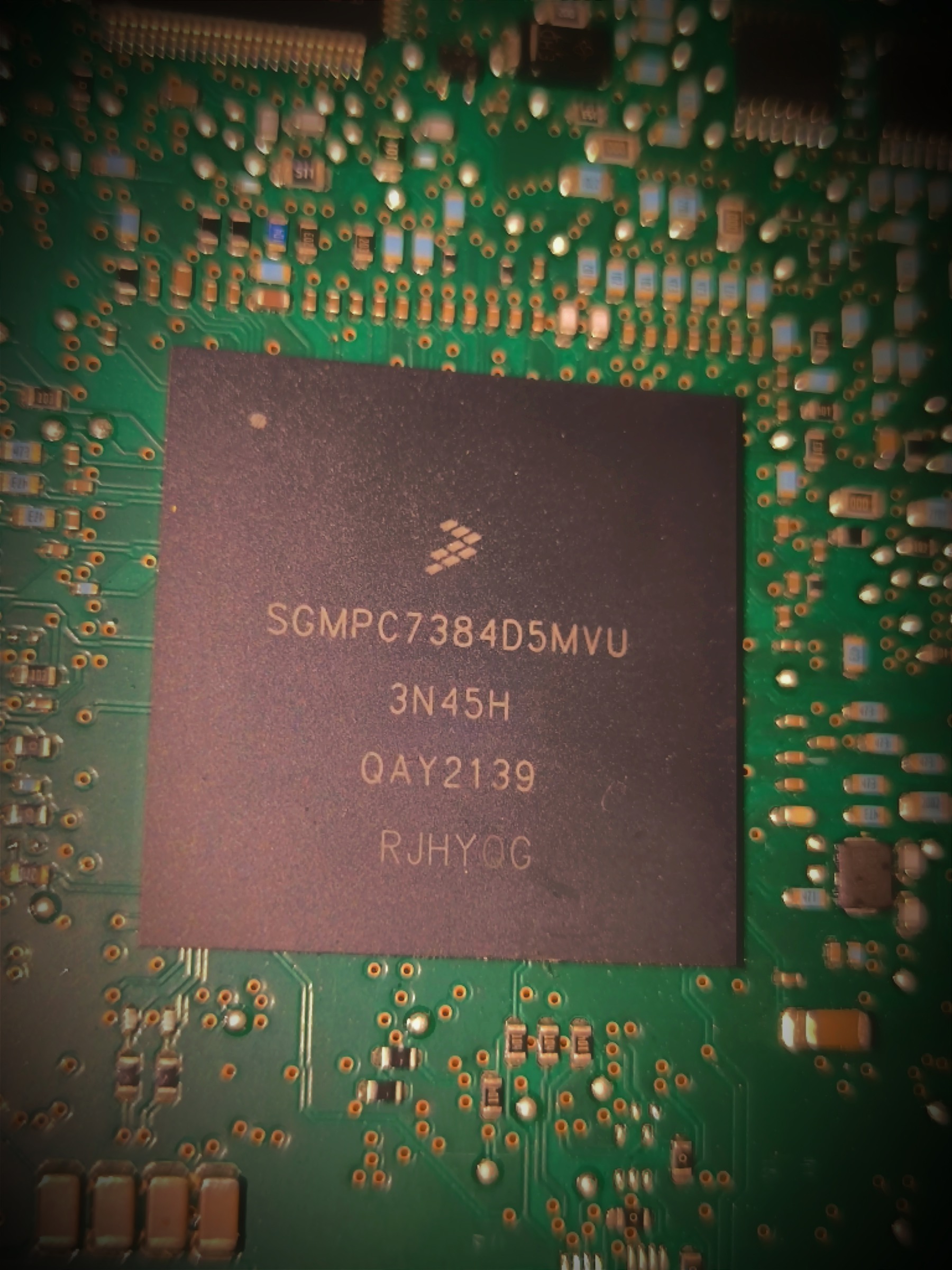

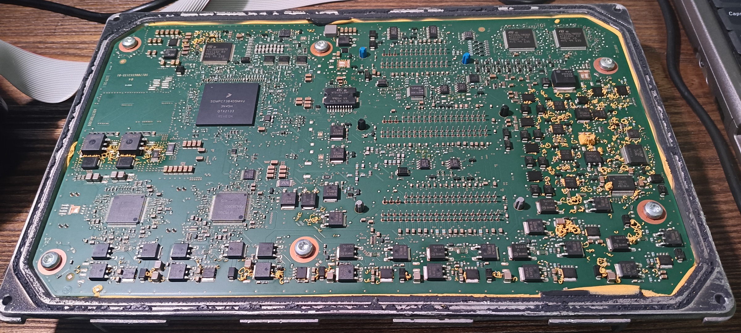

not have , EEPROM is virtually only , it is are of MCU code.

EEPROM is not external to main MCU. There is no access to eeprom as jtag, etc are locked out.
