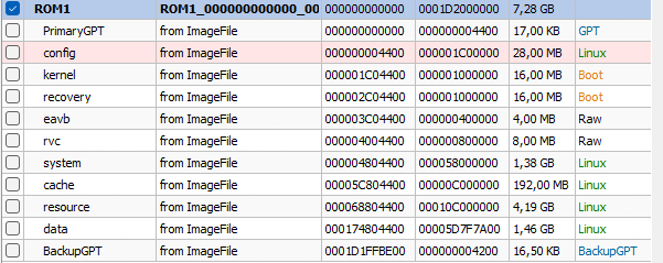

Here is a dump of all the data of the INFO3 unit.
In the GIS-646_CalDef_Database_V3.4.0_17Dec2018_MY19.zip is an explanation of what all the calibration files do.
The GIS-646_CalDef_Database_V3.4.0_17Dec2018_MY19.zip was found in the filesystem of the INFO3 unit.
The dumps can be downloaded here https://mega.nz/folder/axp0CLJJ#TCG2nNRK4rgzsyyZYKzdwA
