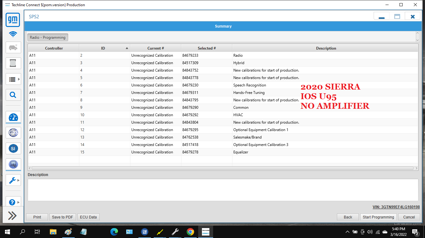

IOS (U95/UQF) NO AMPLIFIER
IOS UQA W/ AMPLIFIER
COMPARE YOUR RADIO FILE
Yes, almost the same thing calibration file numbers to me and I updated
