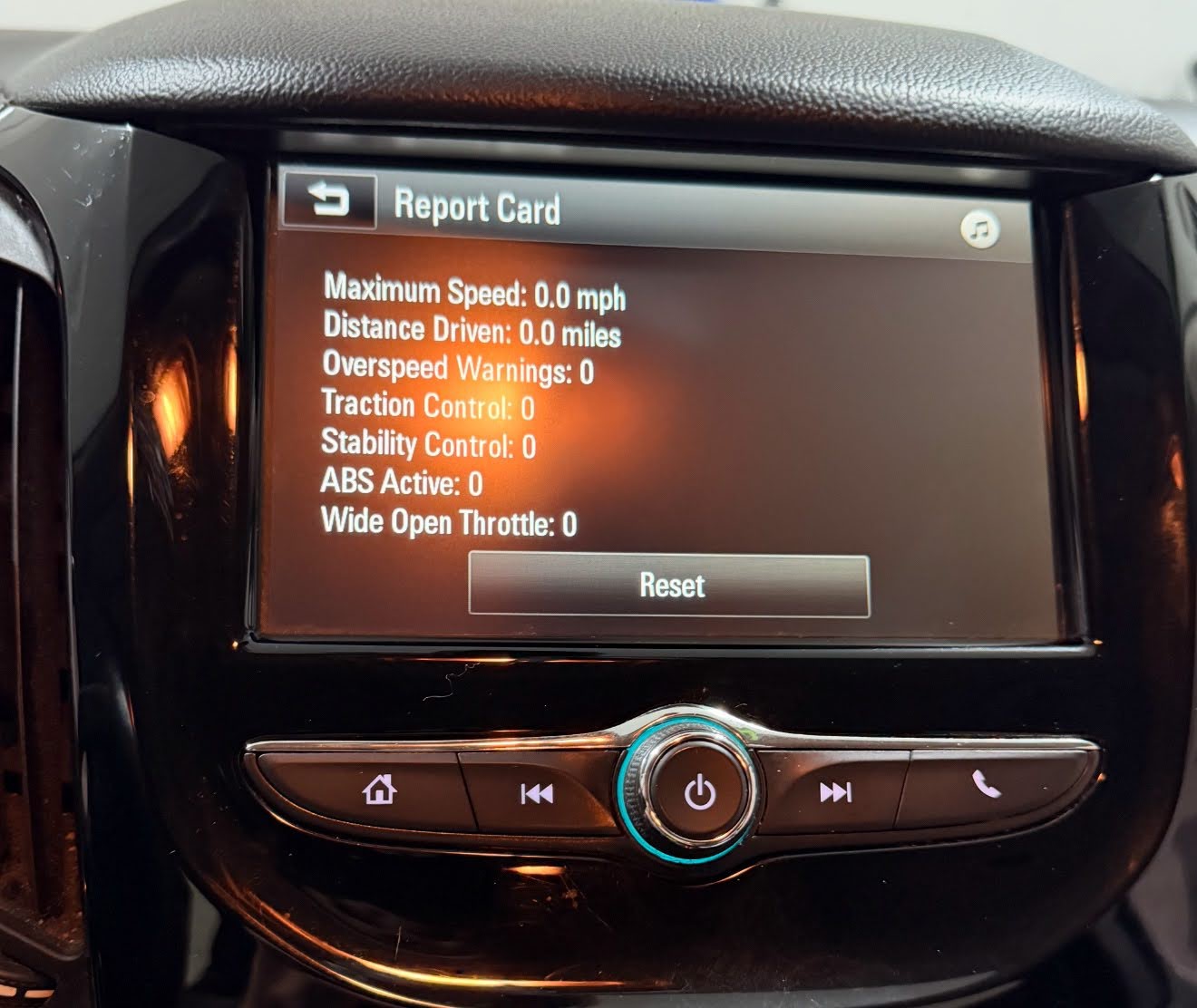

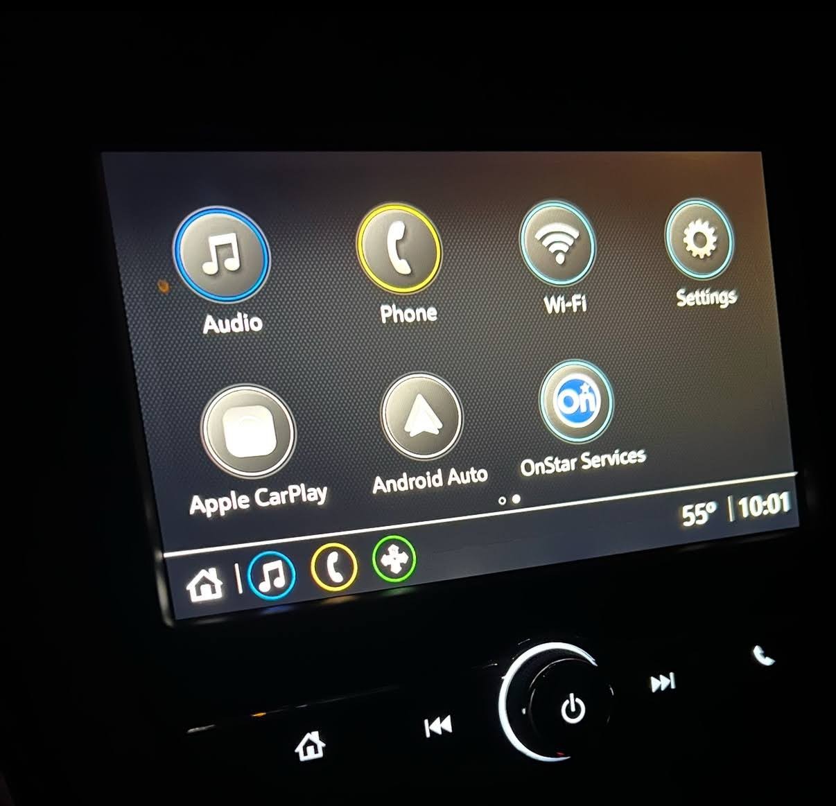

Hi, I am fitting a LG IL7FF 3.5 unit from a US 2022 Chevrolet Trailblazer into a 2017 Chevy Cruze to add wireless Carplay/Android auto into the vehicle, which only came with wired functionality. The original unit is LG LC7F which I will picture the two units so you can tell the difference. I had to convert the connections as they have changed since the 2018/2019 model year
The radio works flawlessly, beside the steering wheel control. The speech/mute buttons are mapped to the arrows that control the IPC and not to the actual buttons themselves. So when you navigate the IPC it mutes the audio or activates siri. Is there a way to correctly map the controls ? It doesn’t really make sense as the steering wheel between the two models are very similar and use identical IPC. Any help is appreciated, would really like to use this new unit

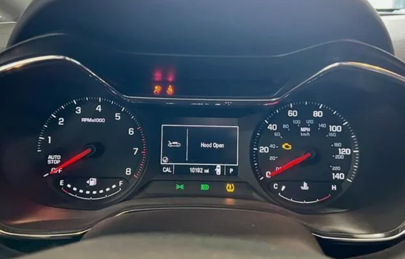

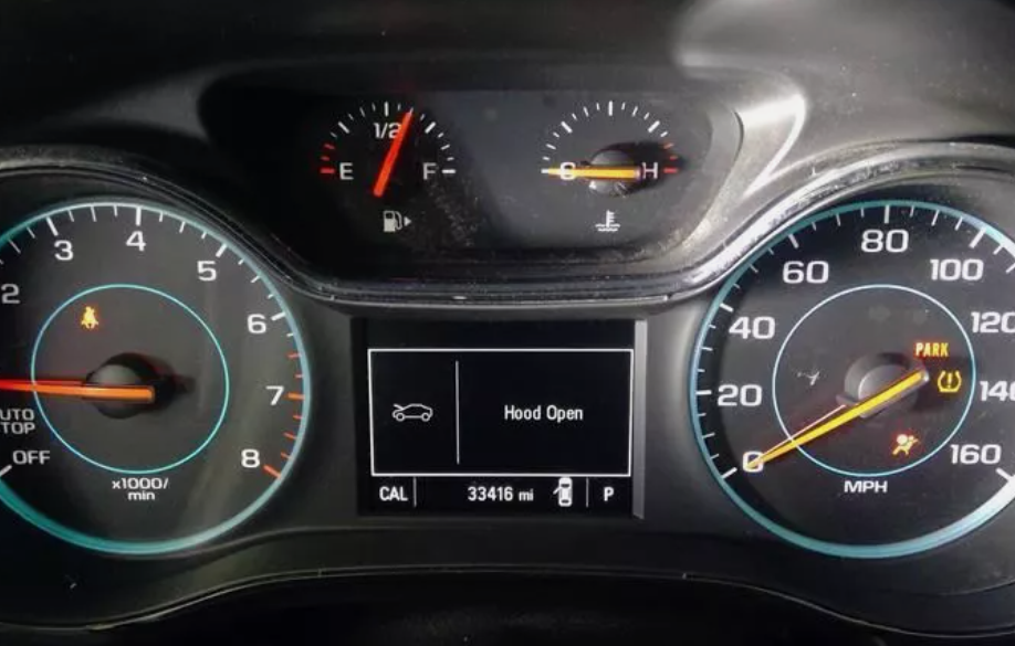

Cruze IPC

I guess I should say the cluster software is identical, but they are not the exact cluster. Maybe I can flash a calibration from a Trail Blazer onto the cruze?

I was driving a Trailblazer today. Looking further the cluster software is the same as the 17+ Malibu UDC. The Cruze uses icons for menu selection on top, while the Malibu shows it in text (trip/vehicle/eco) like the blazer. I may have better luck using a Malibu calibration but I am not sure where I can get them.

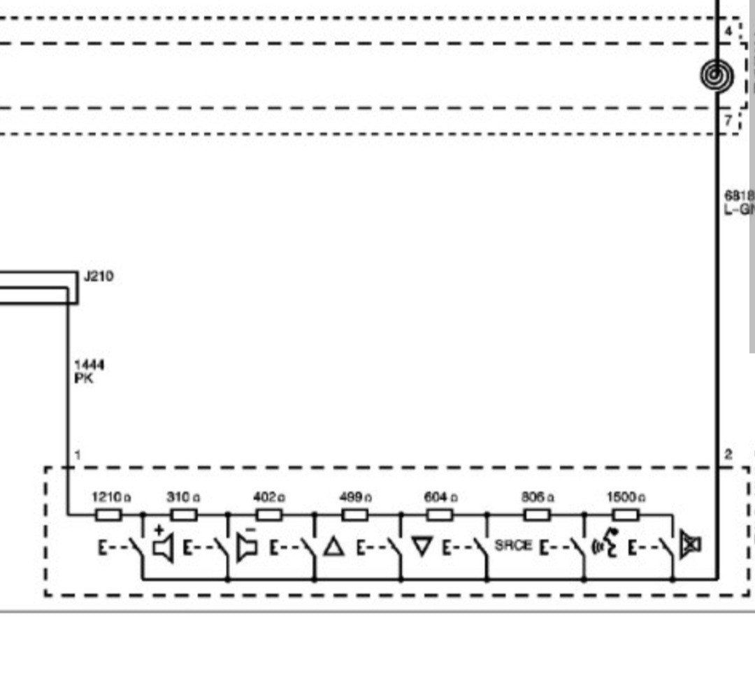

That sound like a brocken resistor later in the steering button or a storted button.
If a button is pressed to long ,tha system disable that and set a dtc
Any dtc's?

The controls work fine when the stock radio is connected..
