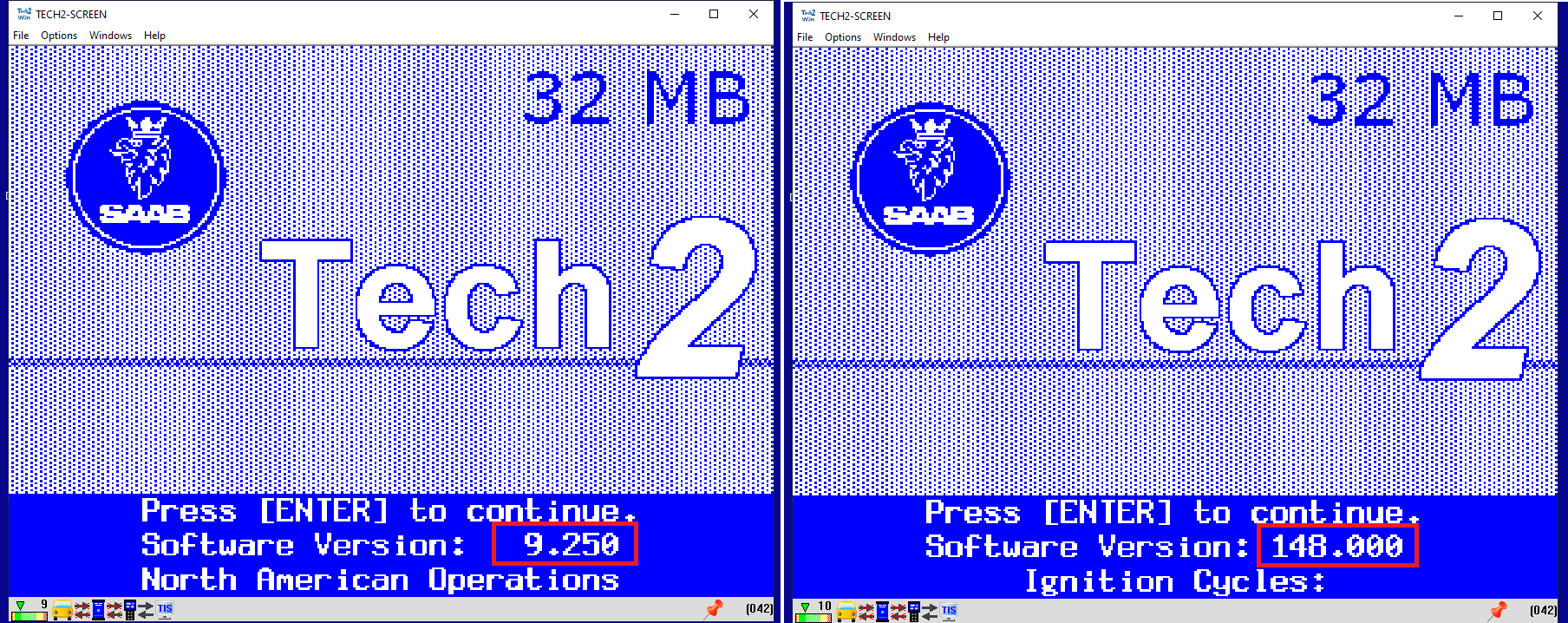

for TECH2WIN you need to use SAAB NAO card image. SAAB card works only on real TECH2.

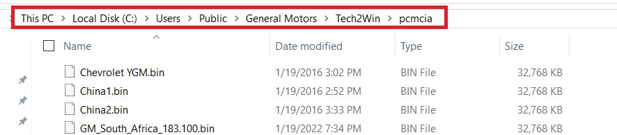

What do I use to open these bin files?
it is for  TECH2WIN software (emulator TECH2 on PC)  or for real TECH2 32MB card.

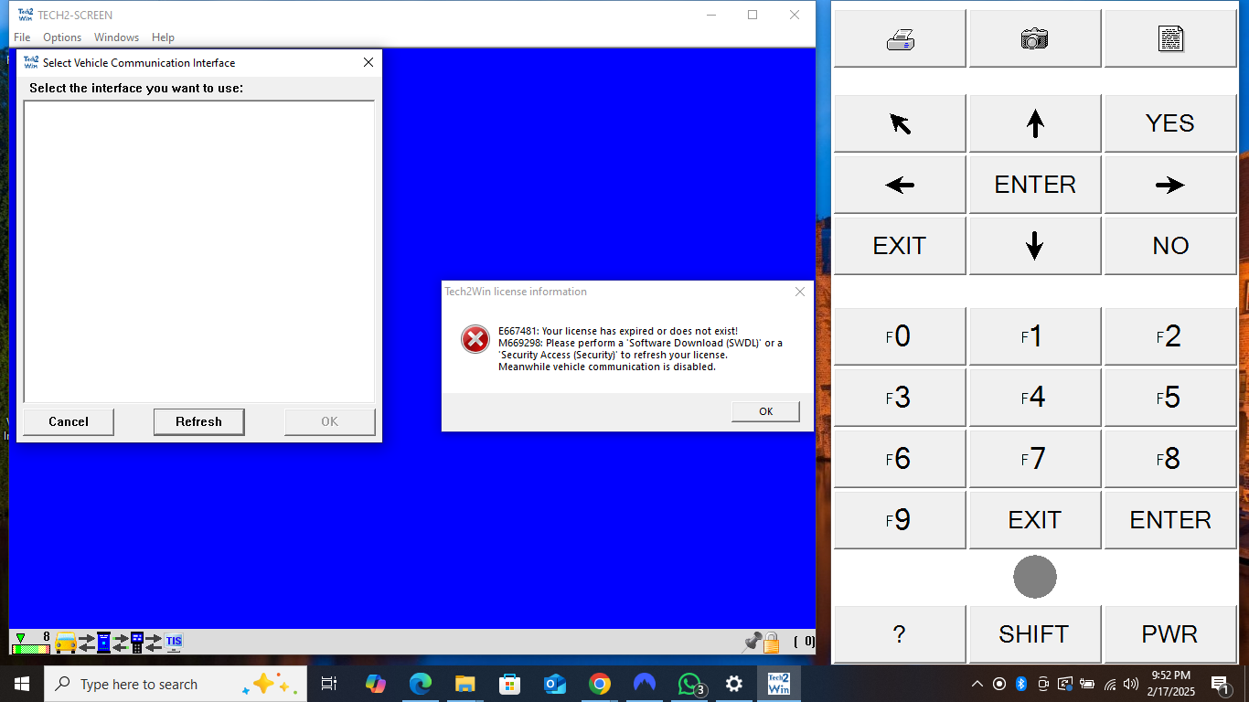

I'm getting an error when I open tech2win. I got the bin files figured out with some help. How do I bypass the license? Or don't I need to? Also, it doesn't seem to see my mdi. What do I need to do there?
I don't remember the exact sequence, but it goes something like this:
1) Launch T2W
2) Launch Global TIS
3) Need to choose "security access" icon in TIS (with Tech2 scanner picture)
4) It needs to see your active T2W session, then proceed with granting security access to this "device"
5) If everything is done correctly, T2W will restart and you will see a (1) in the lower right corner - this means that device have been granted security access for 1 day.

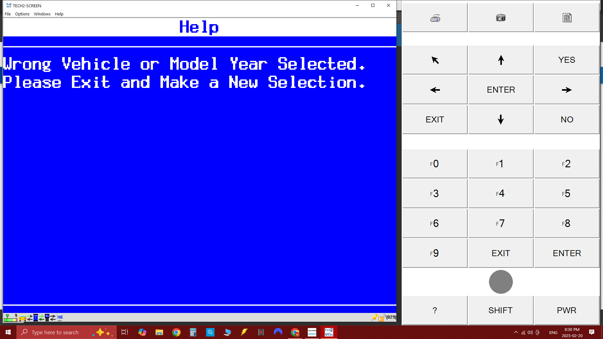

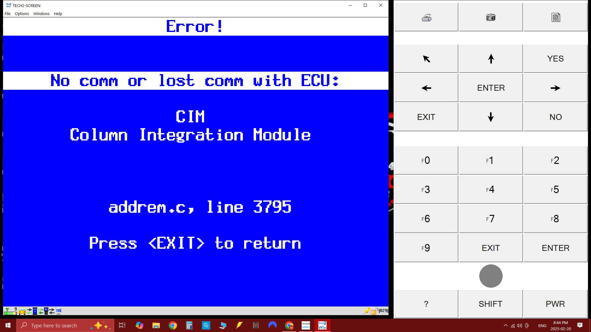

I got that far now with it. This is using an MDI2. Before it was asking me for a Candi module. Now its giving me this.
I was try several times to connect with saab 93 via tech2win, but no success. With saab 95 tech2win can connect, but with 93 i think he cant. For saab 93 sport sedan you need to have real tech2 with candi. And tis2web for saab for security acces.
if car was below year 2006, TIS2000 is completem but you need tech2,, card file can be downloaded from TIS2000.
