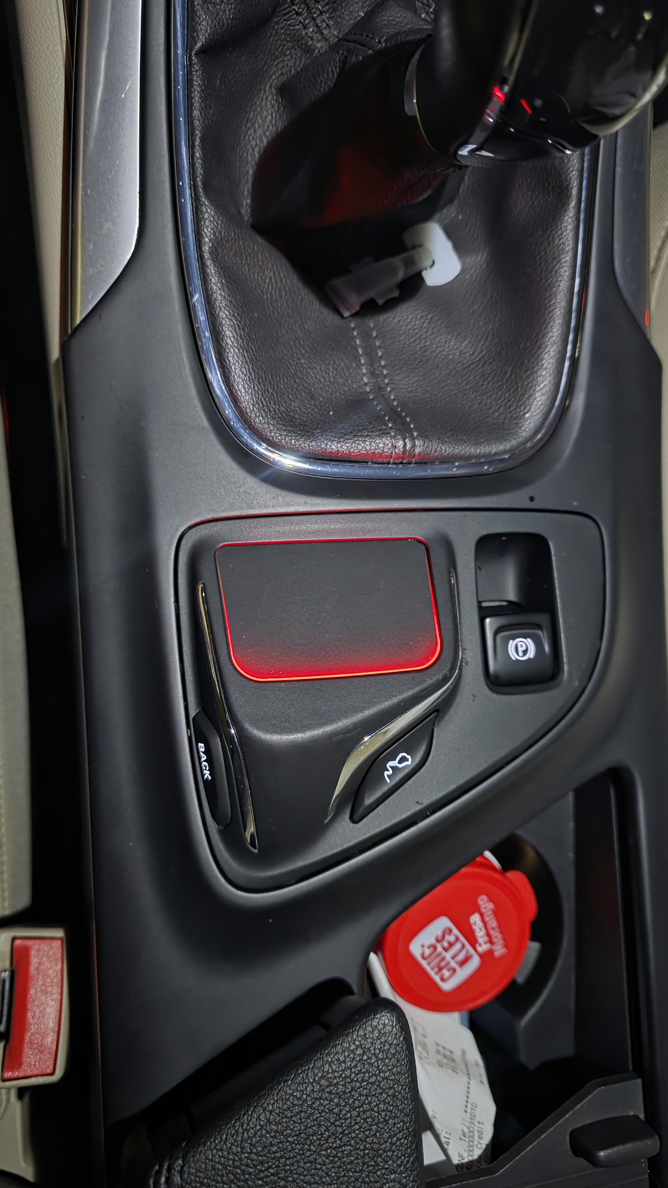

Trying to retrofit touchpad on my Insignia A FL. I have the touchpad active on my hmi, the device and some loom for it, but I don't know where the wires should go.

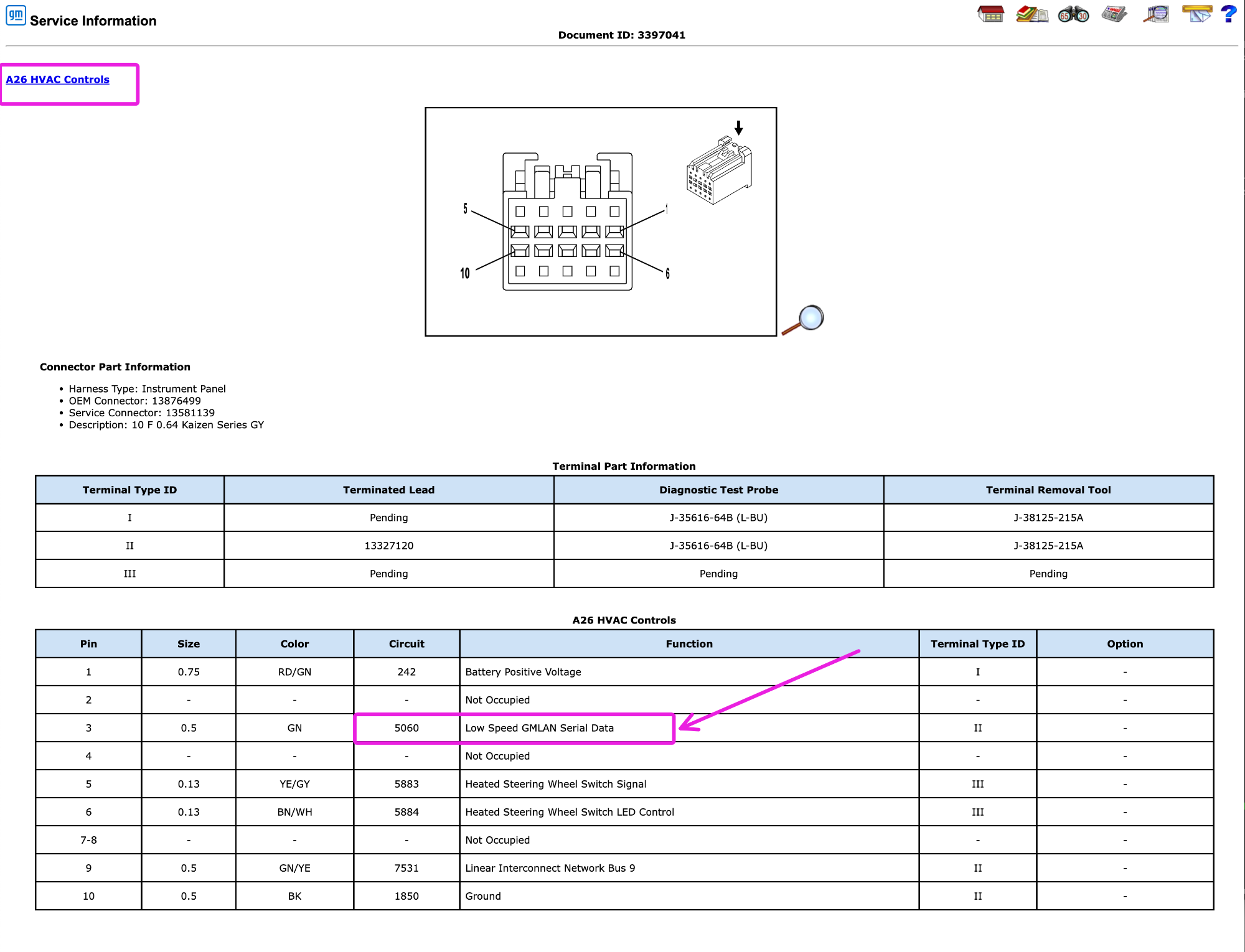

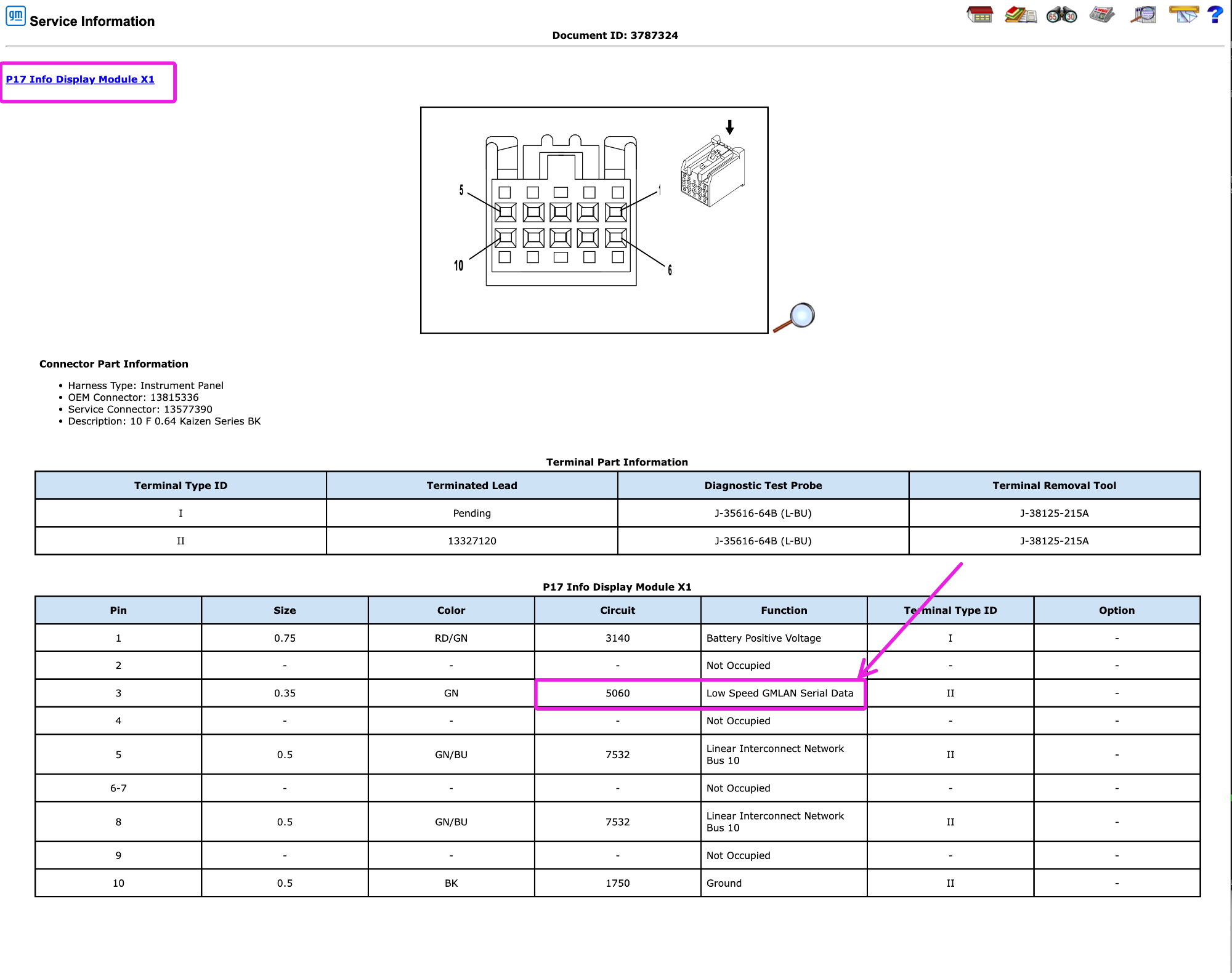

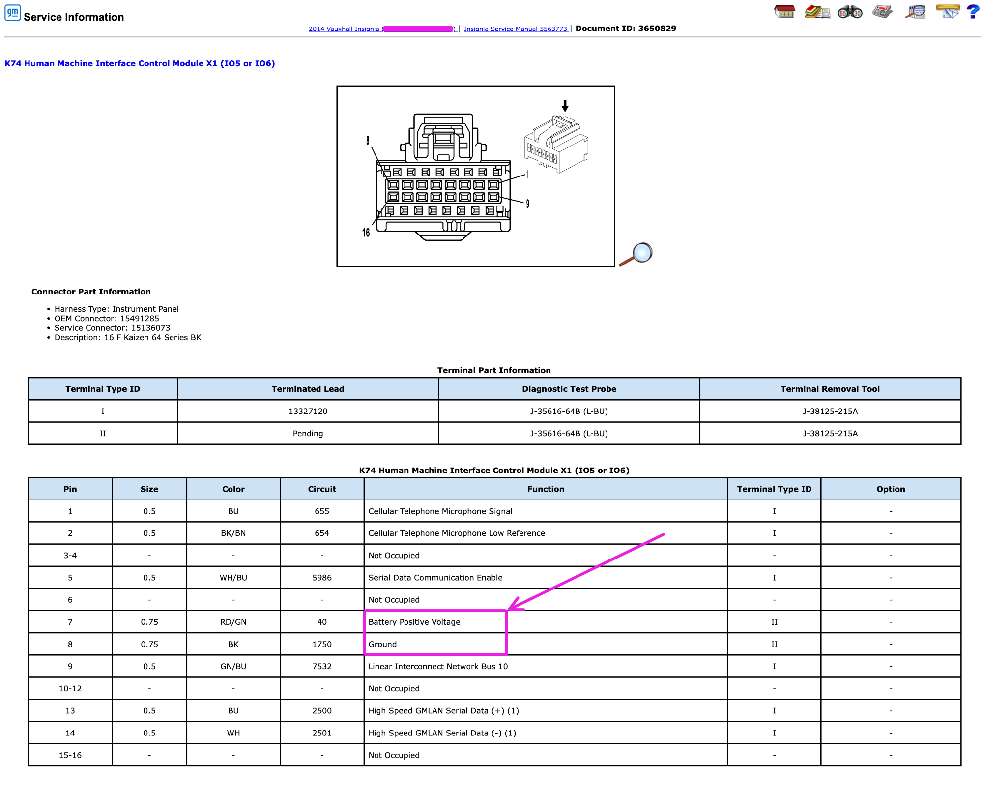

The touchpad is mainly connected to the HMI. You can tap into the HMI's battery power, ground, and MOST lines. Since the HMI does not have low-speed Canbus lines, you can tap into the low-speed Canbus lines on the HVAC or the LCD screen connector wires. I hope this helps.

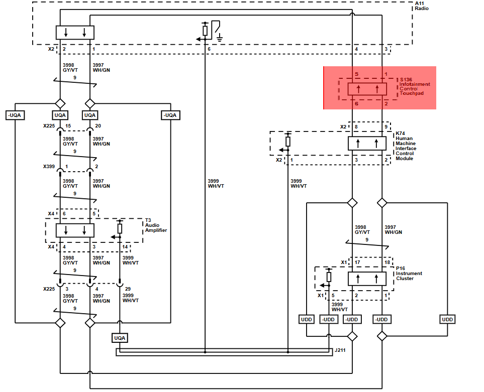

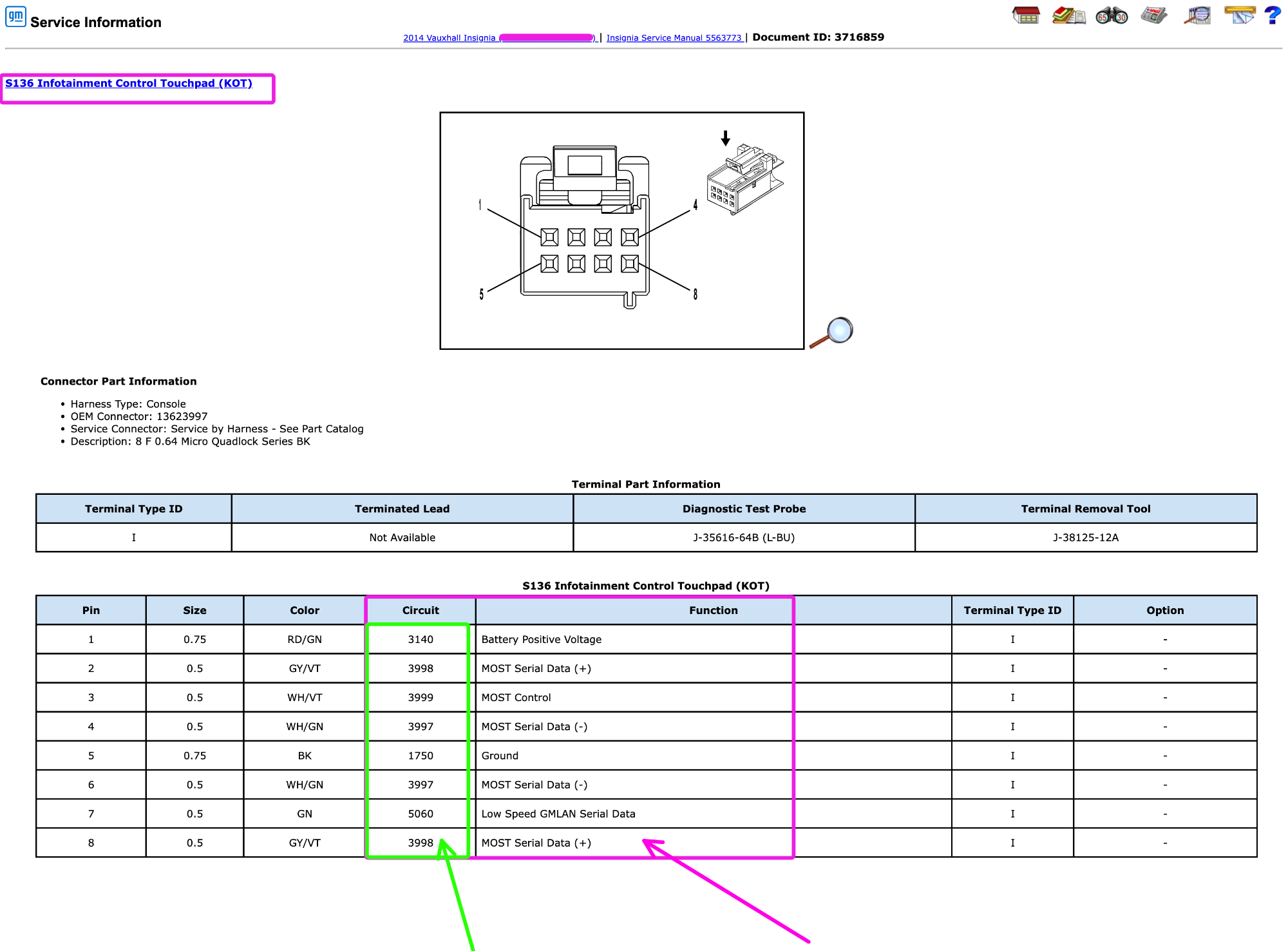

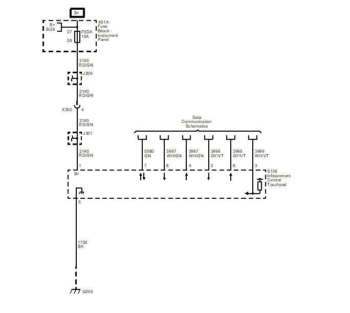

Here are the HMI, touchpad, LCD screen and HVAC schematics.
TouchPAD

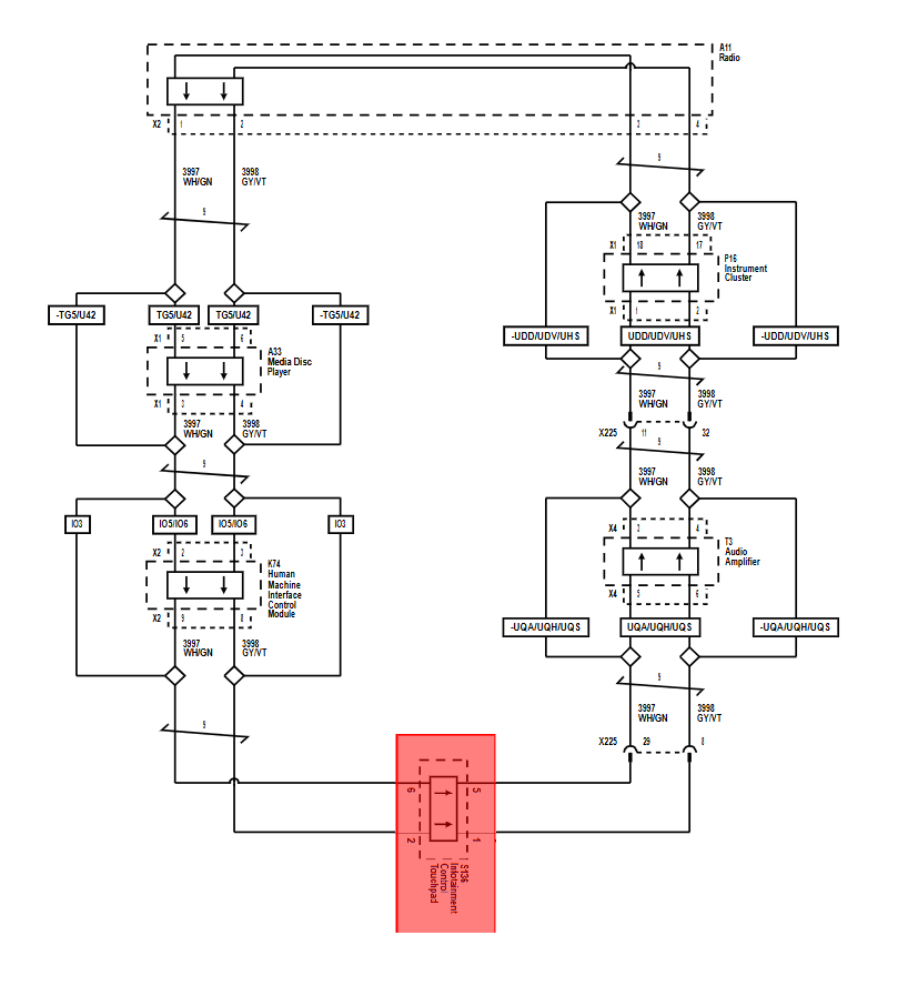

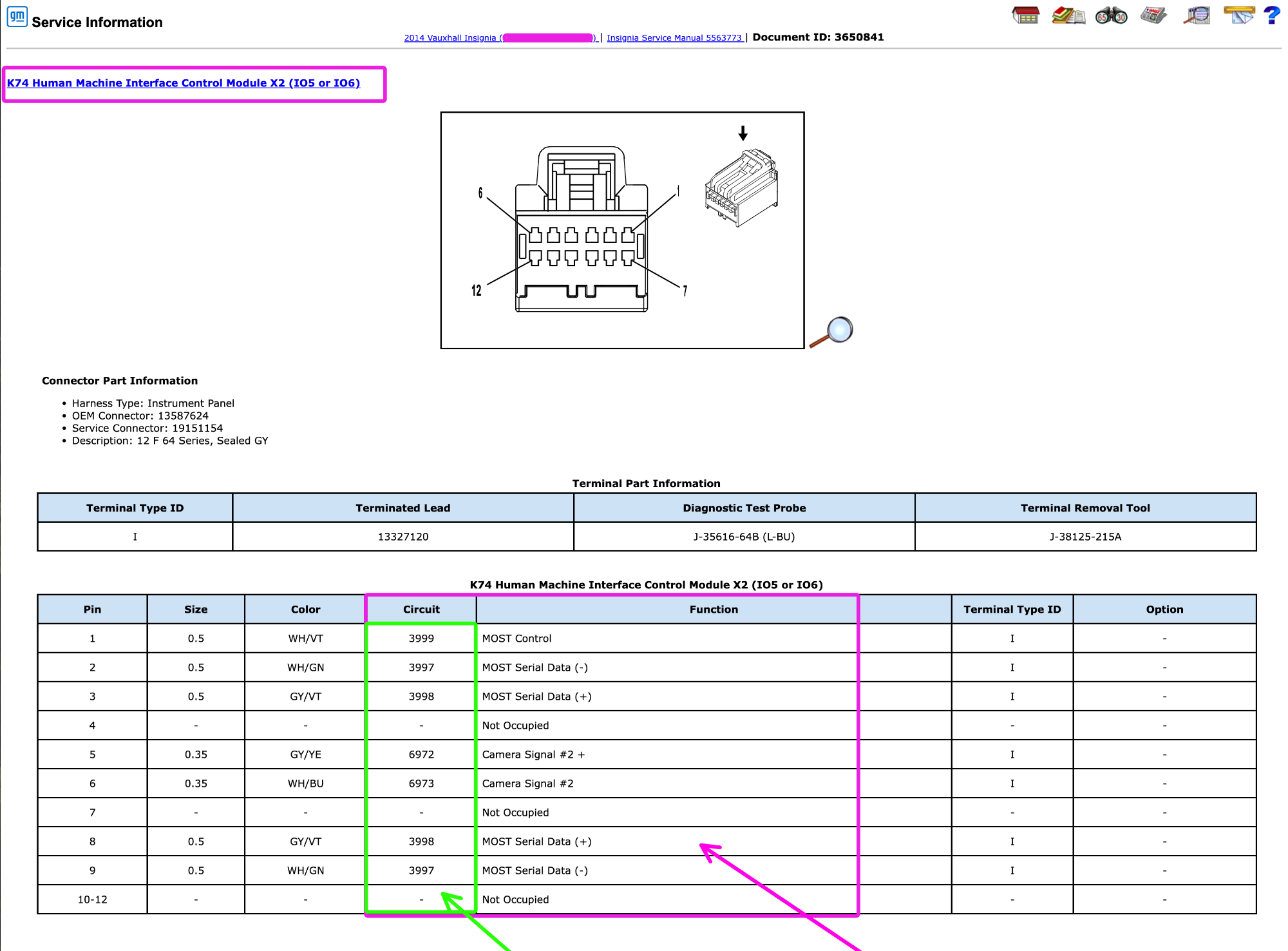

Connect the touchpad MOST lines to the HMI X2 connector wires.
Get power from the HMI X1 connector wire.

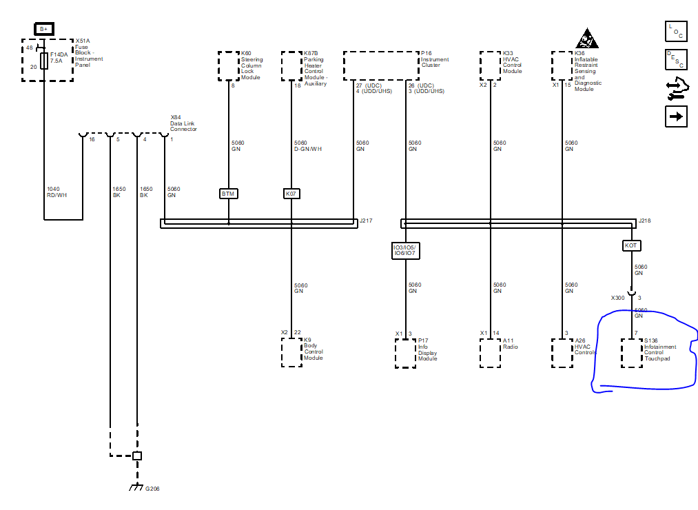

Connect the touchpad low-speed Canbus to the LCD screen or the HVAC connector wire.
Screen.
HVAC.

And GM LAN LOW Wire:

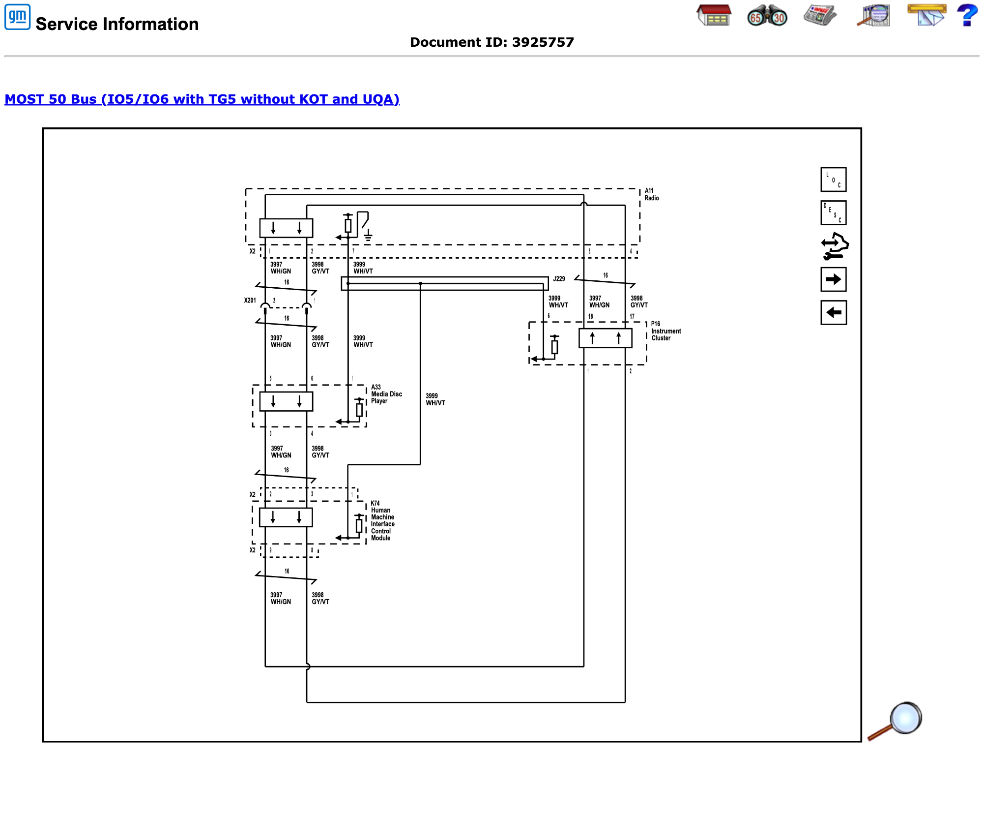

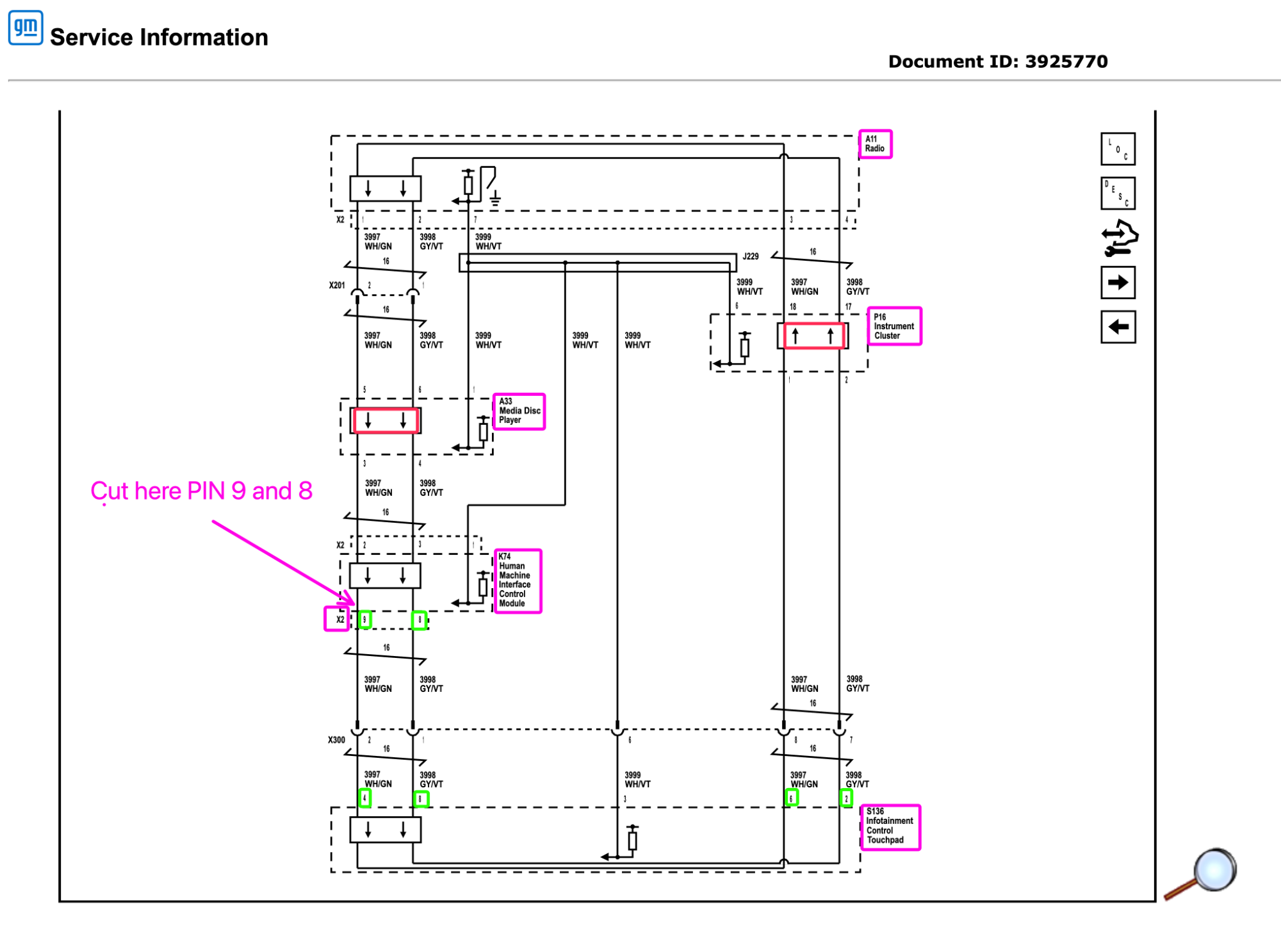

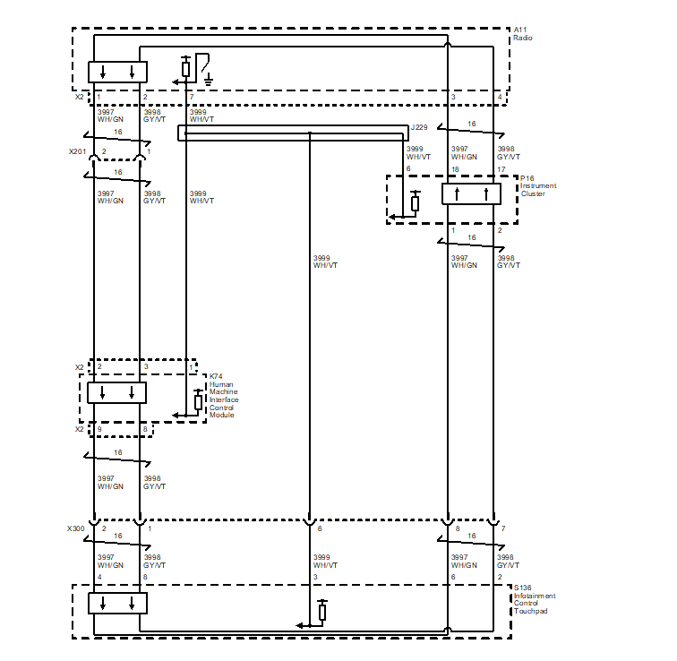

The MOST data lines work by connecting in a loop, going in one direction from one module to the next.
Cut the HMI X2 connector wires PIN 9 and 8, and connect the wire ends that are connected to the HMI X2 connector to the Touchpad PIN 4 and 8. Connect the other two cut wires to the touchpad PIN 6 and 2.
This schematic shows the MOST line with the Touchpad.
This schematic shows the MOST line without the Touchpad.
damn, didn't know that it should be in the loop. I've connected the touchpad in parallel with hmi. Thanks @Troy

After cutting the HMI X2 PIN 8 and PIN 9 wires, the HMI PIN 8 and PIN 9 wires that are attached to the HMI X2 connector plug (the plug that gets pushed into the HMI port), connect those two wires to the Touchpad's PIN 4 and PIN 8 sockets PINs.
Then, connect the other two HMI cut wires, PIN 8 and PIN 9, which are connected to the IPC, to the Touchpad's PIN 2 and PIN 6 socket PINs.
Take a look at the schematics below, with and without the Touchpad, to gain an understanding of how the Touchpad module is integrated into the circuit loop.
