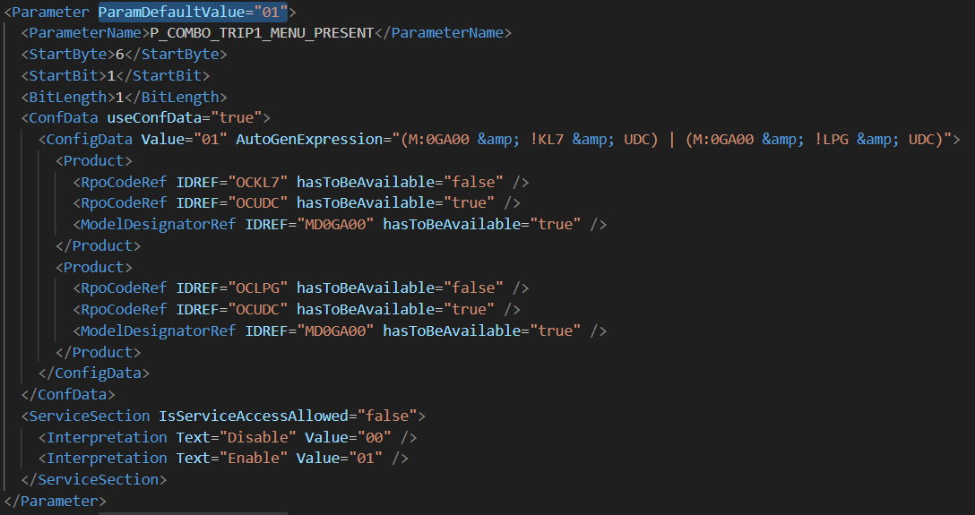

Hello. I am doing a program for editing XML files for IPC. I have a question. How to recognize by xml file where I can enable e.g. p_combo_trip1_menu_present or other options adapted for more extended IPC.

  • Based on RPO codes.. These are usually mentioned at the end section of XML file. Don't you see on the screenshot above that certain options are either true or false based on RpoCodeRef value, and al
ParamDefaultValue=
00 - Off
01 - On
I know how to turn on and off the option. I want to know how to know in the xml file that a given option can be turned on and which not. For example, I will not turn on the front and rear parking sensors in the uplevel IPC but only in the uplevel combo IPC (astra j)
Don't you see on the screenshot above that certain options are either true or false based on RpoCodeRef value, and also based on vehicle model code? XML file is pretty transparent to understand what's going on and why..
