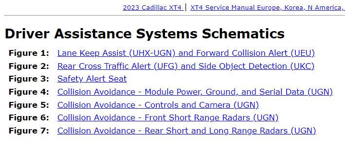

The easiest way if you want lane keep assist is to calibrate all modules related to features to add on XT4,
find XT$ same as your car model year with RPO UHX UGN UEU UEC and add all modules and wirings needed,, not just calibrations, you need to add hardwares.image.png.ad8cfcbe574906e298d0b538a7b40f98.png
